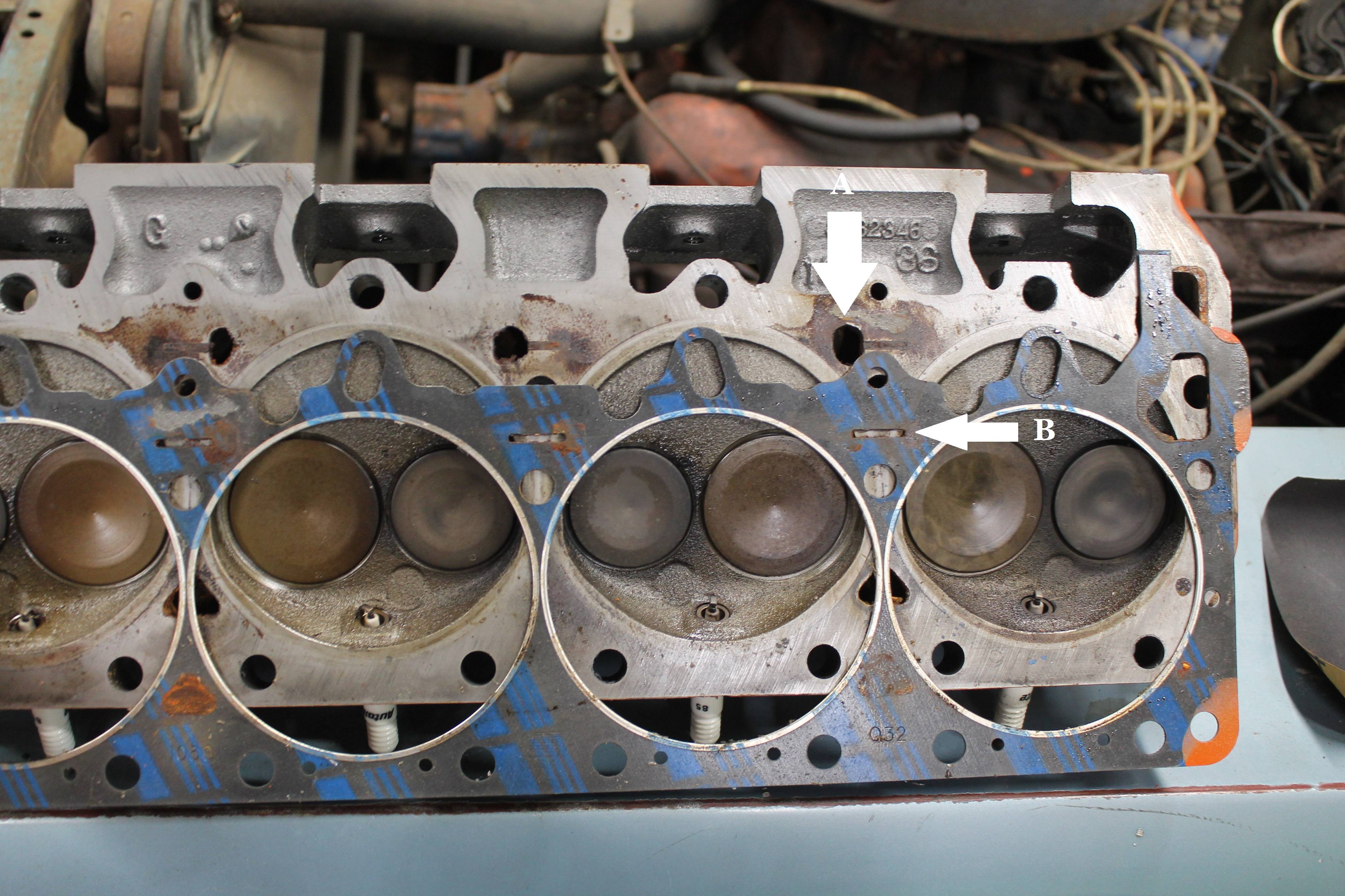

Anyway with my engine I had two problems. The overheating and a pinging problem at WOT. I fixed the pinging by setting the the timing and installing a restrictor plate in the distributor and by getting the vacuum advance set correctly. Now the reason why I am saying all of this: I had a friend come over recently to look at my engine. One of the things he looked at was the head gasket. The head gasket I use it Fel-Pro part number 1039. I picked it because I had mistakenly thought that my compression ratio was higher than it actually was and I wanted the thickest head gasket I could find to help with the pinging problem. He noticed that there is a slit in the head gasket that covers where the coolant flows. He was wondering about this and now I am too. This slit would seem to restrict the flow of coolant. Does anyone know if this matters or not? Is it possible that at idle the slit just doesn't allow enough coolant to flow through the engine? I have included a picture. "A" is the factory hole that flows the coolant and "B" is the slit on the headgasket that covers it. Is it possible that I have used the incorrect head gasket all along?

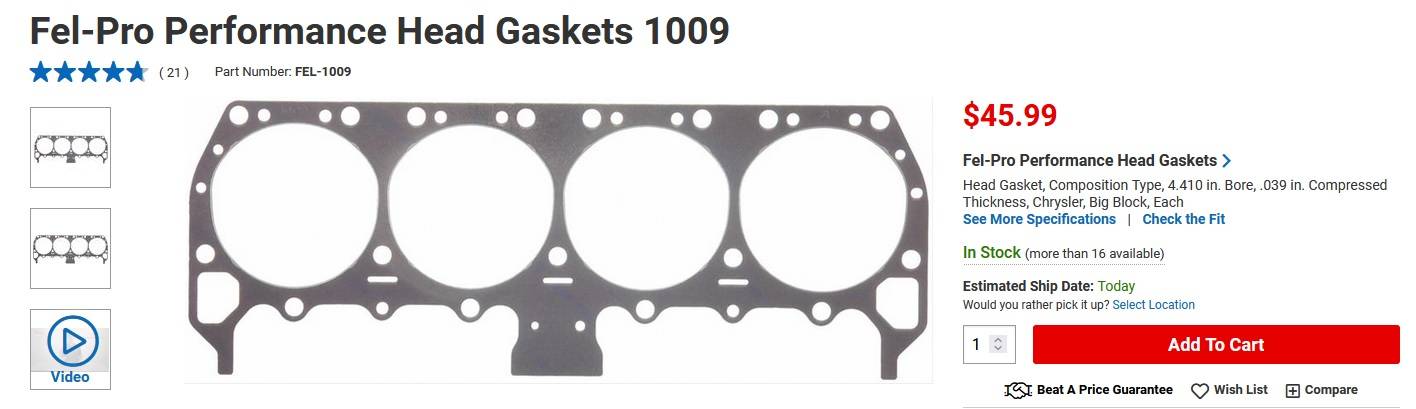

This is a different Fel-Pro head gasket. While it does have the slits where mine does the other holes for the coolant next to the head bolts on the exhaust side seem larger.

I think you are Ok. The slits are designed to limit water flow but still line up if the holes in the heads are in different places.
There main job is to allow steam pockets to disperse.
One of few
Jun 23, 2022
102
77
Michigan
Bingo - allowing full flow will cool much better. I’ve seen this problem before - if both engines have the same symptom, I believe you’ve found the root cause.
