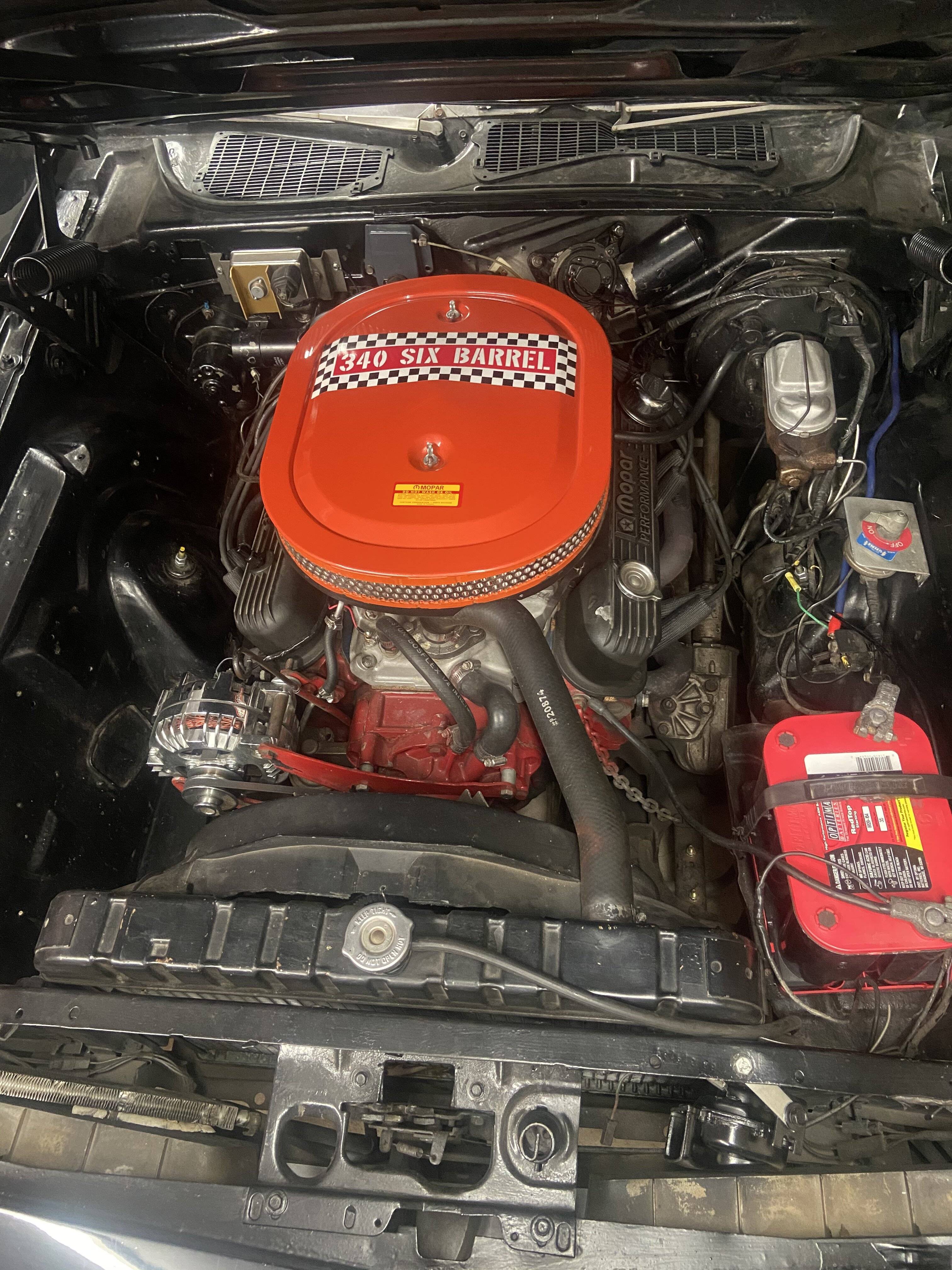

Hello my name is Russ I am new to this site back in June I purchased a 1973BS Cuda it is all numbers matching spent all of its life in Charlotte North Carolina it has a 340 6 barrel and I’m looking to build it around 450-500 horse pump gas looking for a very knowledgeable engine builder that can help me with these equations of matching parts if there’s anyone out there that can help me I would definitely appreciate it when I was a teenager I had a road runner and a barracuda And many other cars are used to race the Road Runner a lot I’m used to a 440 and I may switch it out for 440 if I can’t get the torque out of it without hitting the moon on RPMs can somebody please help.

Welcome to the site from Michigan!
Show us more pictures of your Cuda.
