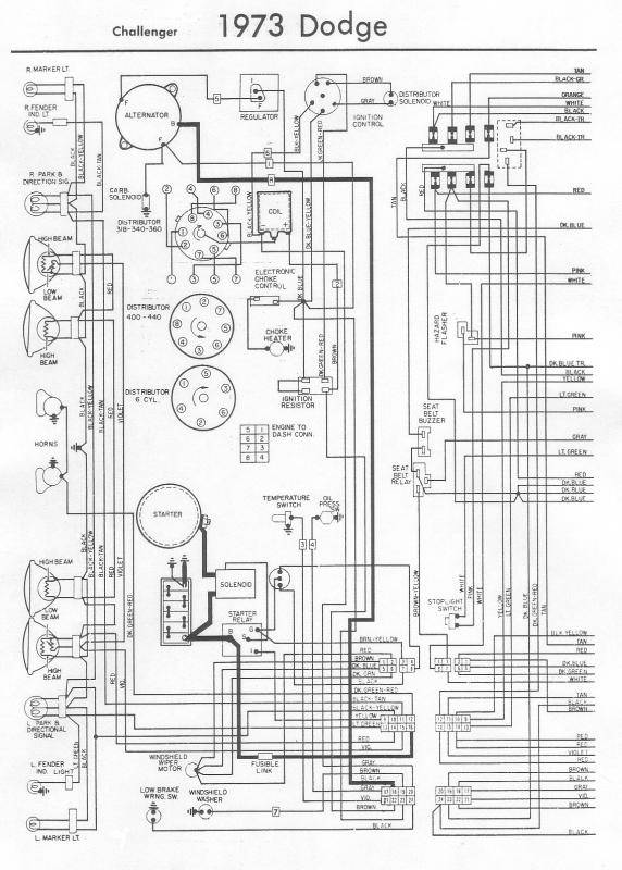

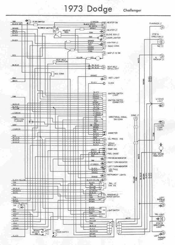

anyone know what powers the 2 orange wires on the ignition switch connector? Red is good powering all ,just cant trace how the orange are powered. thanks
Orange is powered from the dash light switch , it goes into the dimmer switch & powers the dash lighting from there
74 is slightly different than 73, but not enough to matter for what you are doing.

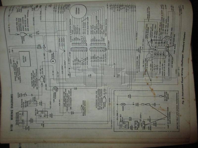

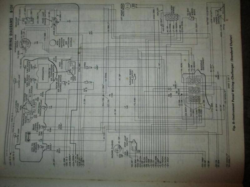

Site won't let me edit the last post. I don't have a digital copy of the cluster diagram. I can't put my old book on the bed scanner without hurting the binding. Here are some pics. Hope they will work for you. I left the pics large so that you could read them.
