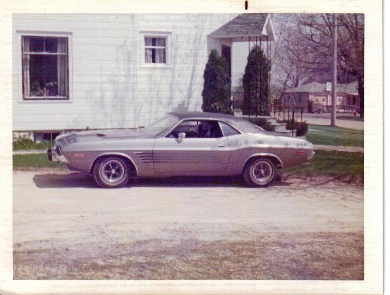

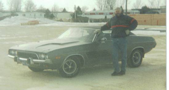

1973 infront of my grandparents house

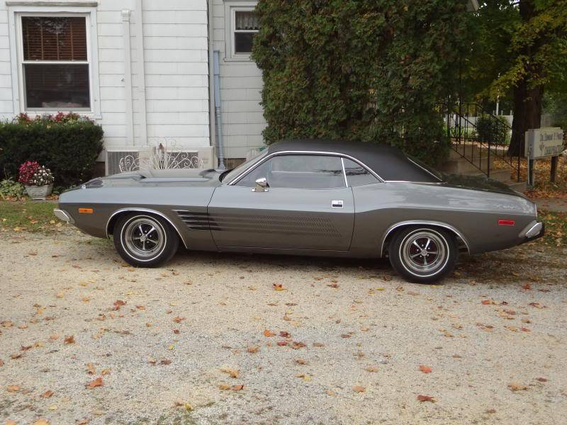

2013 in the same spot
Tried to age the picture...

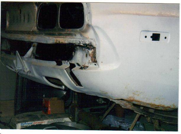

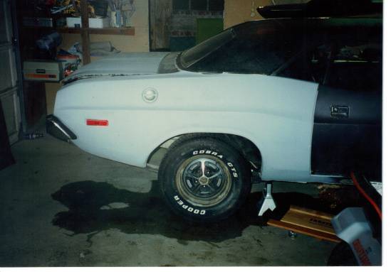

Long Iowa winters had taken there tole on the body. It was easy to see that the quarters were junk as well as the front fenders. The car had been repainted at least once in its lifetime and it looked as if there was a good deal of bondo in the trunk lid as well. It didn't sit flush with the quarters.
In 95 I went around to a few bodyshops to get some estimates on body work. The few shops I went to basically just laughed at me and said they weren't interested. I found a shop that was willing to put quarters on the car and fix some rust in the trunk. It was only after the car was at the shop that I found out they did really bad work. What was supposed to be a 3 month job turned out to be 2 years. When I got the car back, I understood what everyone was talking about.

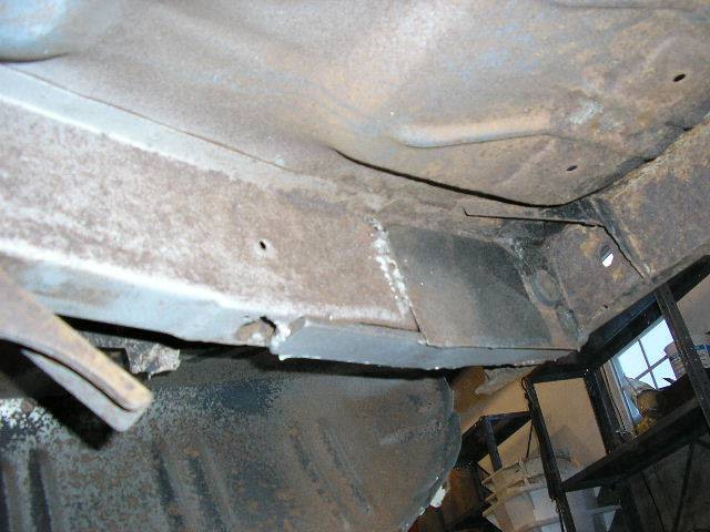

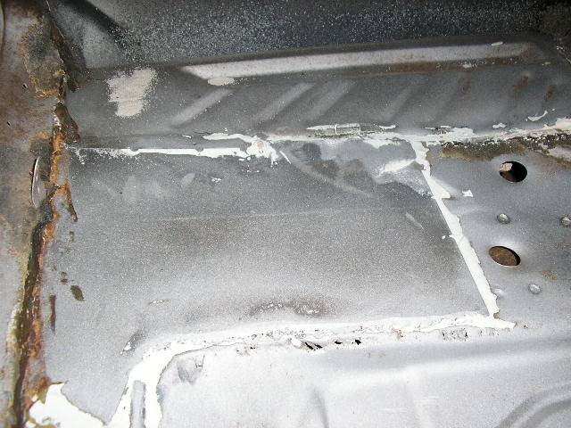

There was bondo everywhere. A lot of the rust was just bondoed over and it was up to a half inch in places. The quarters were hung very poorly and the rust in the rocker area wasn't addressed before hand. I wasn't even told that there was rust in that area. The used rear valance I had purchased for the car had some minor damage that would need fixing. The valance was just tack welded to the quarters and the seam was bondoed over. Big steel plates were slapped onto the sides of the frame instead of being fixed and large sheet metal patches were placed on the trunk floor and tacked in place. Everything that the shop did would have to be replaced. Here's some pics of there work.
