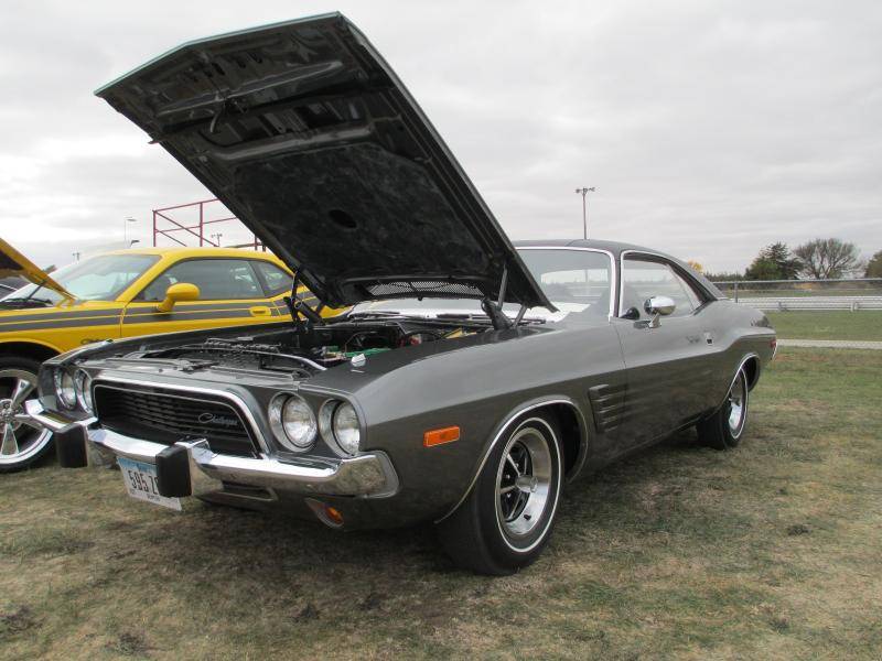

075.jpg074.jpg073.jpg076.jpgI hope you don't mind. Here's a few photos from the Mopar Max meet at Cedar Falls raceway this weekend. Your Challenger was flawless! Congratulations on a job well done! (or almost done) lol toolmanmike
I don't mind at all Mike. The pics I took are basically the same. I had a good time and met some new people. Man was it cold though.

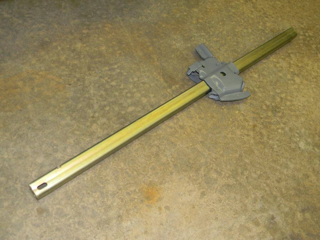

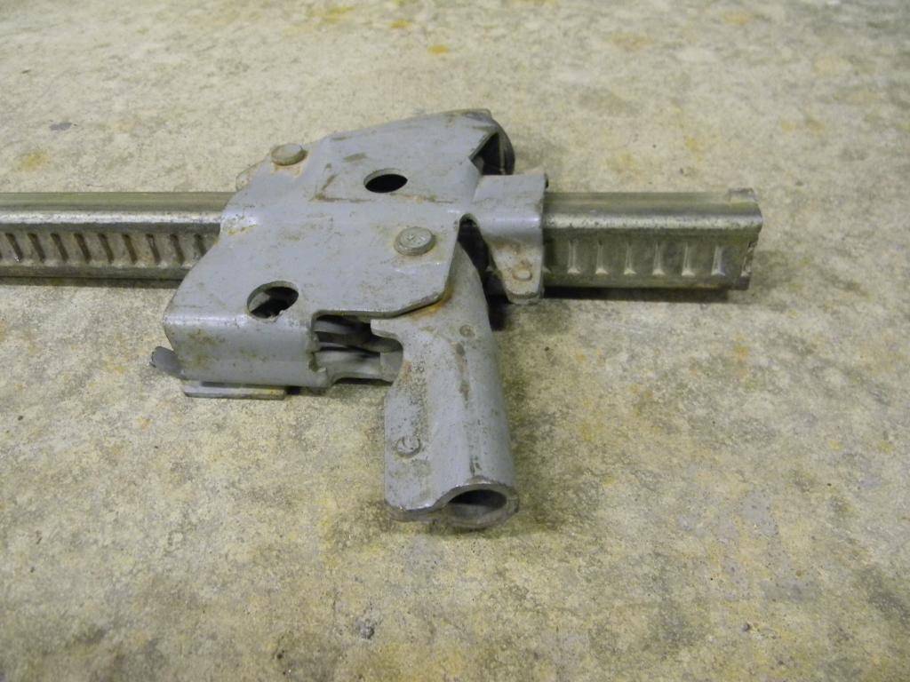

Last night I finished up the jack mechanism. The original jack wasn't in horrible shape so it didn't need much work. I was able to spread the mechanism enough to remove it from the mast. I soaked it in EvapoRust to get rid of the small amount of rust that was on it. Then I resprayed it gray. The mast was put in acid which stripped the original plating off and derusted the ends. Finally, I sent it to the platers for a fresh coating of zinc dichromate.

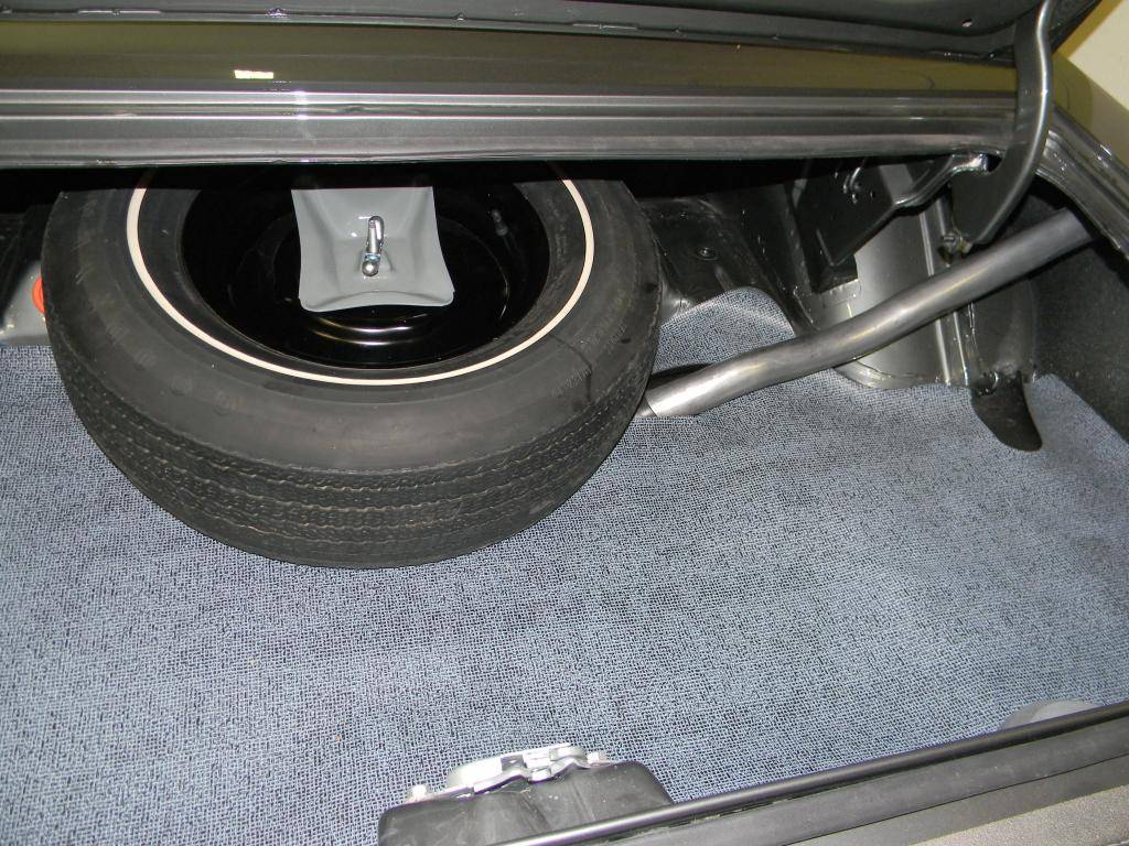

The trunk is just about done. I still need to clean up some of the weatherstripping adhesive around the trunk seal. I also need to replace the trunk lock that was damaged at the bodyshop back in the 90's. The original spare tire looks right at home...

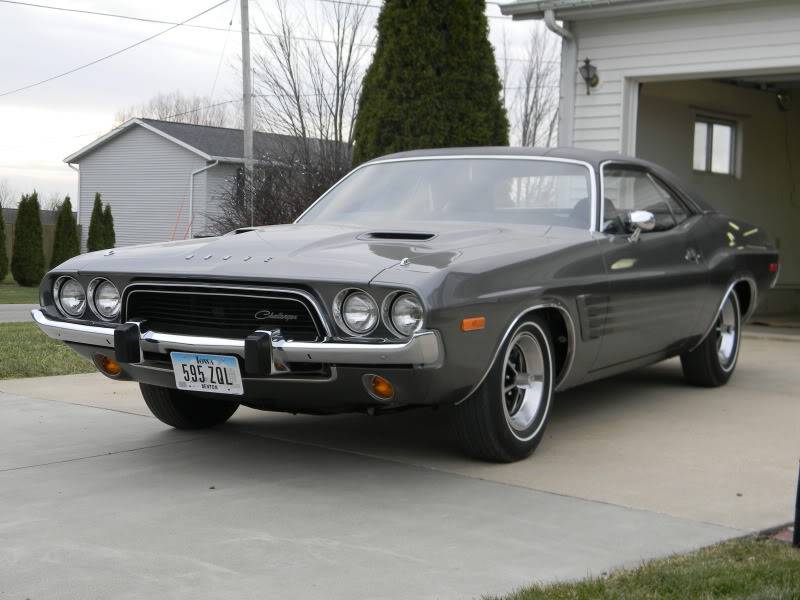

A buddy and I went for a drive today and took some pictures. Here are my favorites...

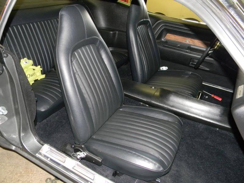

Last month I took the seats back out and had them recovered. No more crushed velvet...
