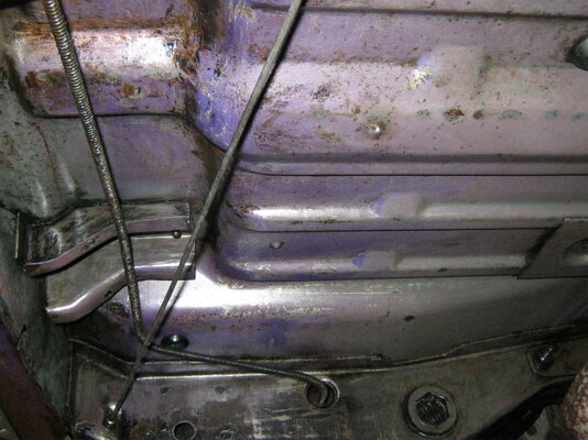

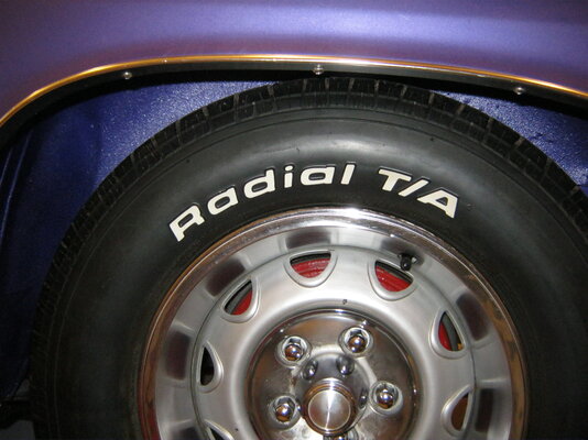

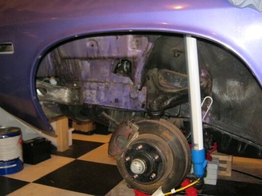

It's called VLP. very little paint. undercoating was on the under side of floor boards if it was ordered,fr usually the front frame rail area and apron. they applied it as if they didn't care. When I used a torpedo heater to remove the the factory undercoating sound deaden-er. There was no primer of any kind or paint.There was only bright metal. 1st 2 pictures show what I have seen for undercoating.3rd is what I decide what to do and top coat with KBS. It's you preference.
