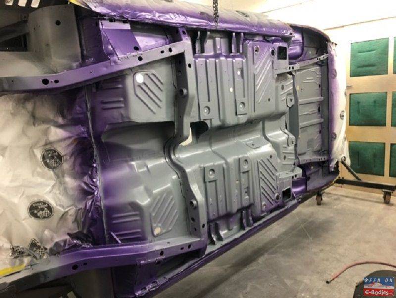

I did mine with grey epoxy primer & oversprayed the purple to look like factory but obviously the epoxy primer will hold up better .

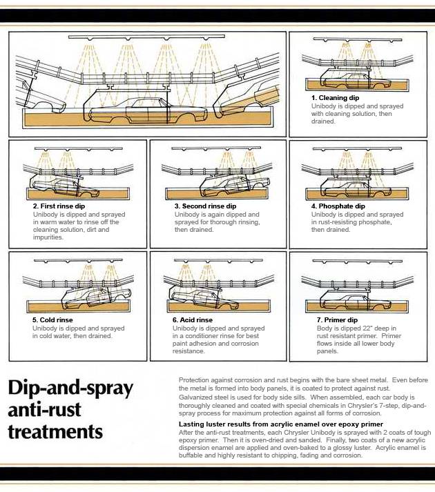

Found it in the cob webs of my mind.I'm sure there are other ones.
I don't know if this is what you seeing?

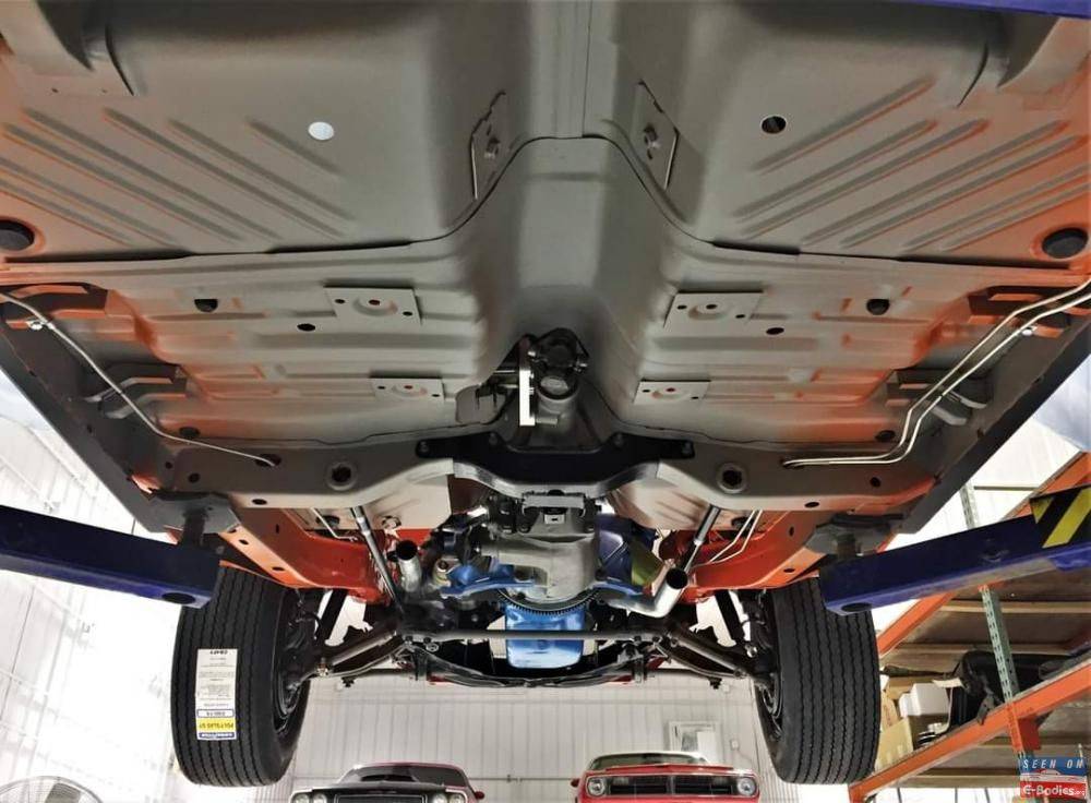

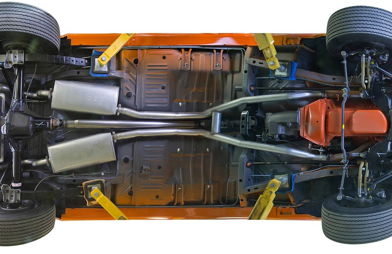

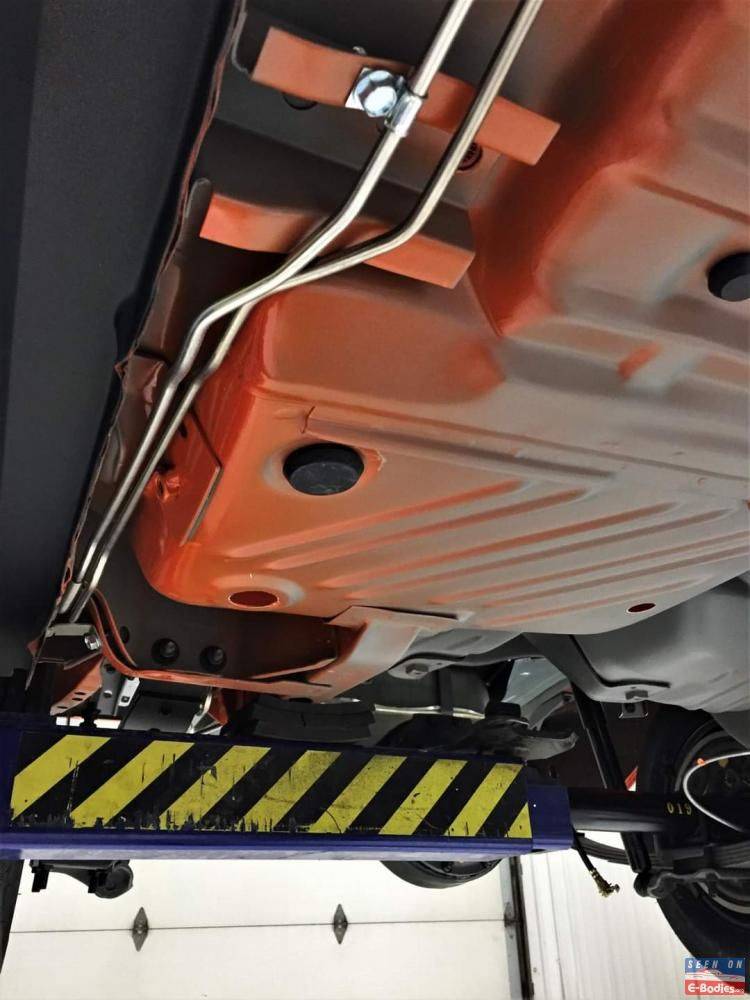

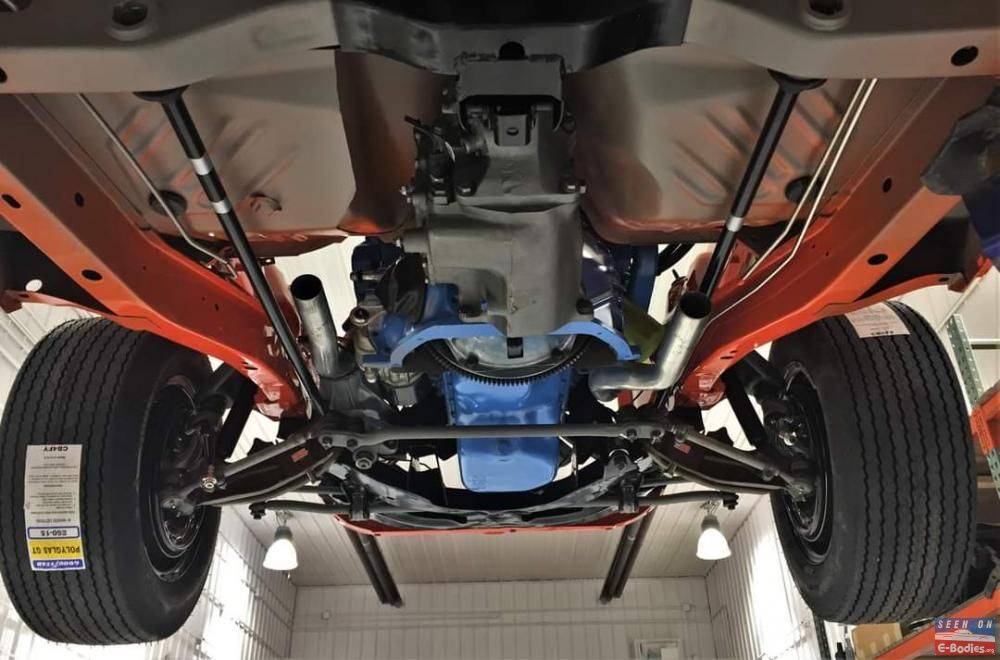

Here are some pics of what the E-Bodies looked like for the floor pans.

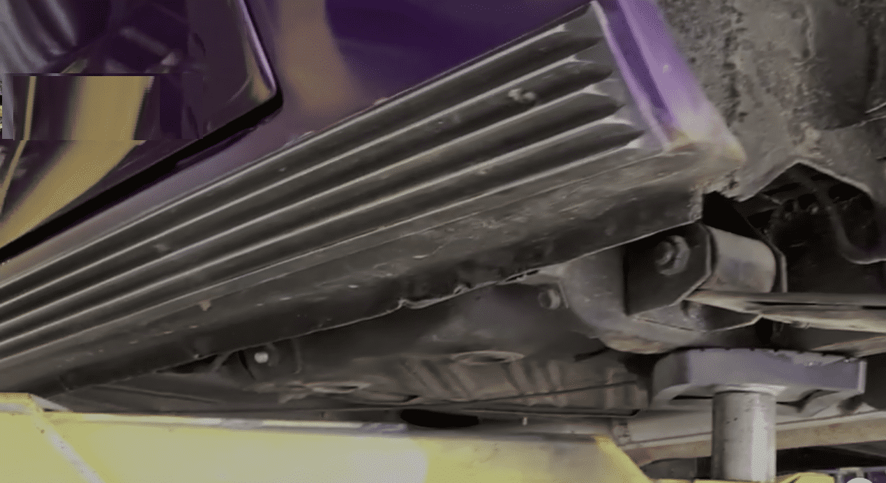

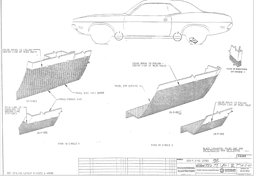

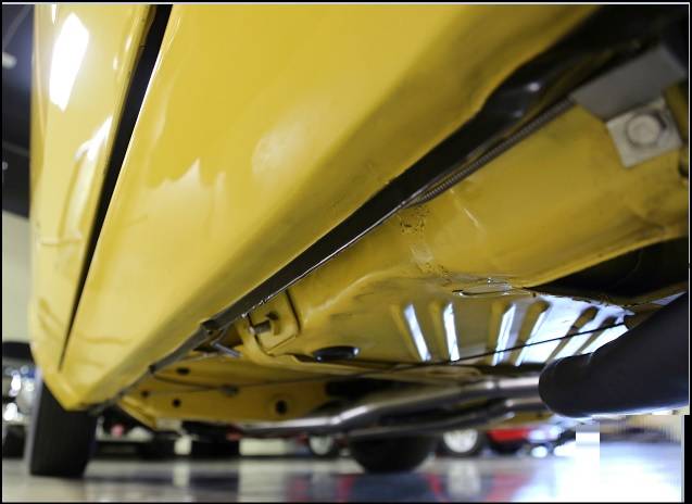

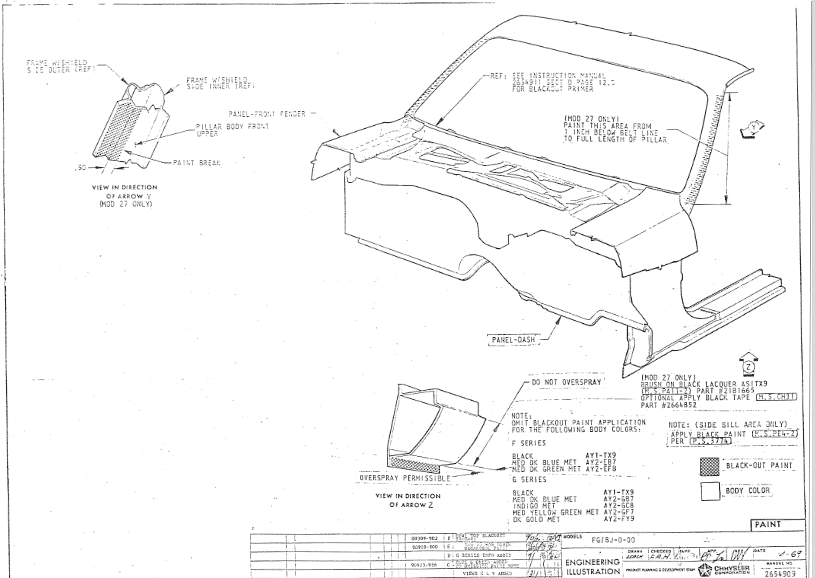

The left photo is a 1970 Gran Coupe and the right is an AAR. Pinchwelds are blacked out. Look at the engineering drawings carefully. Certain darker colors did not receive this blackout. F-series refers to 1970 models and G-series refers to 1971 models just like other body and paint codes.

The burnt orange AAR i am doing the rocker pinch weld and the bottom of the rocker was black. Black overspray was blown over onto the floor pan also .

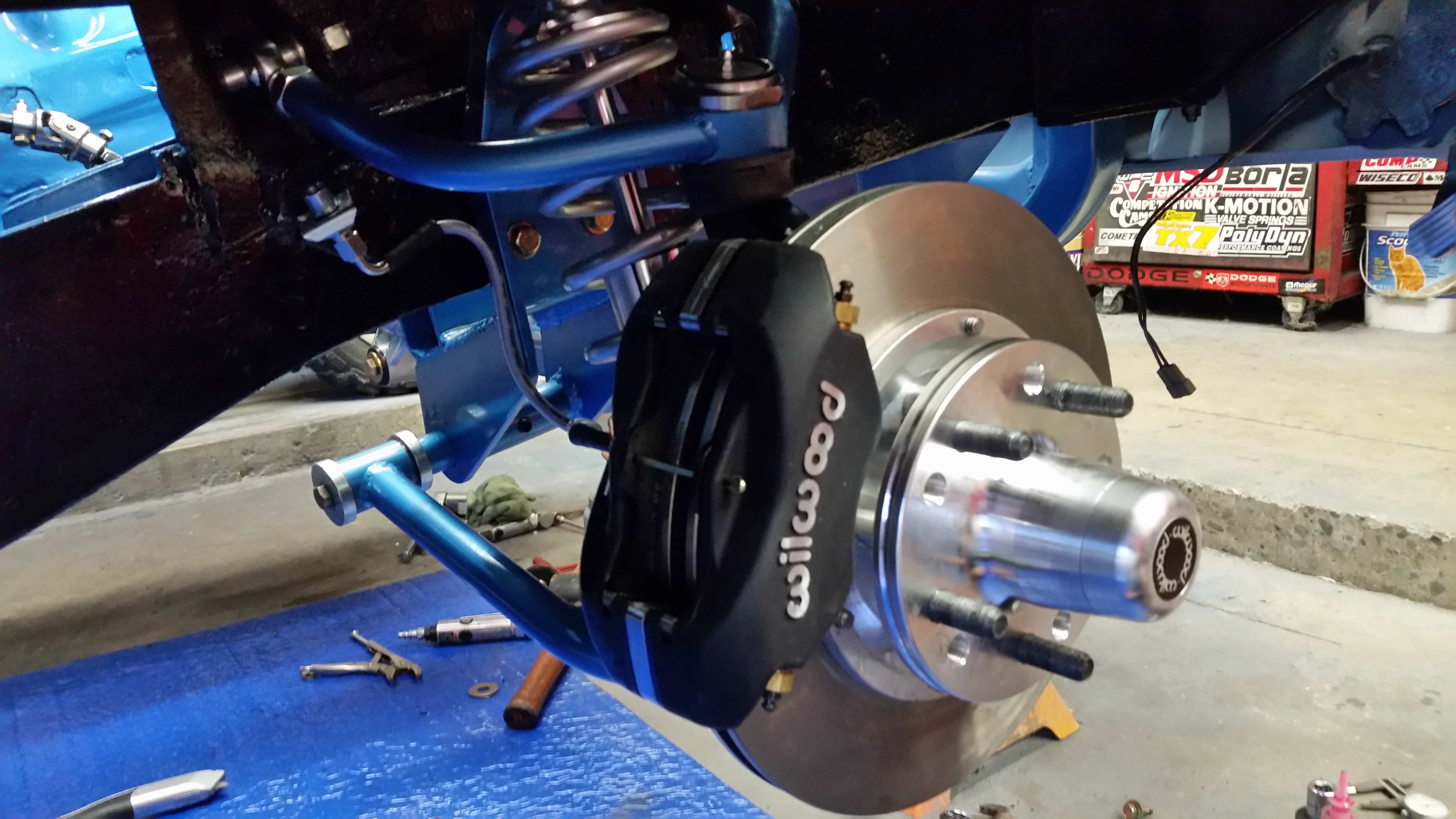

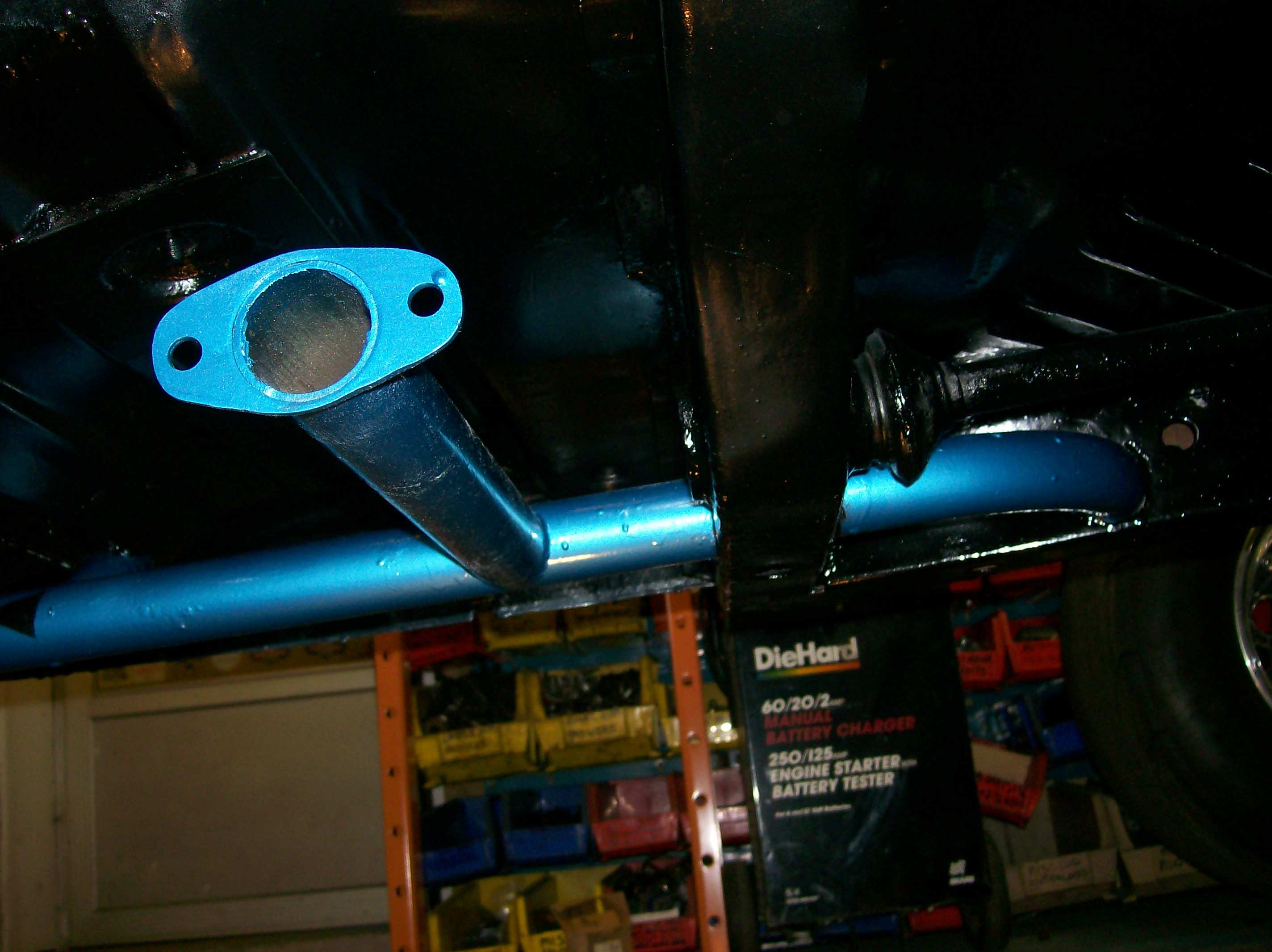

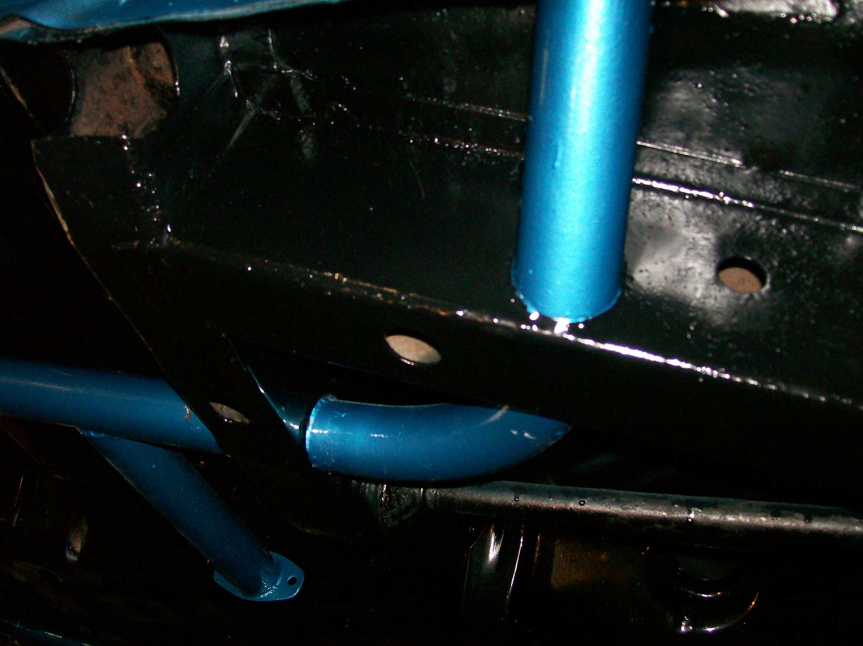

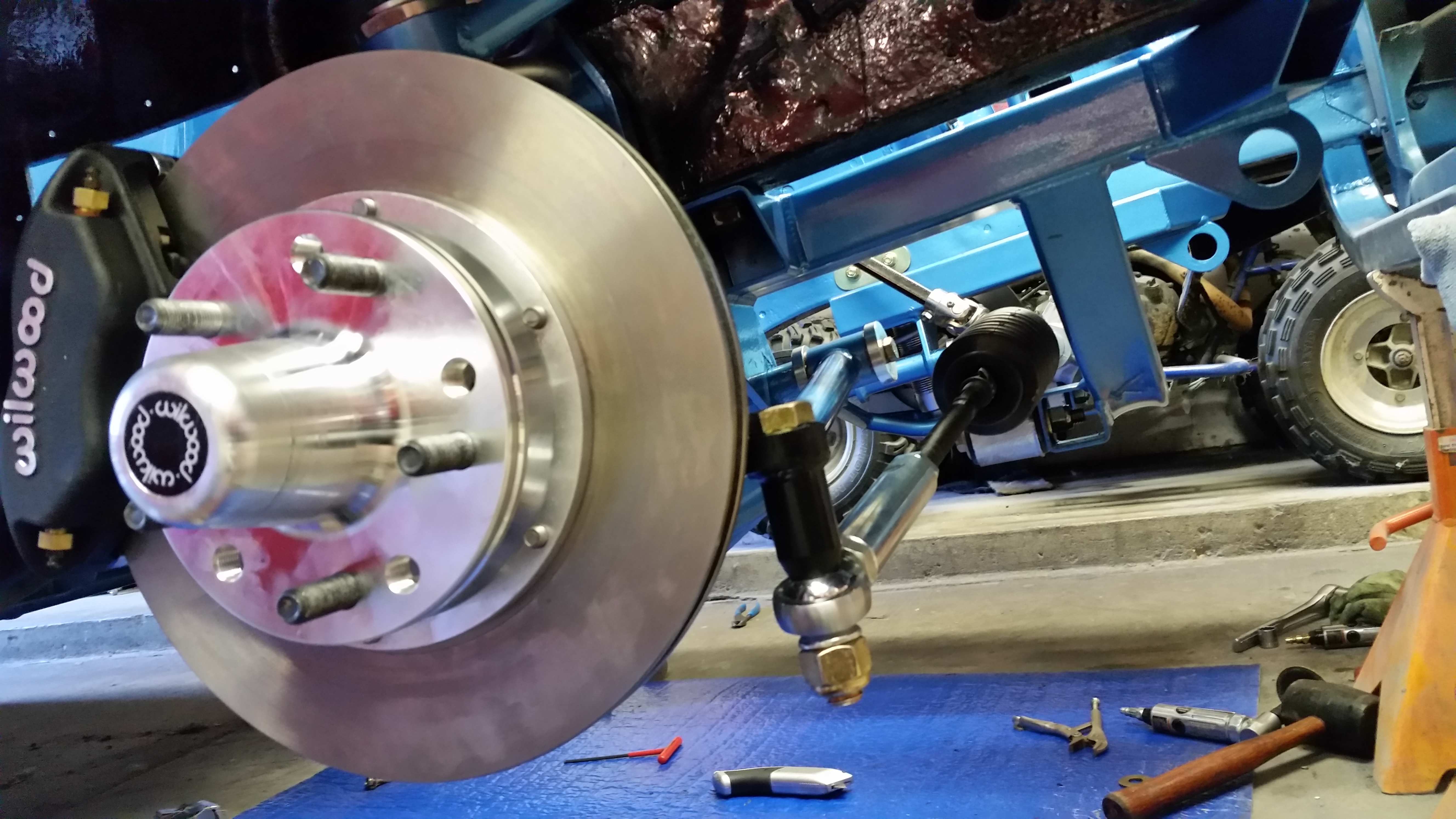

I painted my whole underside and wheel wells gloss chassis black. It is a nice contrast to all the B5 blue suspension parts. Nothing on my car is stock original anyway.

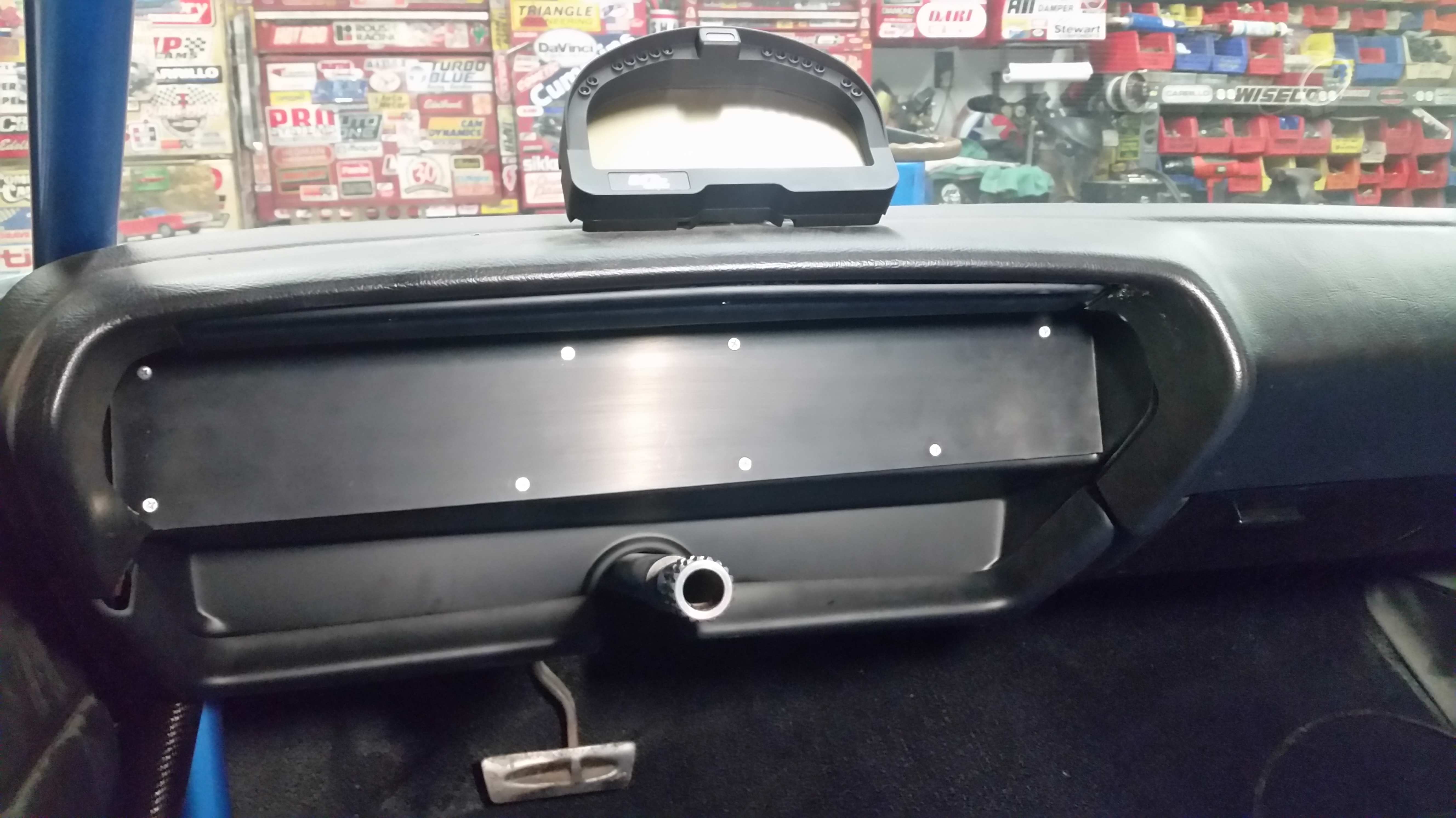

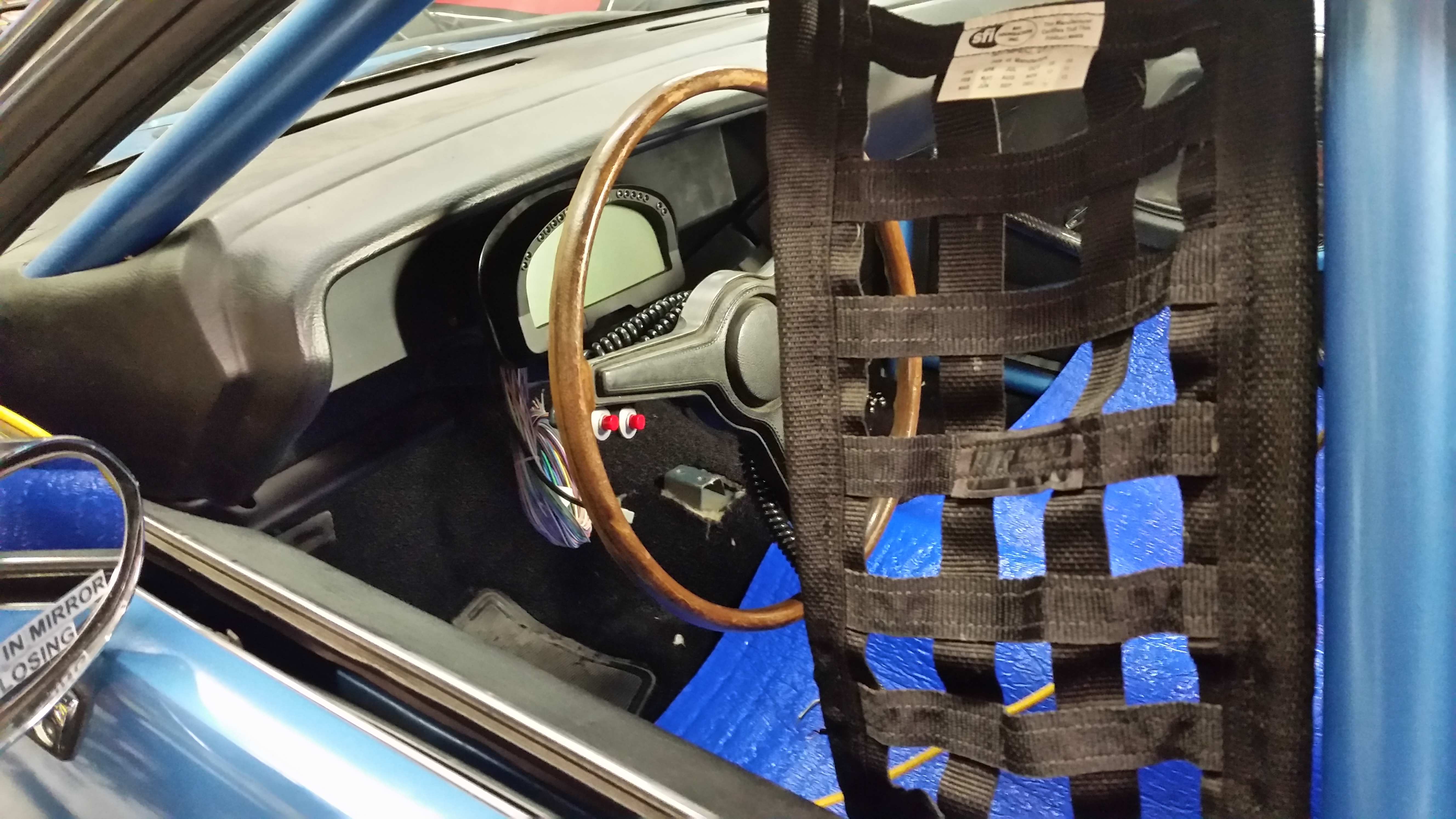

I do have the numbers matching woodgrain steering wheel now removable adapted to fit my tubular steering column along with the numbers matching seat belt buckle reused for my window net...
Last picture was before the headliner and interior was put back in.
