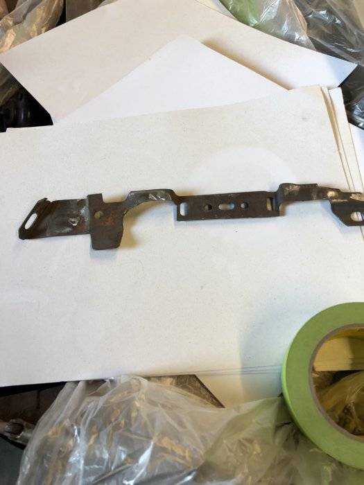

Apr 24, 2019 #1 Cuda525 Well-Known Member Joined Dec 6, 2018 Messages 49 Reaction score 17 What does this do found it in the quarter panel?
Apr 24, 2019 #2 Cuda525 Well-Known Member Joined Dec 6, 2018 Messages 49 Reaction score 17 Is it some kind of window stop

Apr 25, 2019 #4 Cuda525 Well-Known Member Joined Dec 6, 2018 Messages 49 Reaction score 17 Right good question 1973 Cuda, I think it’s was welded in there somewhere. Not sure what actual purpose it serves.

Apr 29, 2019 #5 Moparparts Well-Known Member Joined Nov 15, 2010 Messages 1,067 Reaction score 45 Welds in the quarter panel at the glass belt line to support the outer sheet metal panel and also used for the up stop bracket mounting

Apr 30, 2019 #6 Cuda525 Well-Known Member Joined Dec 6, 2018 Messages 49 Reaction score 17 Thanks for the info just have to find position and weld away.
