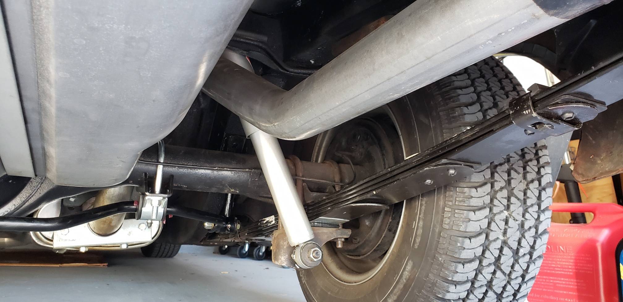

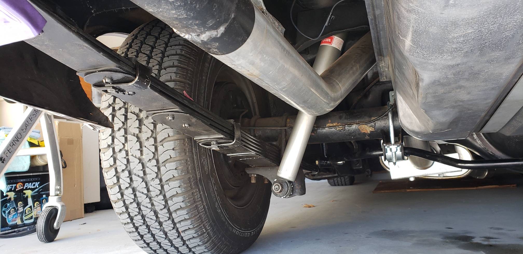

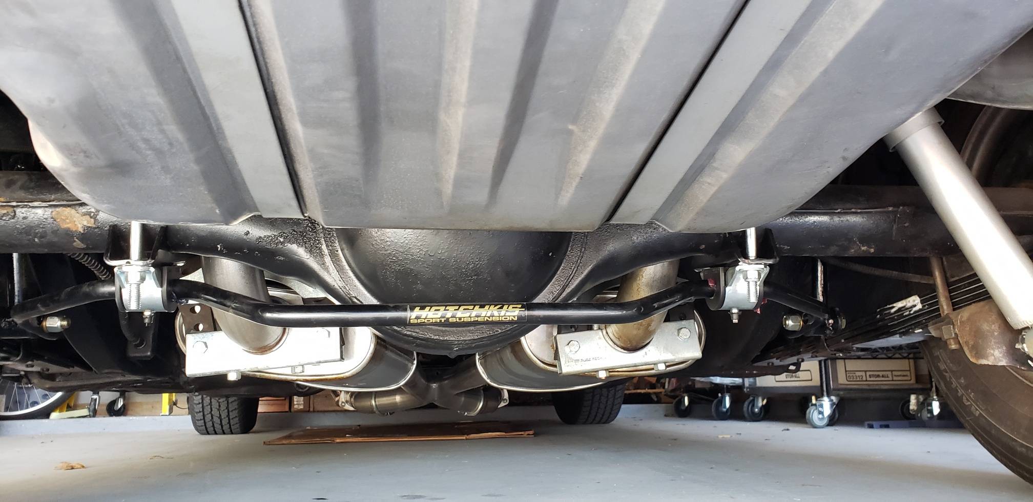

Thanks for the replies, guys. I'm in the Austin TX area, if that matters.
When you say add an "extra main spring", I'm not sure what that entails? Where would I even get that? I bought the Mopar stock springs from Jegs, if that matters also.
If all I need to do is add an extra leaf to my springs, I think there's more than enough bolt length to accommodate it, so not sure what you mean?

In terms of bolt length he's talking about the spring center pin, which is not visible in the picture. It holds the leaves together and acts as a pilot for both the axle housing and the shock plates. They're generally a specific length for their particular spring pack.
Simply adding a leaf is usually only going to raise the car the thickness of that leaf. Find a truck* spring & brake shop nearby, and bring them your springs (they might do the work on the car; ask if that's what you'd prefer). Have your main leaves re-arched a bit more than you think you want, as the springs will settle. They'll be able to advise you better on this than me, but it's usually about an inch extra. They'll also know the length and location of an extra leaf best suited to maintain the arch better than any of us keyboard warriors. It will likely sit too high when you initially reassemble the car, but over a month or two of driving the springs will settle. If the car doesn't settle enough, they can pull some arch back out. It's not an exact science, but they know their business. Our local spring shop is quite good at this stuff. One caveat: Do not simply tell them "I want an extra inch of arch" or that's exactly what you'll get. You'll land right back at Square One after they settle. Discuss what you're trying to accomplish with them, and let them advise you. If they're not capable of that, find a different shop.
Future generations thank you for not choosing air or coil-over shocks to adjust ride height.
*Look in the Yellow Pages or yp com under Truck Repair. Our local shop does not advertise in the automotive section.

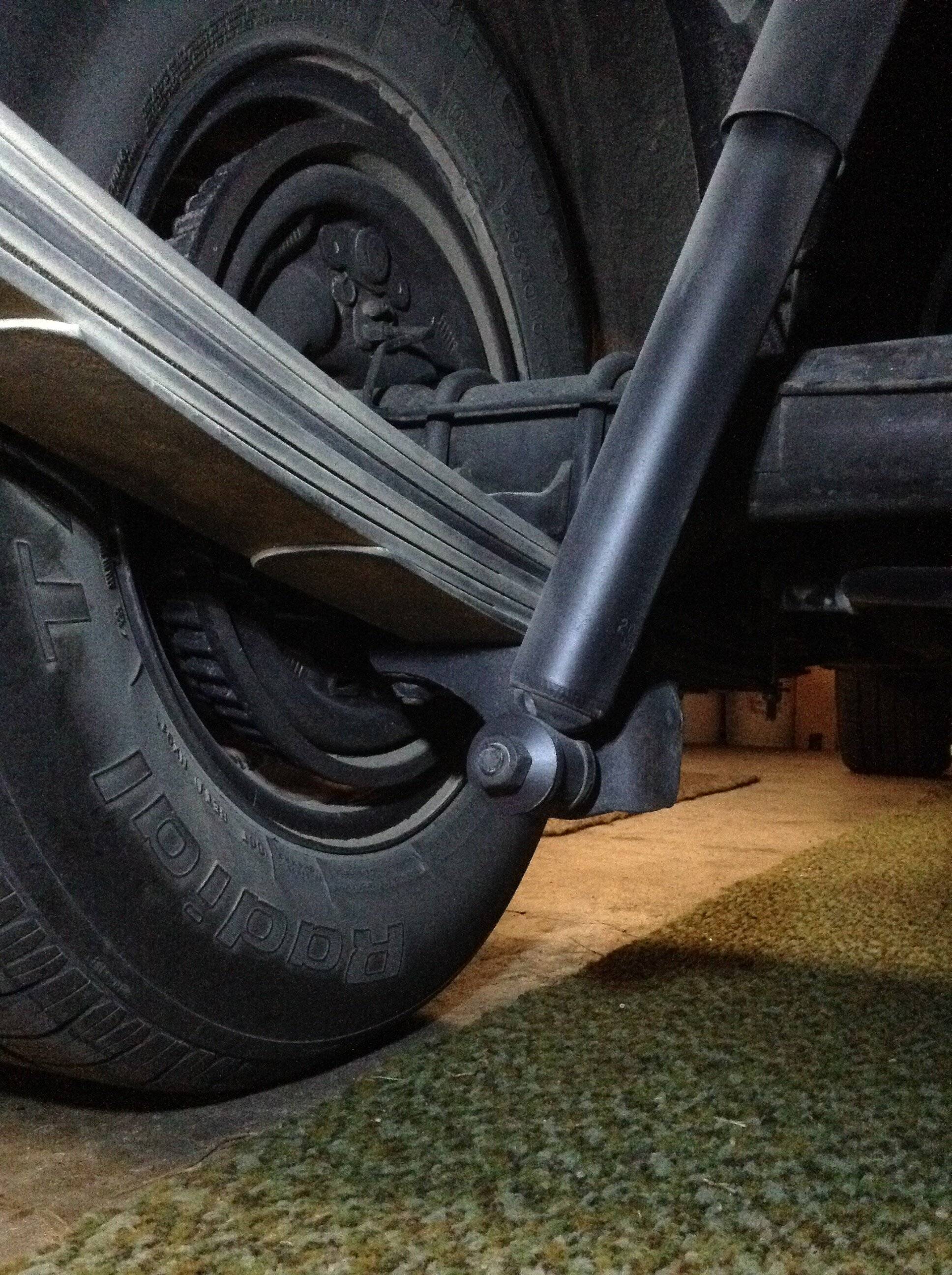

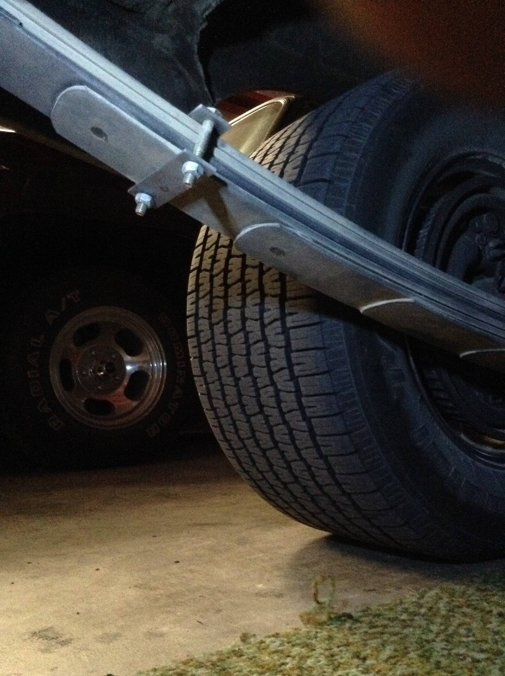

I bought new 2 inch over stock springs and ran them for awhile and they lost a half inch so I used 2 leafs off my old spring. I got new longer center bolts and used strap iron with 5/16 bolts for thicker spring clamps. This gave me my half inch back. Just do one side of the car at a time. This worked for me, might not work for everybody!
