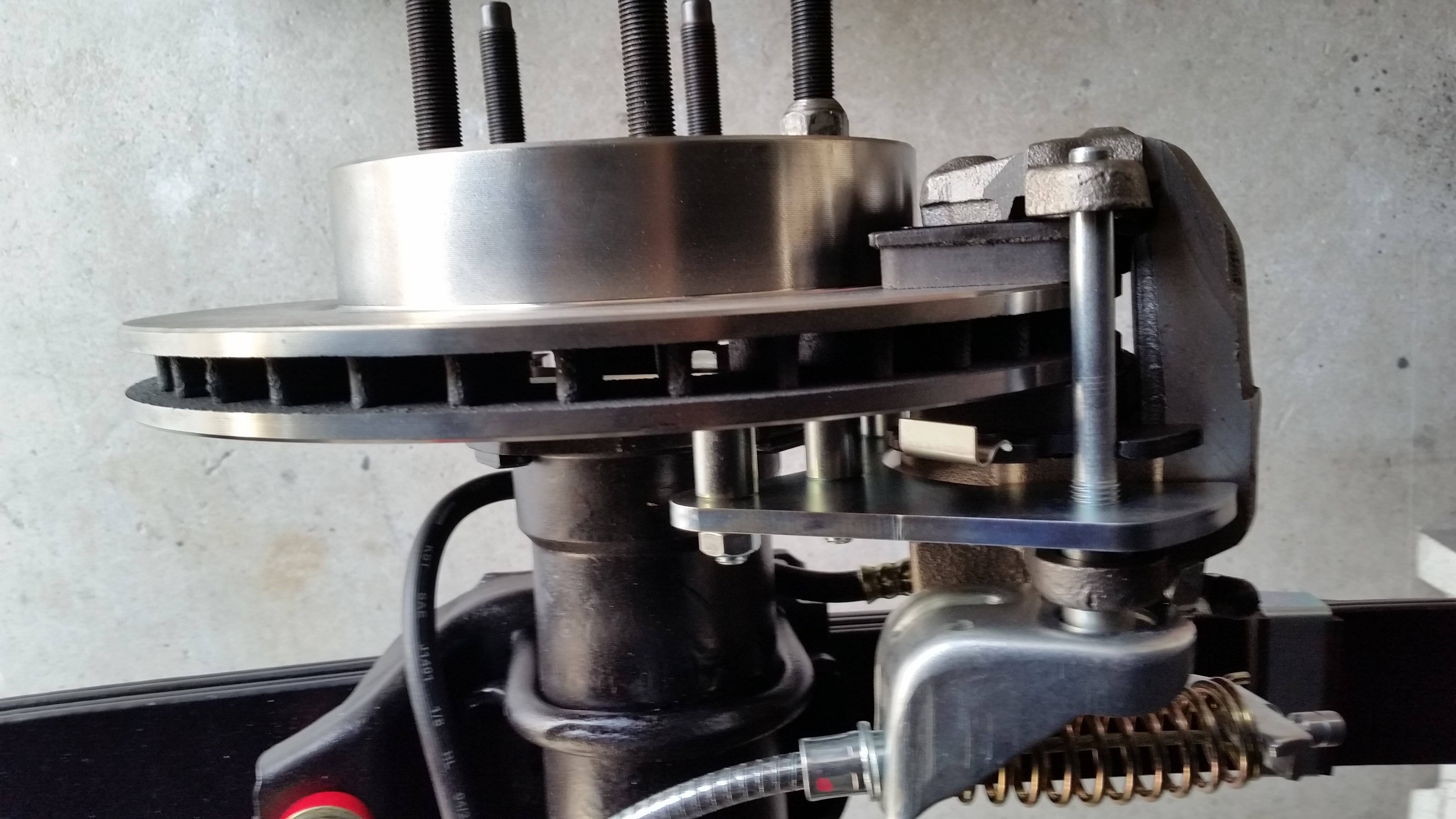

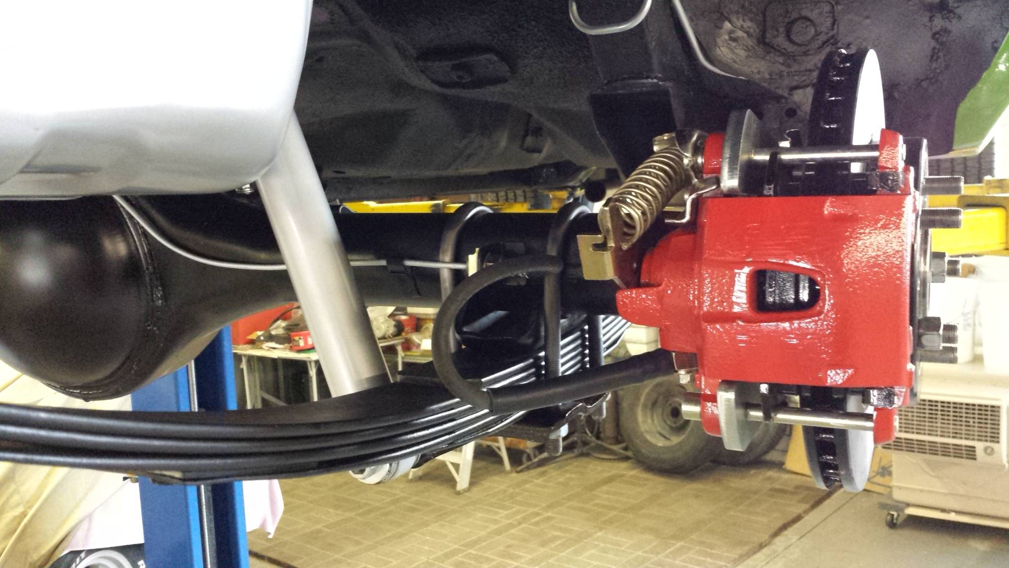

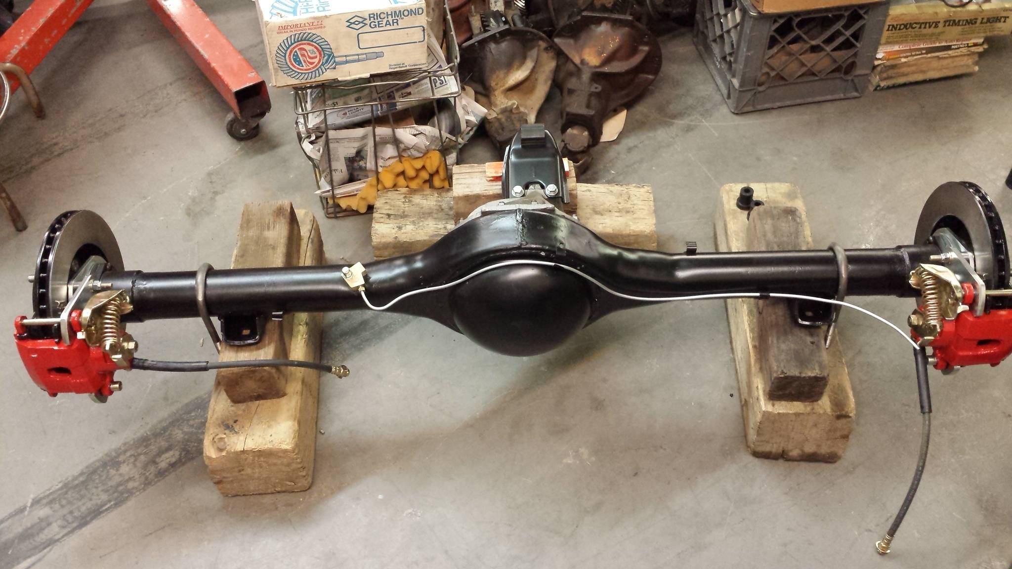

Here is a look at my Challenger axel

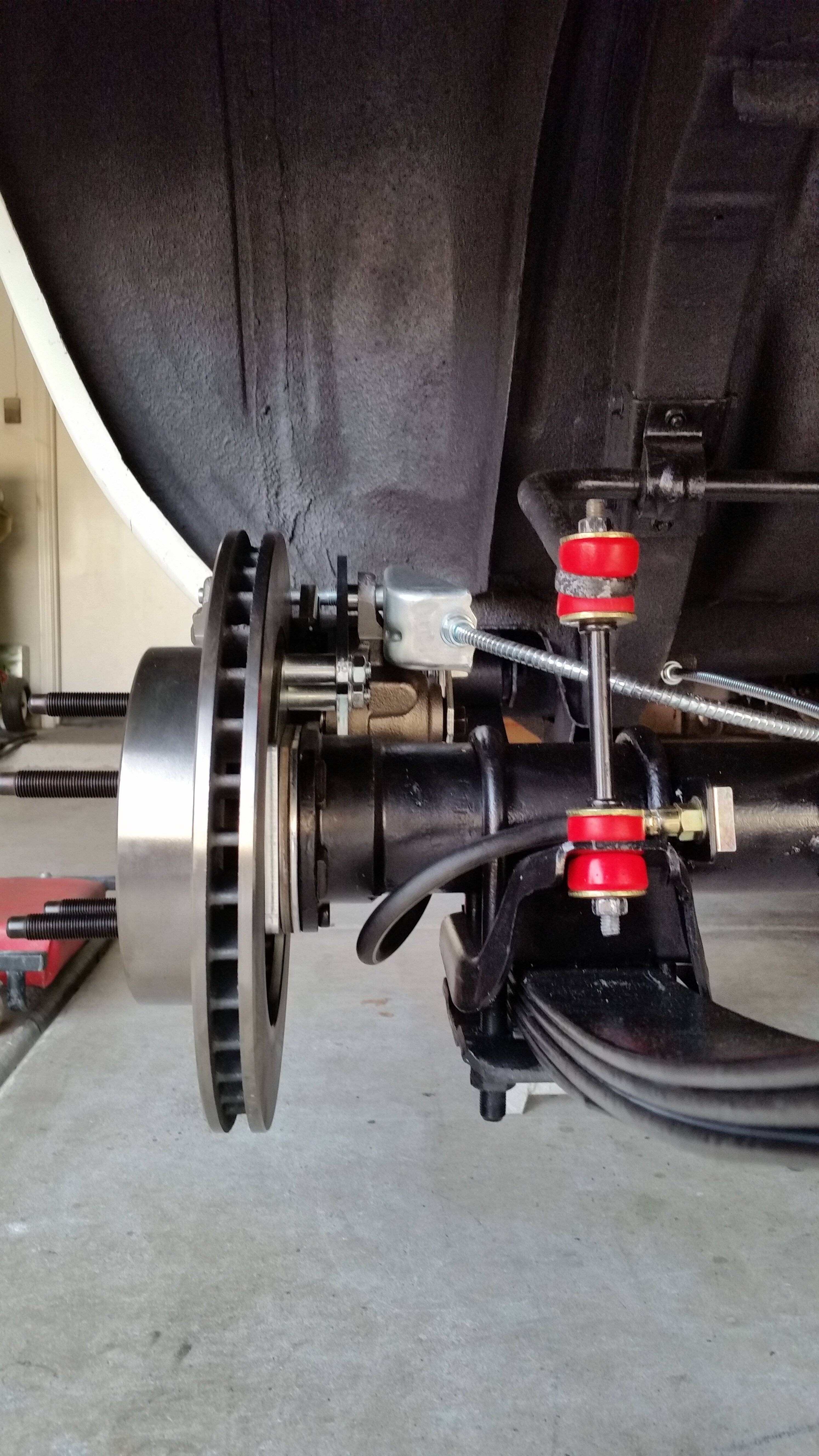

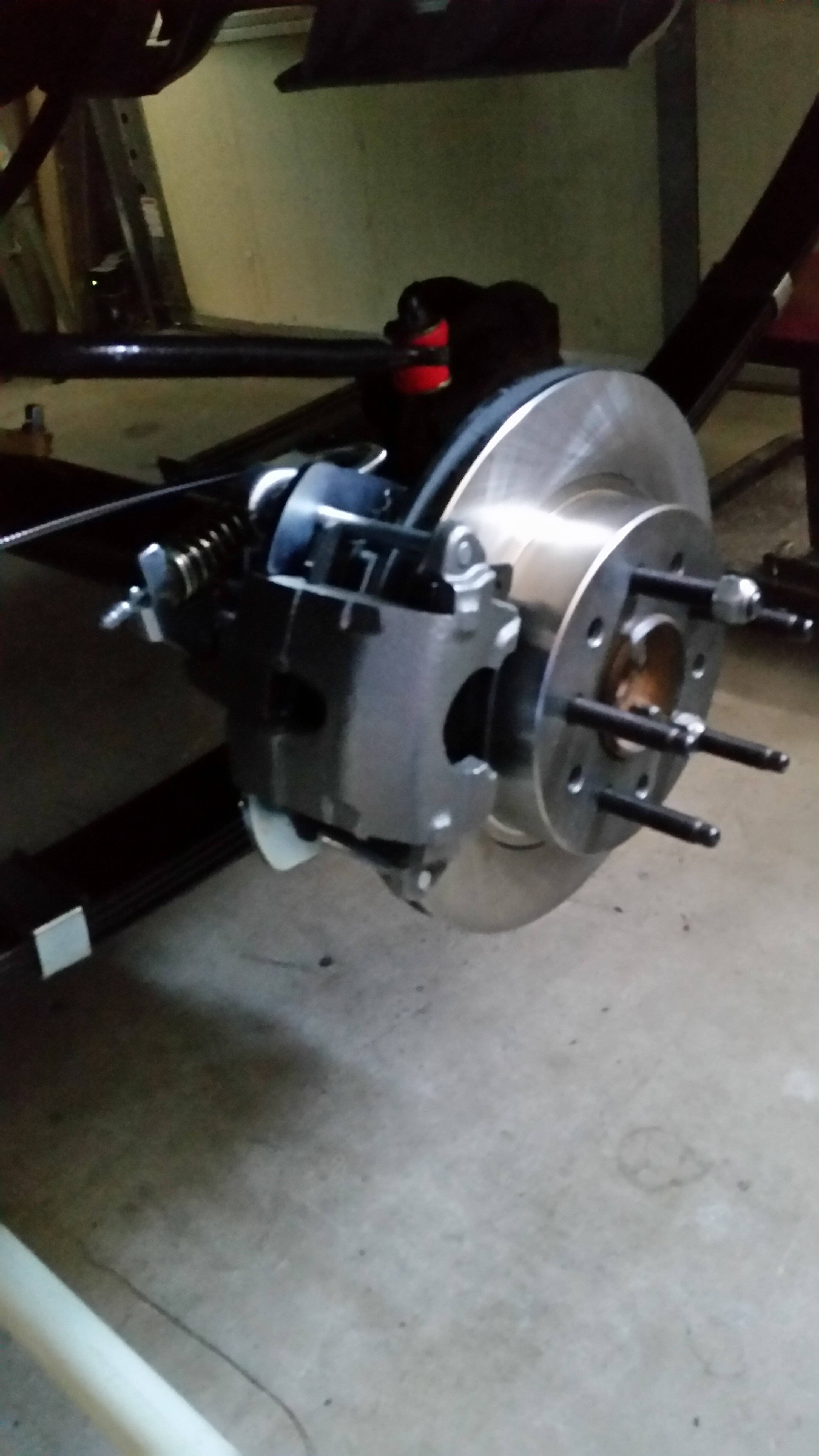

That kit and the one from MBM both use Cadillac calipers. Real popular with a lot of conversion kits for GM and Ford too. I have them on my Dart and my friend has them on his 70 Challenger and 70 Cuda. They are a pain to get the calipers adjusted but other than that they work good.
These are the MBM units on my Dart
