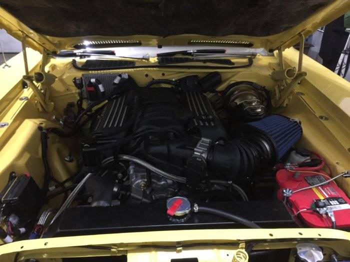

Oops here it is. And my new oil burner compete
