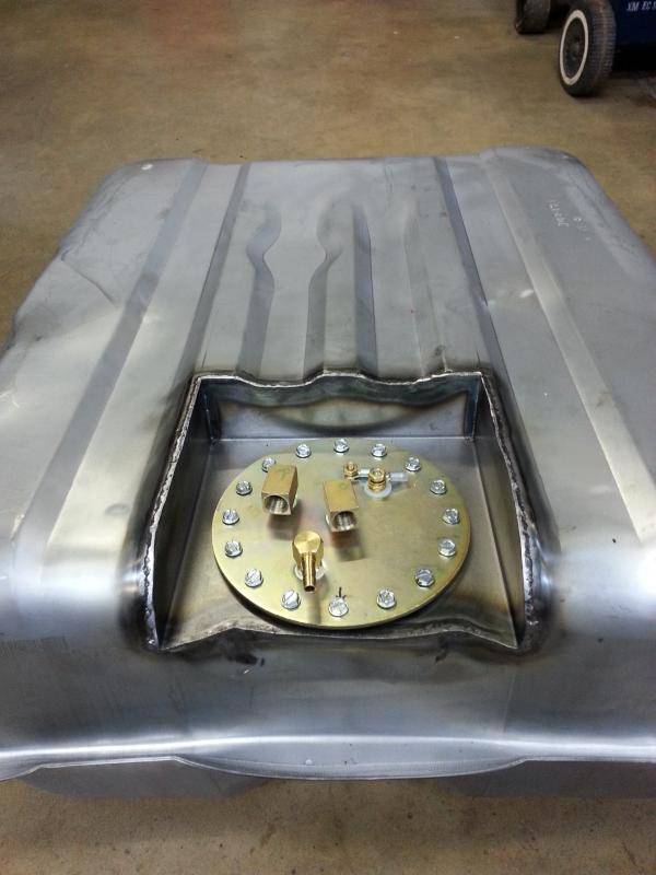

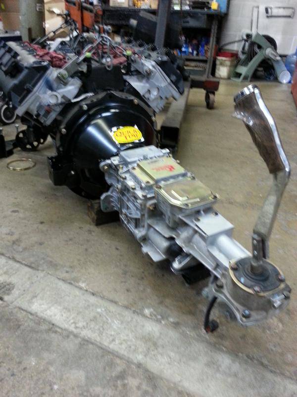

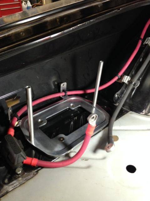

It is getting a 2013 5.7 hemi with a Keisler TKO 5 speed for the powertrain. We using factory efi using a 6.1 intake .It has factory ecm and hotwire harness purchased from Modern Muscle for the engine and a Ron Francis harness for the rest. TTI headers and using a Tanks in tank module on a factory tank for the efi pump just finished tig welding that in today.

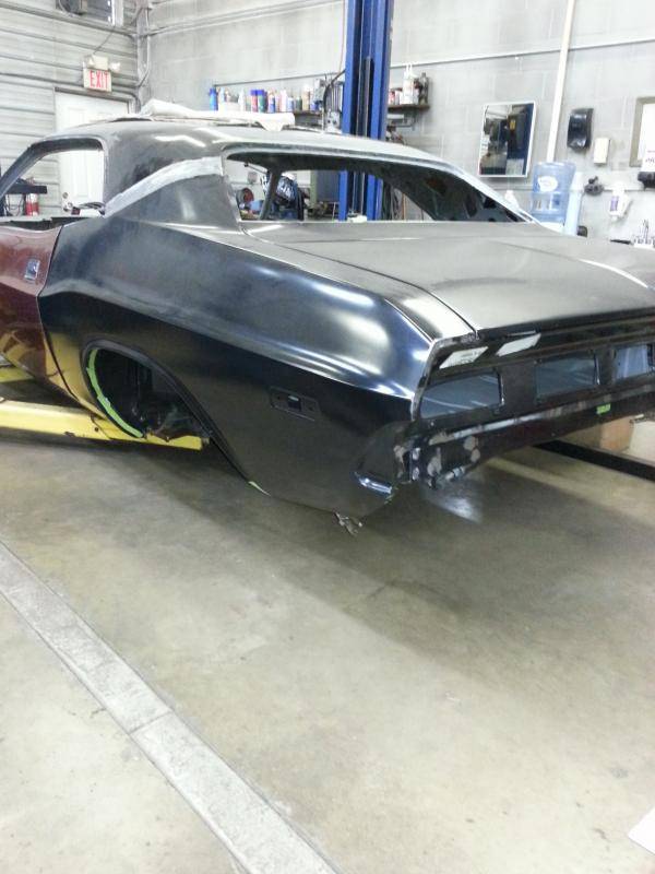

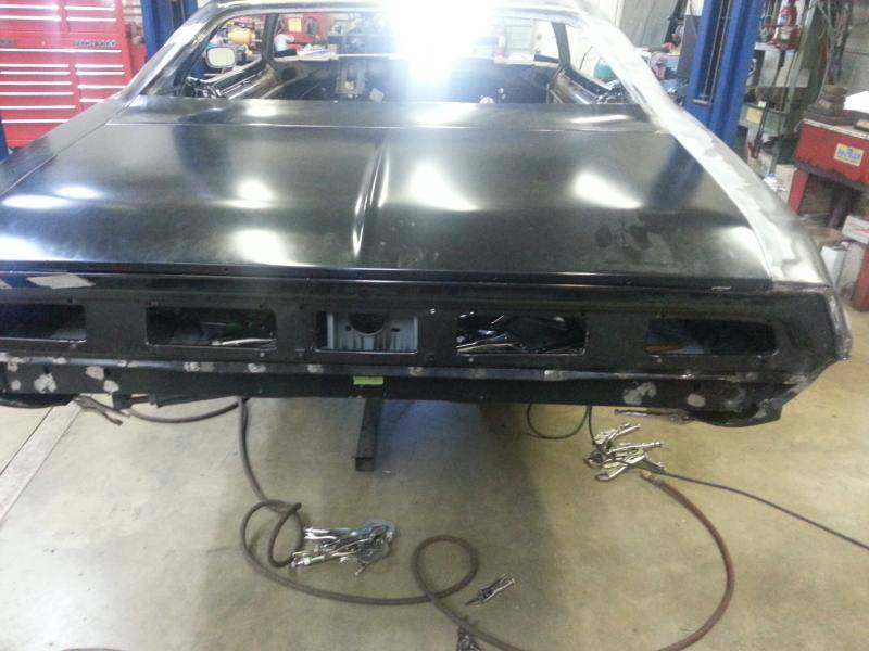

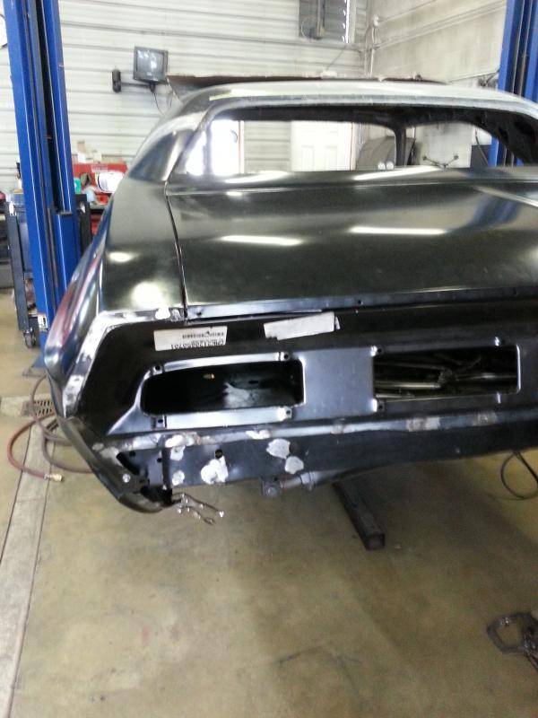

Here is a shot of the rear ,it' great that AMD makes these panels.

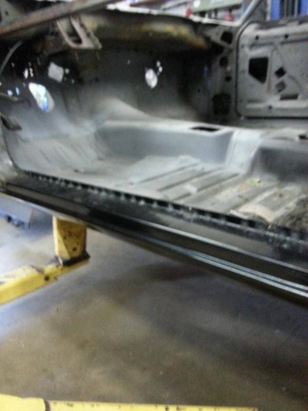

Also ended up putting on new outer rockers on it too . Have all the major body panel work done now.

Nice project and welcome to the site. Sheet metal work looks good. How did all that AMD sheetmetal fit together?

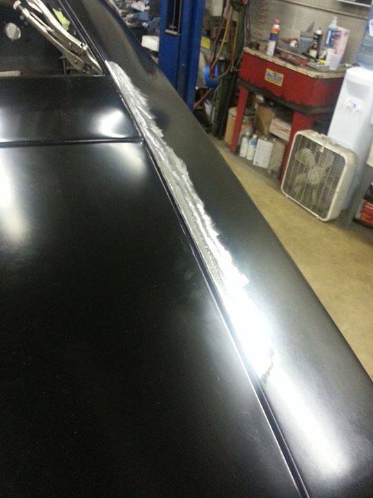

It took a massaging and lot of trial fits using sheet metal screws, but the one panel that gave me fits was the right side quarter panel at the quarter/deck lid .
I did end up cutting and moving the quarter over to get a good fit in that area.
I like to use the tig welder for the sheet metal ,it gives a very strong weld.

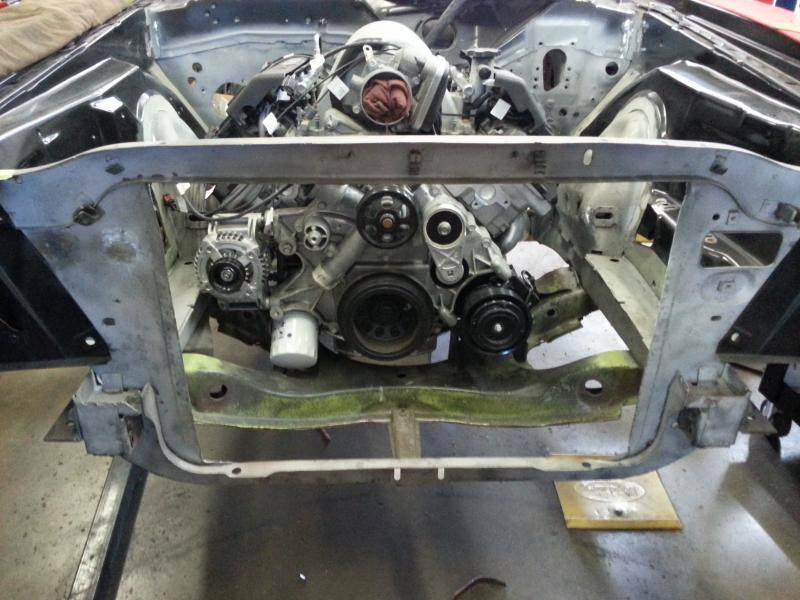

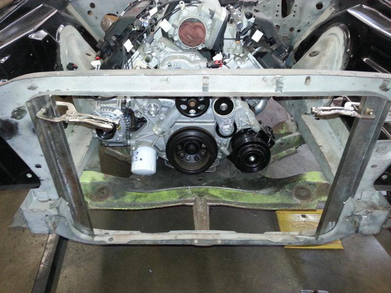

Had to enlarge the opening in the core support/radiator area for a 26" core.
Made custom metal pieces to strengthen. Wanting to make caps for the upper support and these pieces to run and hide the front wiring in.

I see you are using the stock K frame, and that you have enough room to remove the oil filter?
Are you adding extra support to the radiator frame to help minimize front end flex?

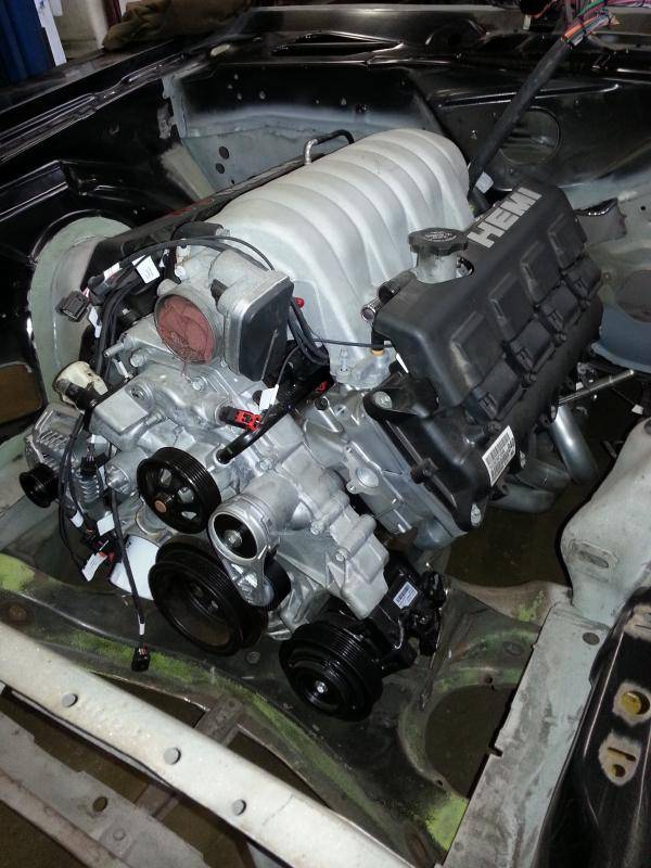

Please let us know what/where you grind and smooth on the intake to make it work right.

Looks like you are off to do things right. Great.
I don't know why AMD products seem to regularly cause fit problems.
Waiting to see and hear about mounting the clutch. Hope it goes smoothly.
Thanks !! I had to order an angle oil filter adapter for a 6.1 and notch the k-frame.
Not sure yet on the radiator support , but do want to add frame connectors for sure.

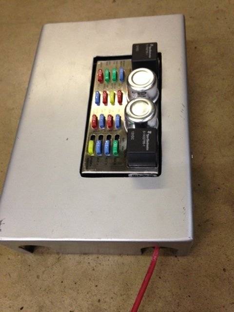

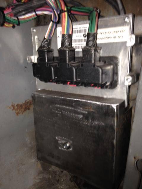

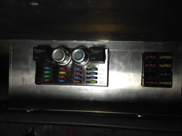

Right now working on running wiring and mounting the pcm and fuse panels.
I will double check , but believe the 6.1 intake ports should match up to the 09 and newer eagle heads.

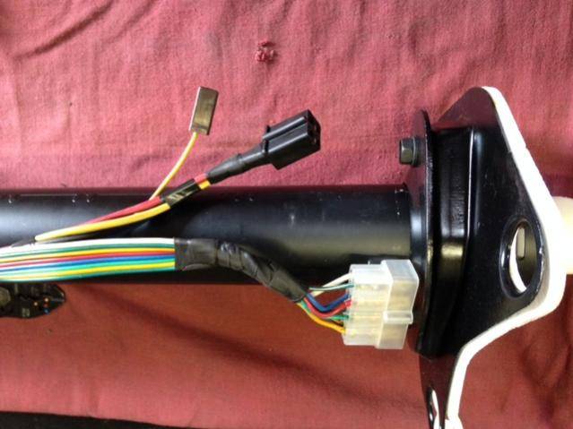

Working on the column wiring today . Had to remove the factory style connectors and install the new ones from Ron Francis.
