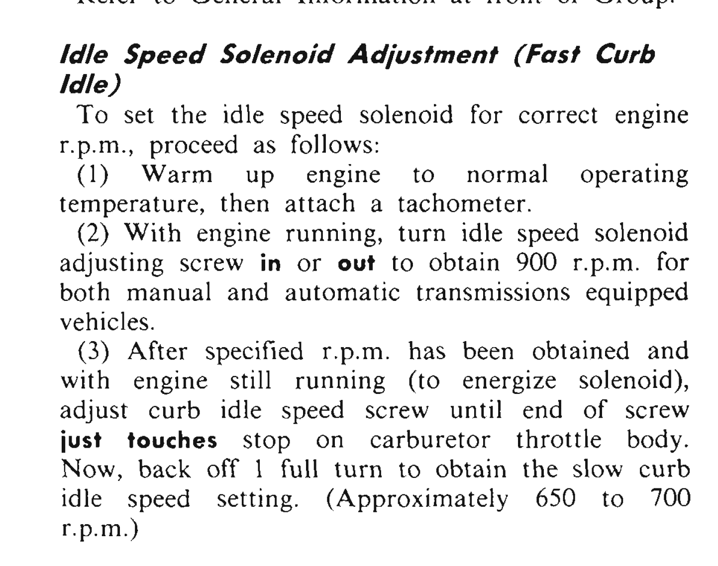

All OE six-packs came with idle solenoids as a stock correctly tuned (as factory spec’d) six-pack tended to diesel without one no matter what optional equipment or anything related to emissions control. Be sure the solenoid still functions and set as described in the FSM.

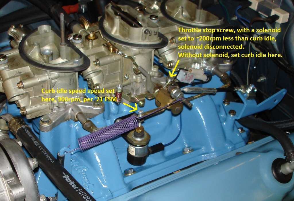

Original replacements are rare and expensive, repos are junk. If exact original appearance is not too concerning there are functional quality alternatives.

If you go back to my engine bay picture, post #17, you can see that it connects to one side on the ballast resistor, to the special connector, which supplies power as soon as the ignition is turned on. And yes, it is always energized, until you turn off the key.

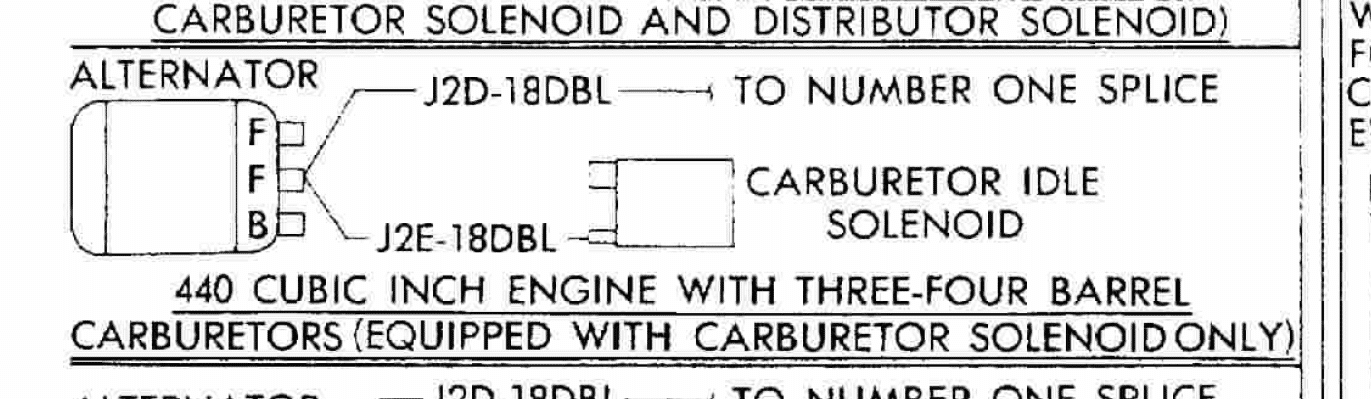

Specifically for a ’70, the solenoid power is doubled up at the ign1 terminal at one of the field connectors at the alternator, same circuit at the ballast resistor shown on the ’69 picture above.
Interesting type-O, “Three-four barrel carburetors”?

Thank you very much now I have more information and can trace. Awesome group, happy I joined this forum.
