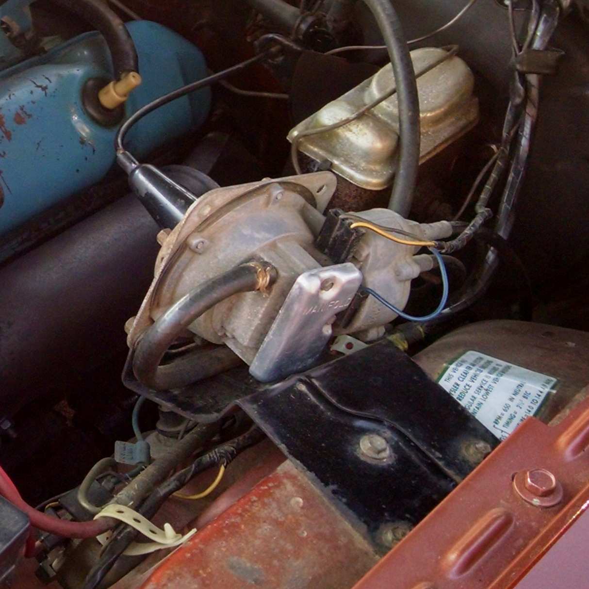

My 1970 Challenger has the Speed Control option which worked fine until recently when I lost the speedometer and odometer. It appears the speed control unit seized up and it snapped the lower speedometer cable at the transmission end.
Does anyone have experience repairing them? Are they simple enough for a do-it-yourselfer or is there someone out there who specializes in servicing these speed control units? I would appreciate any help you can provide...

Maybe you could hook a vacuum gauge/pump to it and see if it holds when you pull a vacuum on it. There is a rubber diaphragm inside of it that could have rotted sometime in the last 50 years. If that is the case, maybe you could luck into a replacement diaphragm.

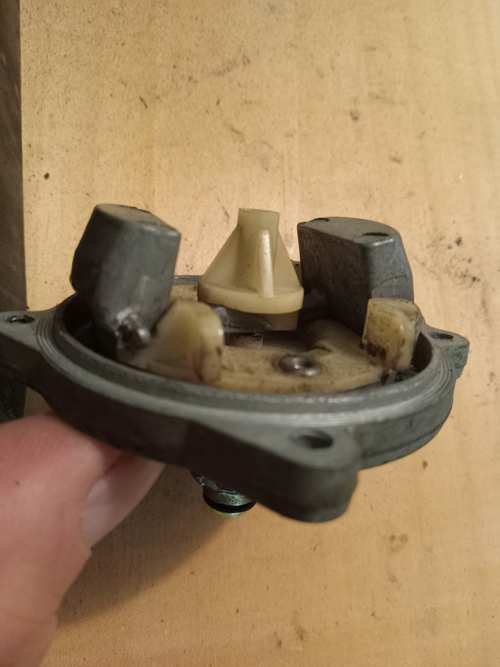

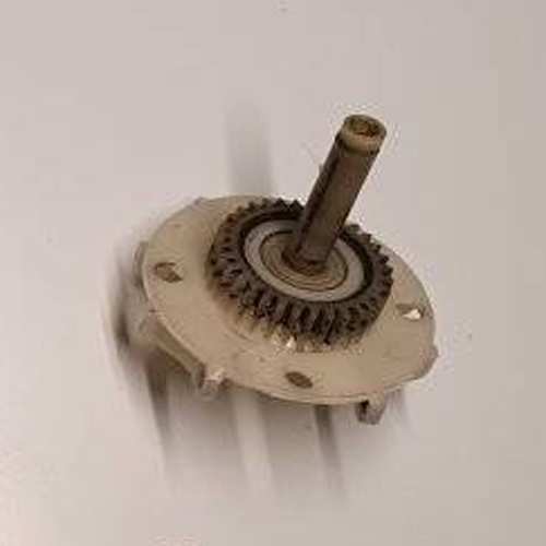

An update. Upon removal of the gear cover, I discovered the problem. One of the four plastic (nylon?) tabs that hold in place the pins of the two metal flywheels broke off and another looks worn. (In the first photo, notice nothing is left to hold the flywheel pin in place.)
Does anyone have a Speed Control unit that is dead for another reason or parted out? It appears I need only the gear assembly.
