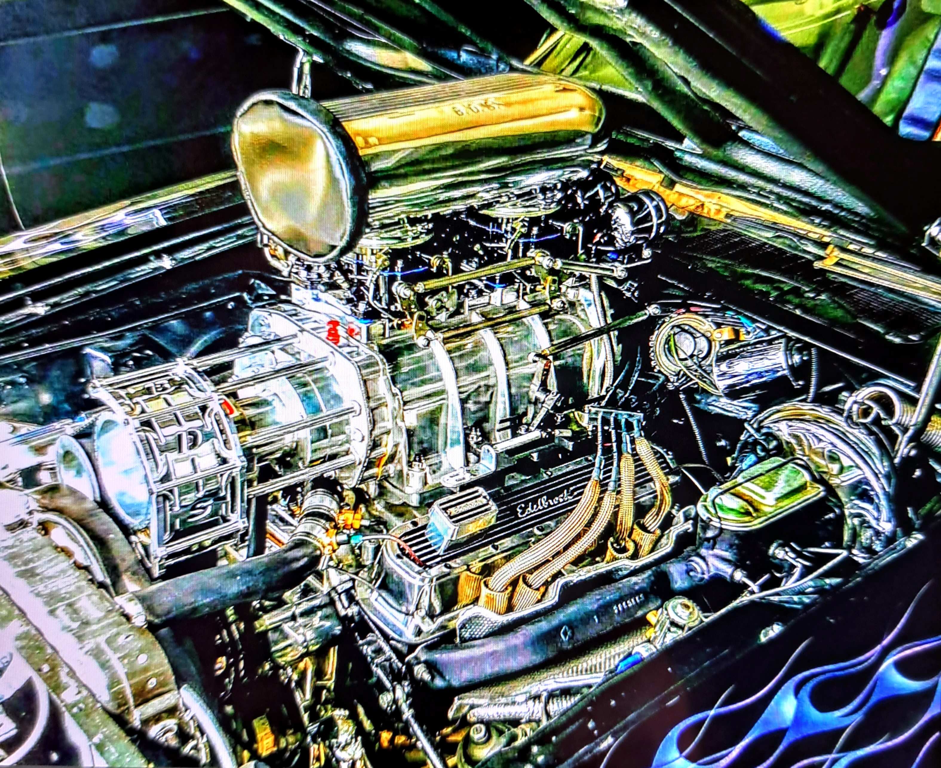

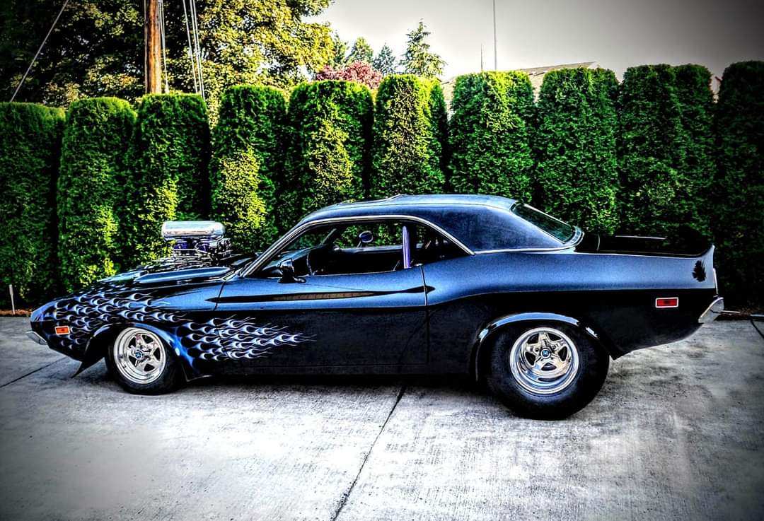

I always use the sealer " The right stuff " will never leak oil at the pan / timing chain cover. I've ran my 340ci Blower motor 48 years in my 73 Challenger and not one drop of oil has leaked.
