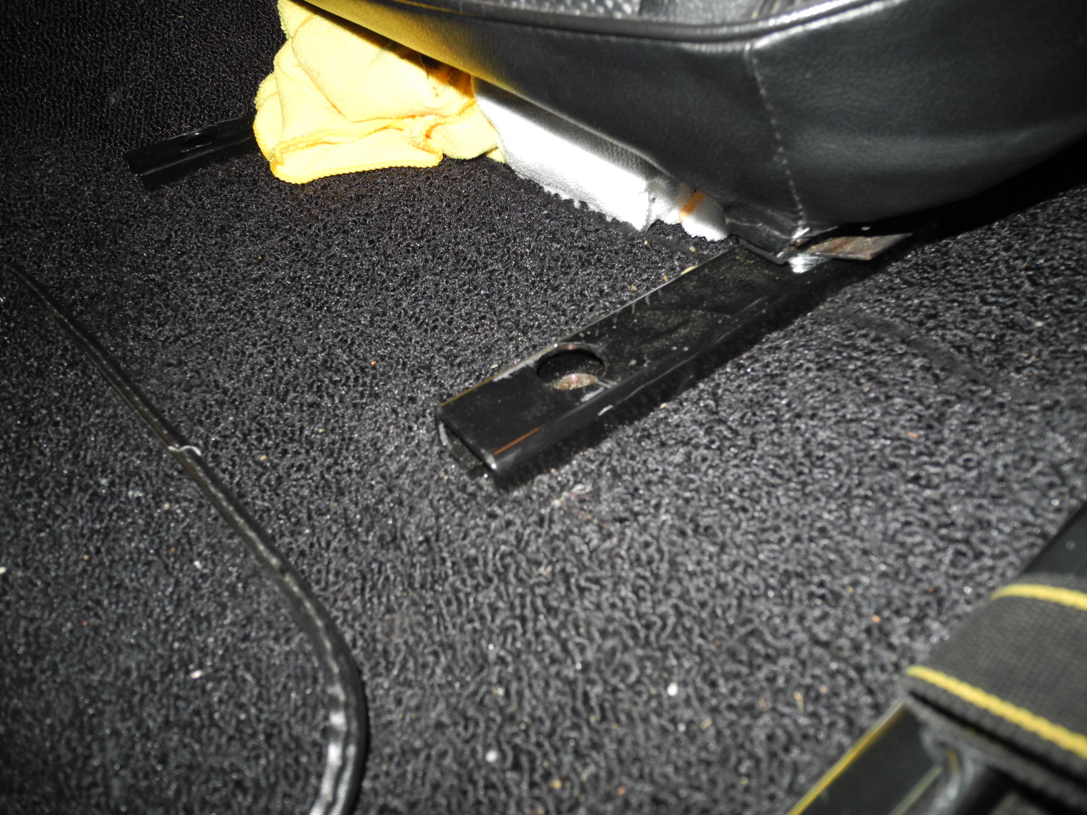

Ralph
Mar 5, 2013
350
71
Ok, here you go.
See picture and blueprint.
Please double check all sizes since mine may be different.
This is simple to remove if I decide to sell - just unbolt.
