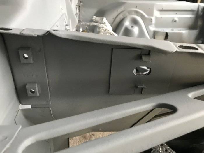

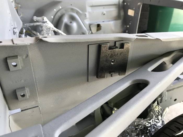

Looking for a little help today. In regards to my hood hinges bolting to the fenders. The forward mounting hole had a bolt, washer and nut on both sides and they were not the same socket size as the rearward bolts. This can’t be right? Anyone have a picture or a link to what should be there? Hoping there is an available replacement :(
Looked online to no avail.
Any help is greatly appreciated!

Not a great pic, and I don’t know the size (5/16 or 3/8) but this will let you know how they did it.. probably easy to fab a new one.
moparlee
Jul 25, 2011
3,266
1,441
Mid Michigan
It is a 1/4" thick steel plate with a tapped hole in the center for the bolt and has two notches to match up with those tabs in the inner fender. It is designed to have "slop" in it for adjustment.

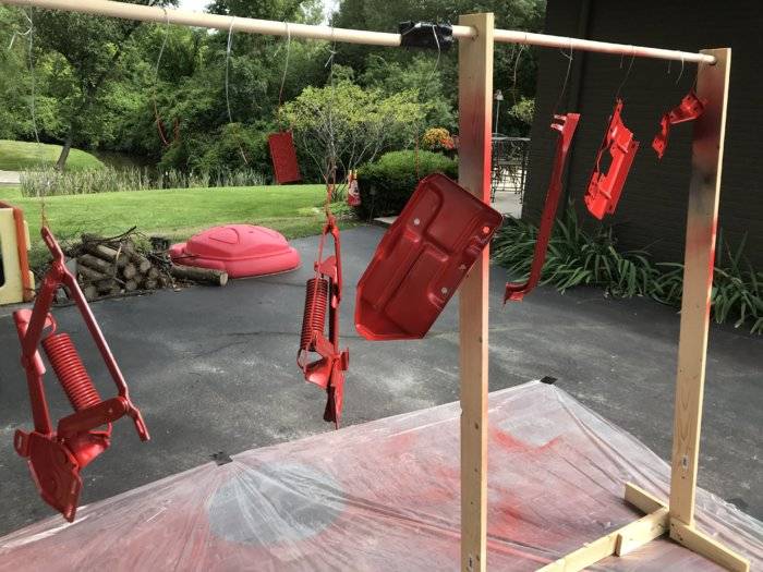

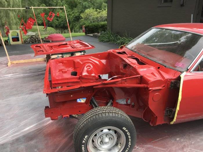

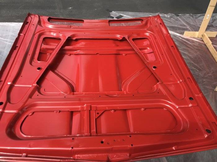

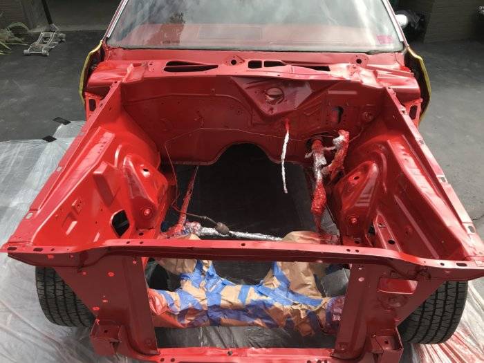

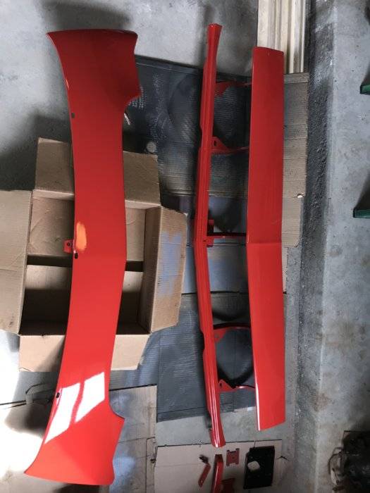

Decided to spray the car myself....the hood and engine bay were a challenge to me. I don’t have a lot of experience spraying color. It came out alright, a little dry in some spots. The front valence and header panel came out the best by far as I didn’t have all the books and crannies to paint around.

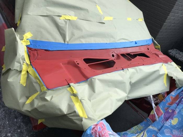

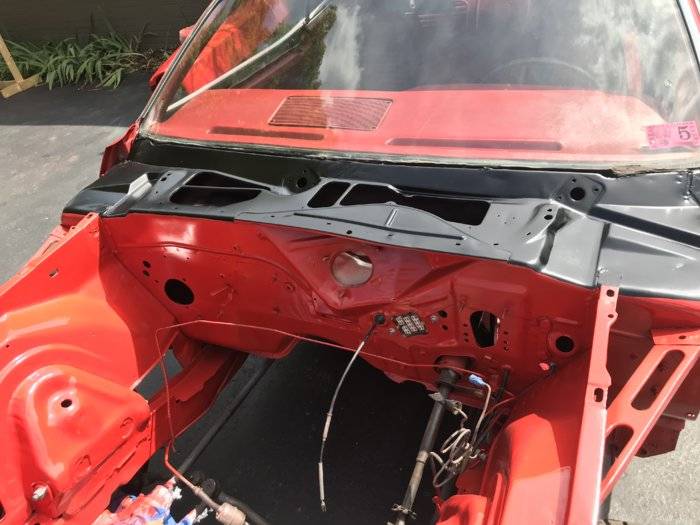

Prepped and painted the cowl while the fenders were off. Going to black out the front end once the fenders are on I'm thinking

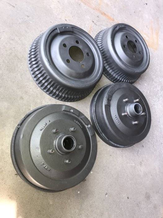

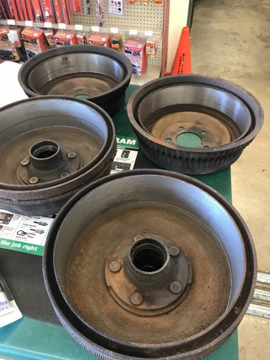

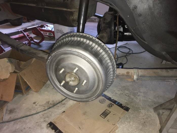

Dropped the drums off to get turned. Guy behind the counter said “Are those from a 1 ton?” I said nope, Plymouth Cuda. Gave me a chuckle lol. Picked them up today and then spent some time cleaning them up and sprayed them with Eastwood cast iron gray.

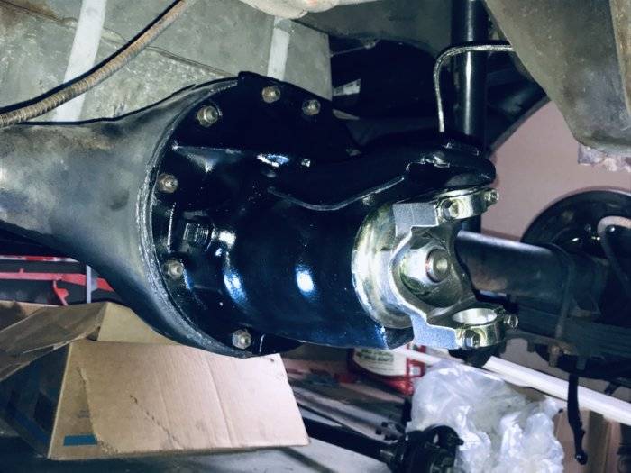

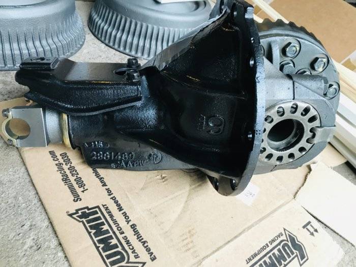

I had to pause on finishing the brakes as I needed to replace the rear axle seals....then I decided to pull the center section to change the fluid...then I decided might as well put the gear I want and ditch the 3.23. So I dropped it off to the local Ring and Pinion Shop on Monday and picked it up today/ Friday. It needed bearings and had to put a new yoke on it and went for 3.73’s. I think they will be perfect for my setup.
Also drilled and tapped the housing so i could install a drain plug. Going to put the axles in tomorrow, fill it up with fluid and finally finish the rear brakes and bleed the system.

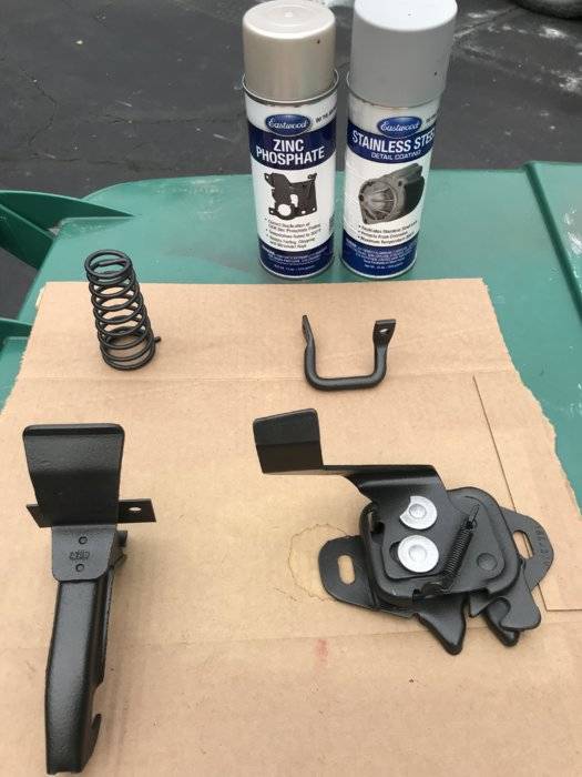

I have been waiting for the Eastwood zinc phosphate to come back in stock...and finally was able to try it on the hood small bits. Real happy with the results for little money spent. Finished them off with matte clear.

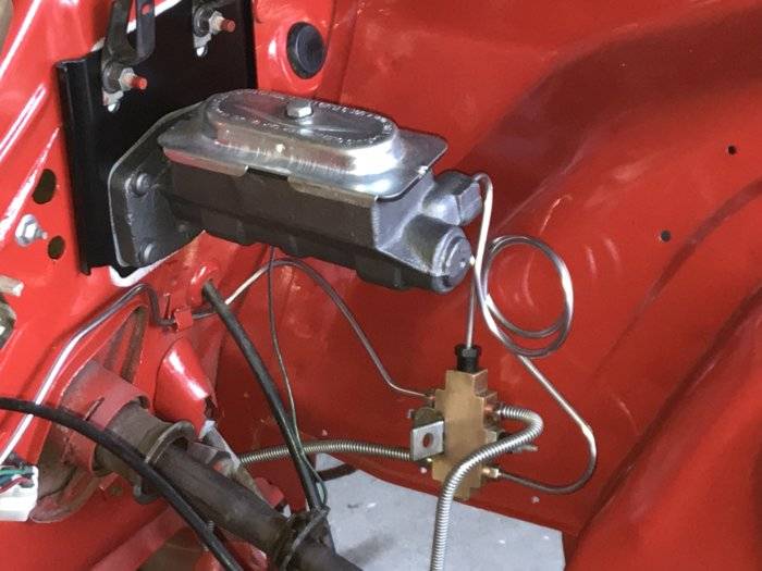

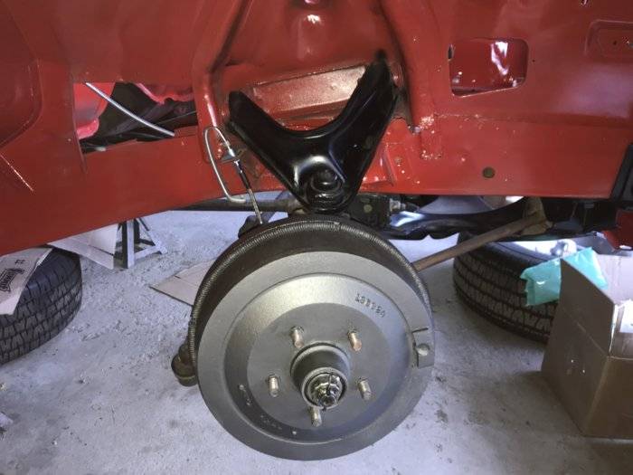

Picked up the proper rear shoes on Monday and got them on. Brakes are finally done. Went with in-line tubes stainless hard lines and the braided flex lines.

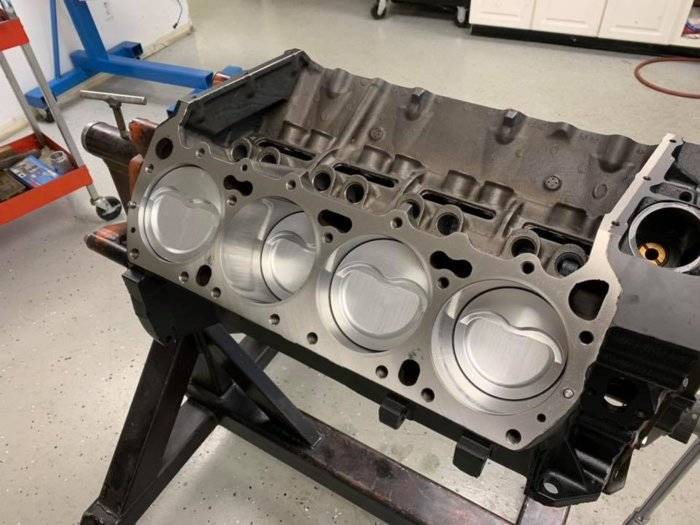

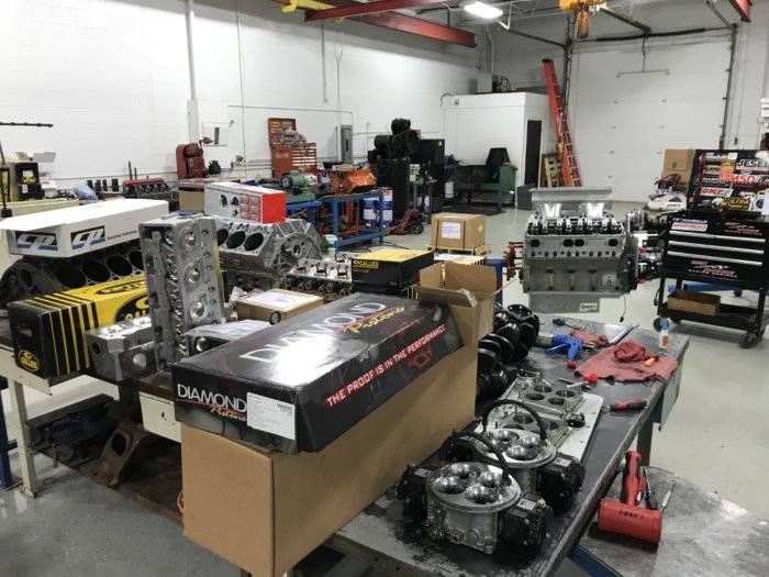

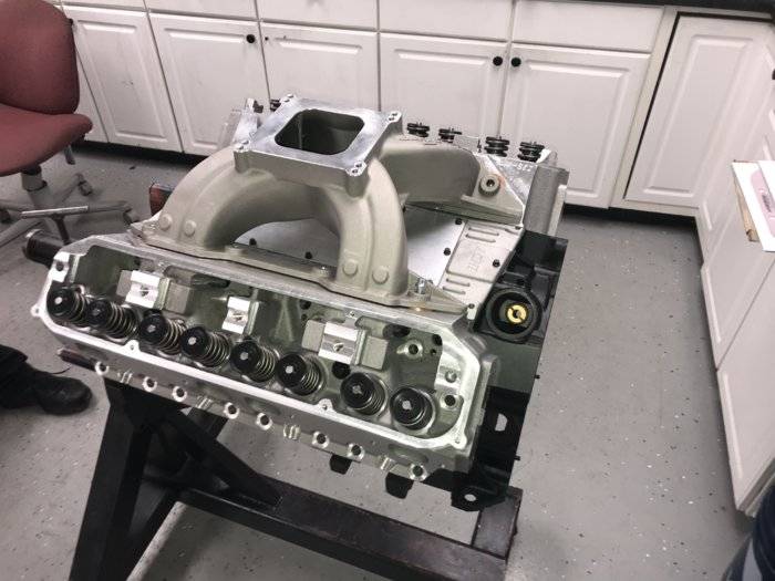

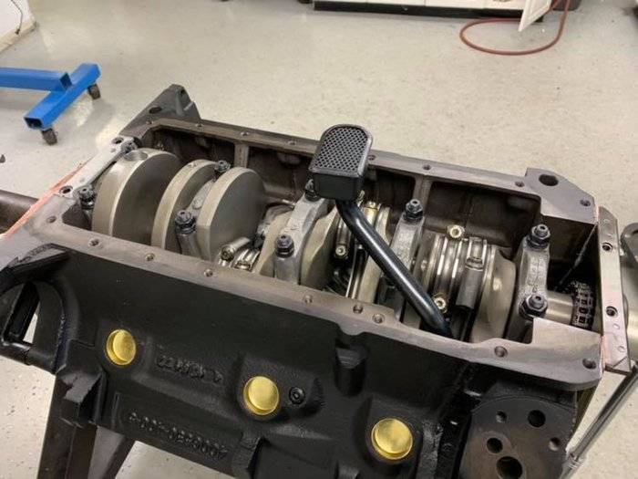

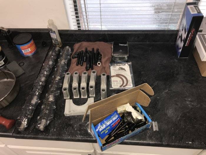

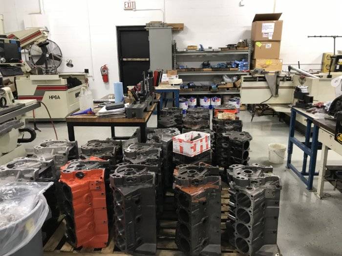

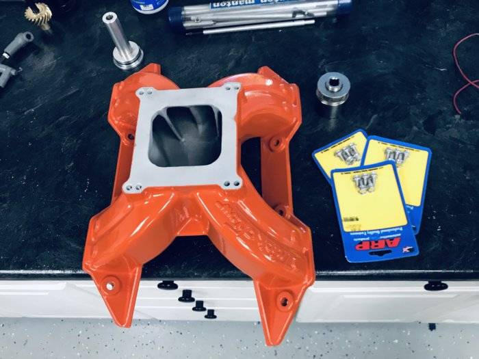

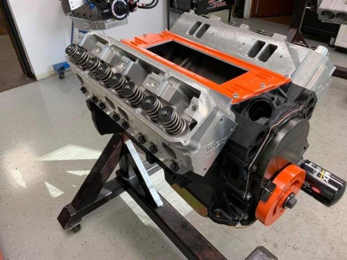

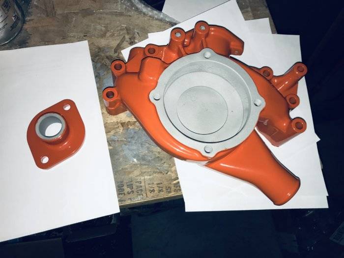

Picked up the engine bits I had powder coated this week. Then dropped them off at the engine builder/machine shop.
Nothing like heading down to the engine builder and seeing all the projects they have and seeing your engine you have dreamed off coming to life. I’m using Best Machine as they are local to me and have a reputation second to none. Pete and Chuck have been great to work with. My motor before I coated the intake. They are getting real close to making some noise.
The next 3-4 weeks should see the car come around and wrapping up many projects.
Here’s some latest engine shots

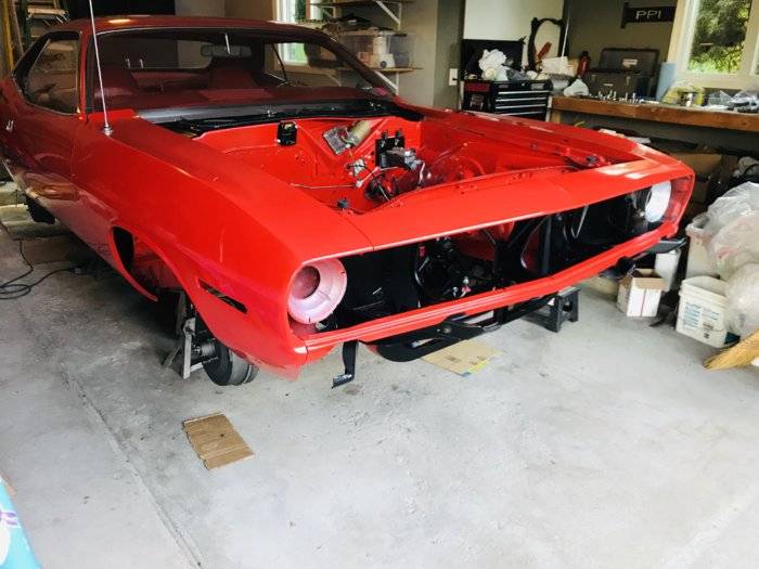

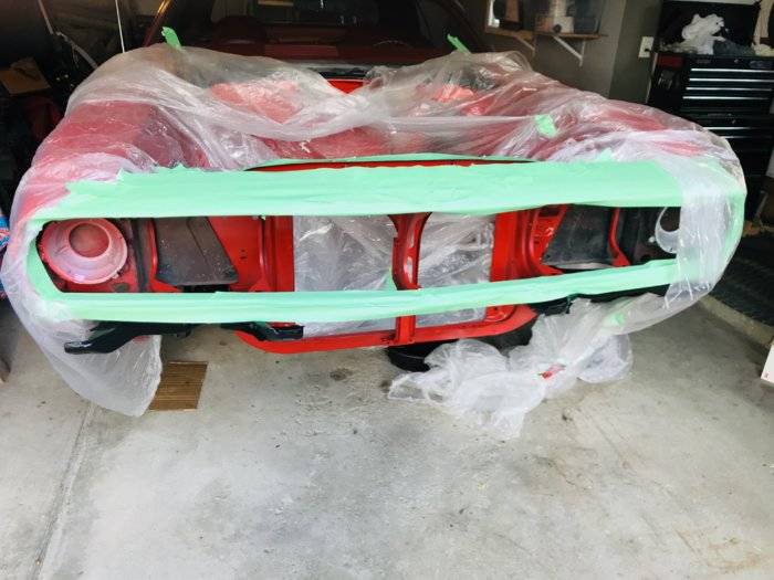

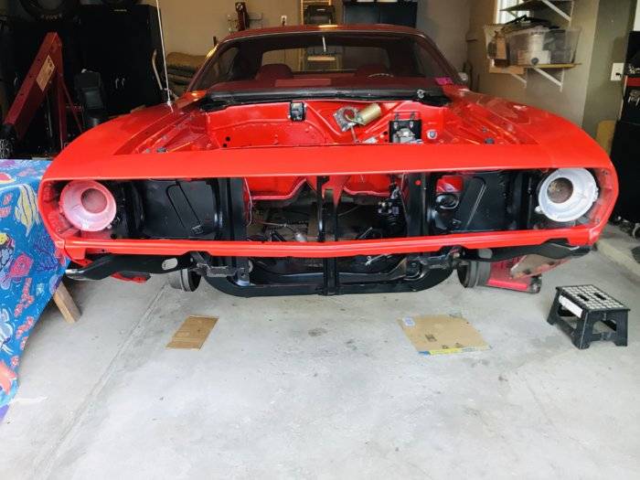

Had a productive weekend and was able to start putting the front end back on the car. Nice to see it look like a car again and not the never ending project of doom.
Monday I blacked out the front end.

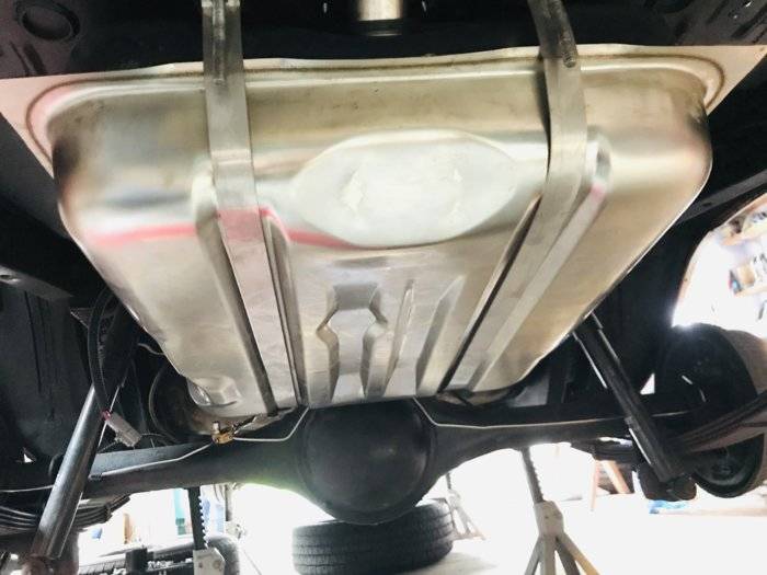

New stainless tank, straps, filler neck and cap with an electric in tank pump. Still have some plumb and wire it.

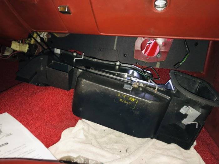

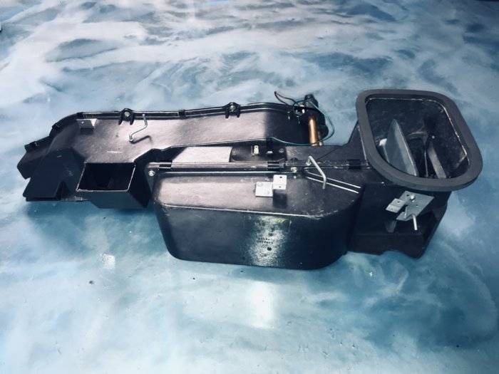

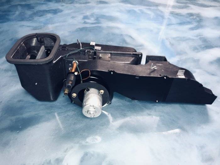

Had been avoiding the monster in the corner (heater box) assembled it and thought I was going to be able to install it but the defroster cable was kinked and needs to be replaced. Luckily they are reproduced. Also noticed the car doesn’t have the fresh air cables. Will order those too.
