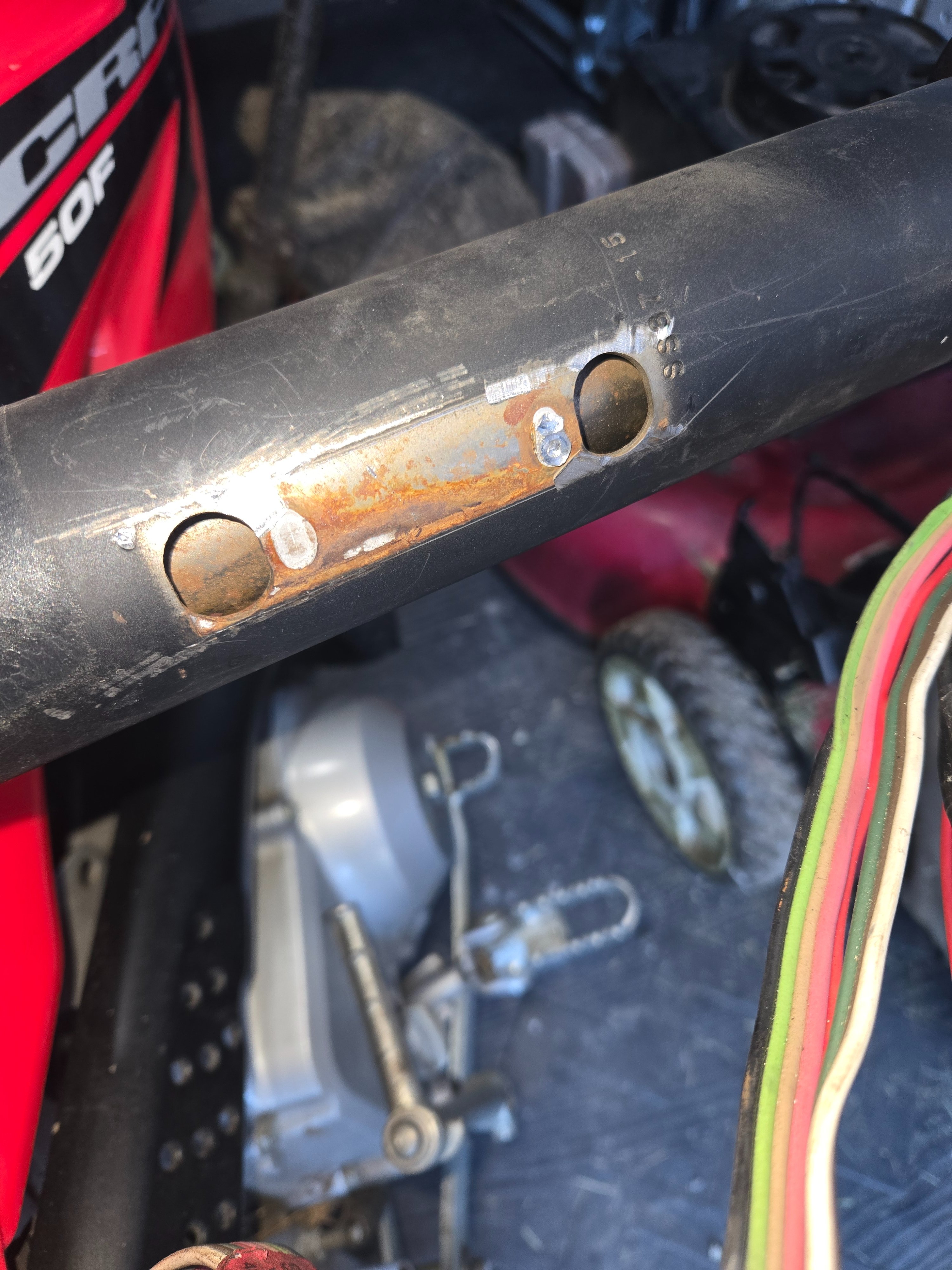

I purchased a universal tilt from ididit because I didn't want the key in the ignition as I'm going push button start. I removed the threaded plates from the factory column and will weld them to the tilt column so I can use the factory mounting bracket.
