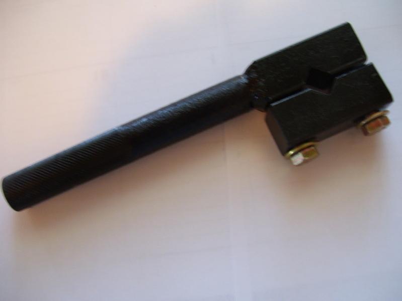

I make the torsion bar removal tool , they are made from 1"X 1" solid steel with a knurled handle $39.99 plus ship They are available at www.custommachinecomponents.com or 843-324-3586 M-F 8-5 EST Thanks
