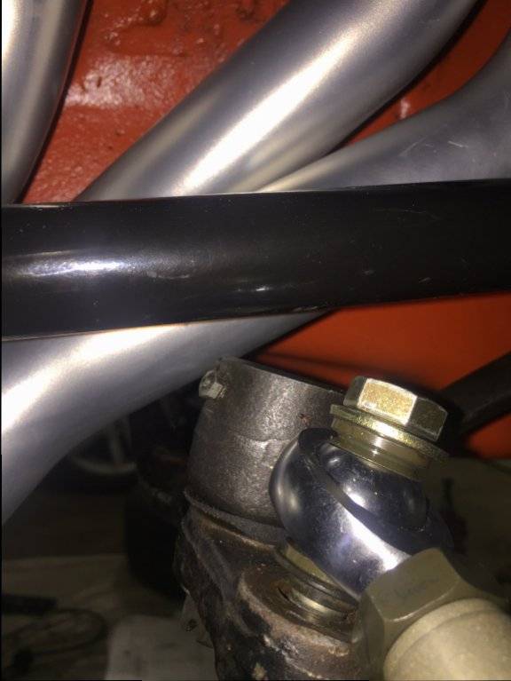

Didn't have to remove the steering, lots a wiggling, but its in. But now the idler arm hits the header. I need a 1/4 to 1/2 inch more clearance. This just keeps getting more painful. I don't have the clearance to raise the engine. Is there a idler arm that is not so big? See picture attached.
Do you have fast ratio arms?
If you do, changing to standard arms will cure your problem.
cudaclive
Jan 26, 2015
17
I do have fast ratio arms. I will switch out, thanks. If the angle of the arms were slightly changed they would fit perfectly. Can't see that making any difference on how the car handles. Maybe TTi should make the new quick ratio arms, I would buy them.

I installed a Moog idler arm and it was slightly shorter, so now it clears the header, with an eighth of an inch to spare. I still have the quick ratio pitman arm. Is the idler arm quick ratio? It doesn't say and the parts guy didn't have that info either. Would it make a difference if it wasn't? As long as it gets aligned it should be okay, am I wrong on this?

I was always under the assumption that you needed to run both the idler and pitman arms the same. Either both fast ratio or both not.
Maybe someone with more experience can chime in.

Didn't the TA and AAR have a quick ratio pitman arm and standard idler arm when new? I did see a video where some guy's dynoed an engine with headers then beat the header tubes with hammers then run it again and there was virtually no loss so they really belted them up with sledge hammers for a small loss and basically had to near collapse the tubes before a big loss happened so maybe a dent for clearance?
