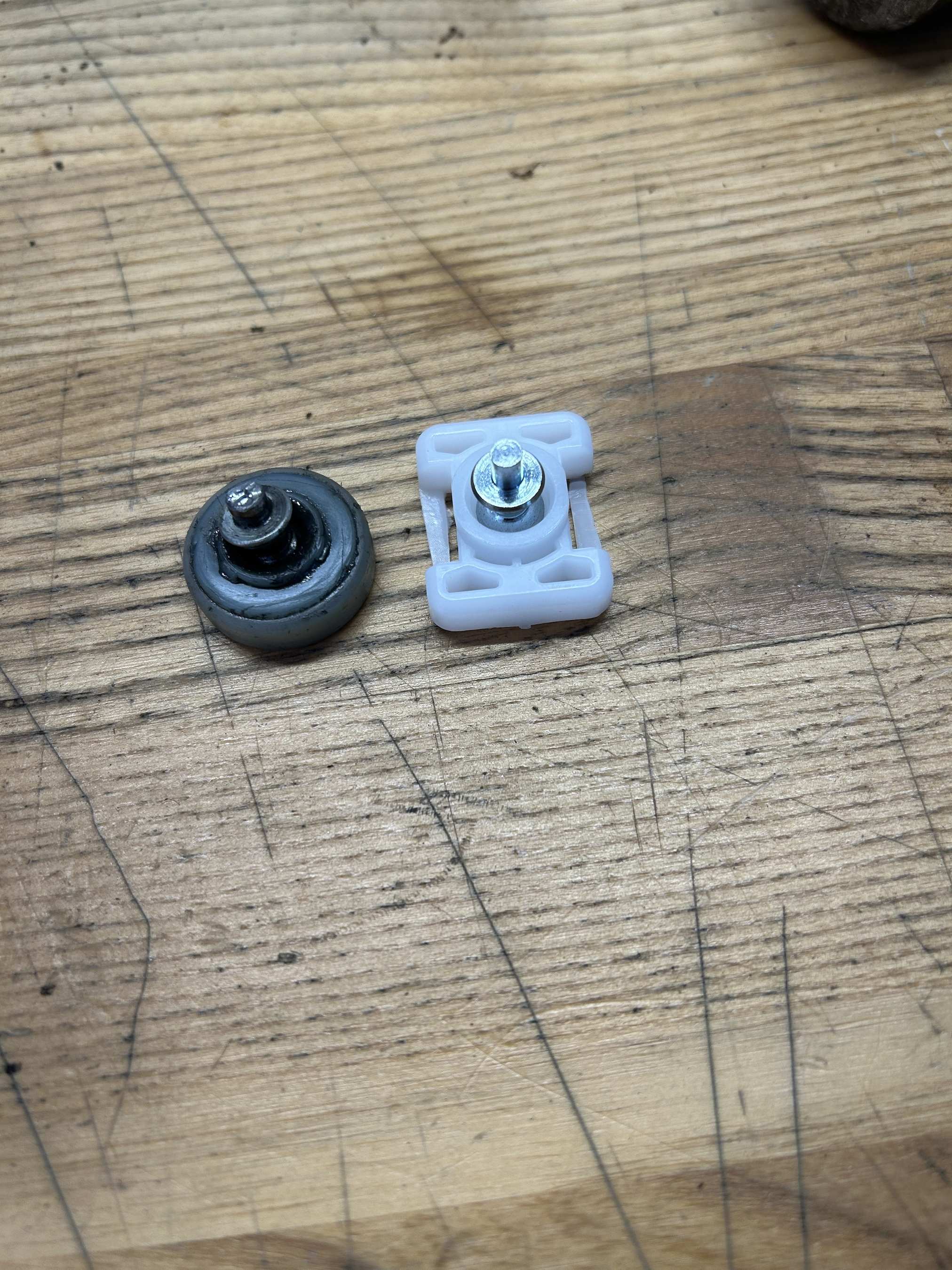

I found the problem....the plastic (or whatever) roller that goes back on forth on the scissor arms fell off. I've ordered a rebuild kit and now just have to figure out how to get the window out. I'm sure it will be a pain.

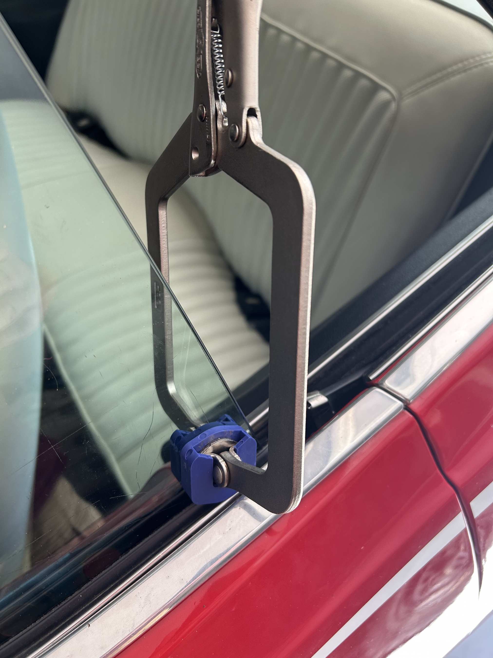

You can remove (and repair) then reinstall the window regulator (scissor arms) without removing the glass itself. Use duct tape to hold the window glass up once the regulator is removed. My arms ache just thinking about it!

Well, I finally got the right part. After two window kits (73-74) and (70-72) I realized even though there are rollers for the lift channel, the parts I needed were in the 70-72 kit I received today and were "sliders" as opposed to "rollers". I post this only to maybe help someone in the future. I had to cut the post with a Dremel, then peaned the replacement part. I only had one end bad, but am going to replace both on this side of door.
Well, I didn't use duct tape to hold the glass up, but I do have these handy vise grips from Lowe's with rubber feet.
The "roller" was the remaining one I removed from the driver's door. The rectangular "slider" is what I installed from the 70-72 kit. I cut the old one off with a Dremel and peened the new one on with a BFH. It worked and no one else in my lifetime will ever look inside the door. Not sure what year the driver's door is, as it has old blue overspray under the door panel. There are tell tale signs my car was hit on the left side at some point....
