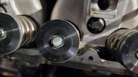

New build on a 440 stroker. a lot of clattering so I pulled the valve cover and found some of the roller rockers were loose and found a collapsed
lifter. The valve tip on this valve has small ridges on it. Is this normal. Do I need to replace the valve?

I assume it has low miles on it , it would seem to be sloppy finishing polish on the valve tip , I would take a fine file & smooth it out Or better yet why are you not using lash caps with adjustable rockers , then the roller tip has a smooth hard surface & larger area to roll on , they are only about $40 for a set , I use them in every build with adjustable rockers . No need to replace the valve , it will be fine .

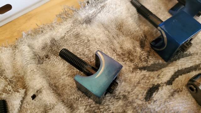

Doesn't have a 50 miles on it. Builder refuses to look at it. Said don't bring it back. I took it to coastal customs & restoration in Freeport fl. He puts the car together and at the very end sells the business to another guy keeps my car and finishes and then tells me good by and don't bring it back. Multiple issues with wiring, poor grounds, overloaded electrical system. Overheating problems, radiator overflowing from the cap. Just a host of crap. So valves clattering like hell and I pull the valve cover and lifters were loose and one lifter collapsed. Same one as this valve tip. It's my problem now so I got to figure it out. What are lash caps. I started this under a different post about the lifters. It has roller rockers and some wear is showing on them. added picture. What are lash caps.

Yes , they just sit on the valve tip .
you shold have a thin metal shim between the rocker & the hold down to prevent the wear there ,

No need to file the valve tip once the lash cap is on to protect it .

It sounds like the builder was relatively clueless about engine work, as many custom shops are. While they build beautiful cars they often just bolt things together when it comes to engines and didn’t adjust the rockers correctly – which would explain clattering.
I would at a minimum pull the heads and check some things. Is the pushrod from that cylinder bent? That would tell a lot. A collapsed lifter could be the result of a bad lifter, but more likely caused by any number of interference issues. Check retainer to guide clearance, valve spring stack height, look for signs of piston/valve collision, and check valve guides for too little clearance – a problem some aftermarket heads are notorious for.
I’ve never seen a valve tip worn like that before without there being actual breakage of a rocker or roller tip. It could just be poor quality control on the valve finish, and lash caps would preclude replacing the valve. Also, what brand are the roller rockers? The cheap Chinese ones look great until you start to run them…. Then they fall apart and destroy your engine.

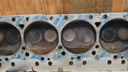

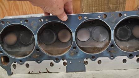

Cam looks fine and checked all the valve heights they are in line with each other. I pulled one of the heads to just make sure it had the stroker kit in it. It does. Anyway I am looking at the head gasket and there are two water jackets blocked by the head gasket. Also three at the bottom are restricted with a slot cut in the gasket. Is this correct?

It's the triangluar shape between the clynders and below the cylinders. You can see the horizontal cut in the gasket that lines up with the bottom water jackets.
