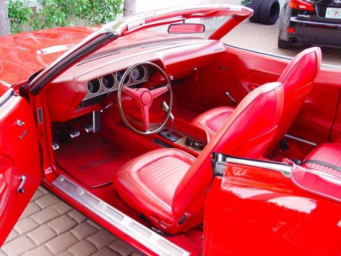

This Cuda belongs to Ola Nilsson (Cudaized). It is a factory correct red interior car. The steering column is red because it has a Rallye dash . The standard dash will have a black steering column.

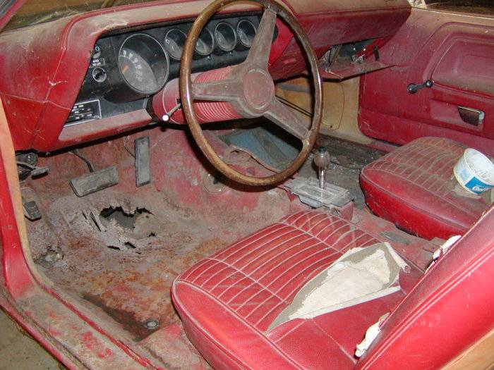

This is an original '70 Challenger convert, right after it was pulled from a barn. It has the standard dash with a red column. It may be possible that the standard dash came black with the column shift and the console shift ones had the matching color column.
