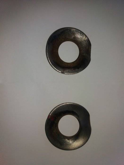

    Pretty certain these two "wrinkled washers with a definite flat spot are from the front suspension somewhere - but where? They are identical, Special washers.jpg so meant to be this way

    Hi, this is the strut rod retainer. In order, 1st the pin; 2nd the nut; 3rd the retainer; 4th the sleeve; 5th the 2 bushings; and 6th the other retainer. One of the retainers has a smaller hole than the other. The picture above is just for one side.

    What is the ID and OD of those washers? I don't think they are for the strut rods. Strut rod washers are heavy thick washers. Those look like the washers for the rear lower shock end mounting bolts.

    Rear Shocks or depending on size torsion bar link washers that go under the rubber

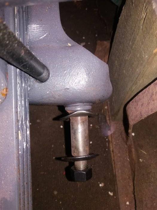

    Thanks for all help. ID=0.7" OD=1.5". I have the strut retainers which are bigger. They seem to fit snugly on the axle end of the lower rear shock mount - I have the other ends which is a smaller ID. Not sure why they're the shape they are? Rear shock lower mount.jpg

    They got bent when someone was trying to jack up the car.

    never seen a washer on the shock stud.
