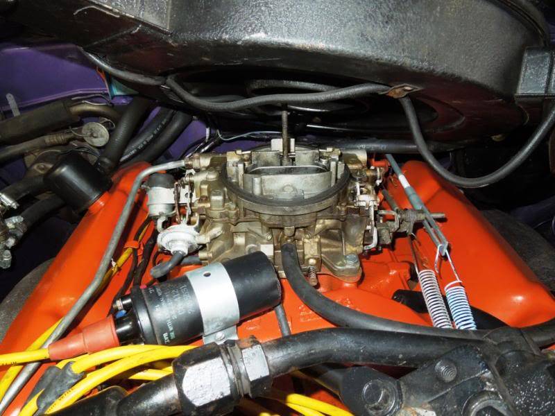

F9 4615 S..... Looks to be on the front base
There is a tag also... It says 4615 S Has 1759 below that and then a big 77 on the tag to the right .
My car was built in 69 as an early 70... So it may or may not be right .... Some sites say the 4615 is for a manual car, but mine has all the hookups for an automatic.

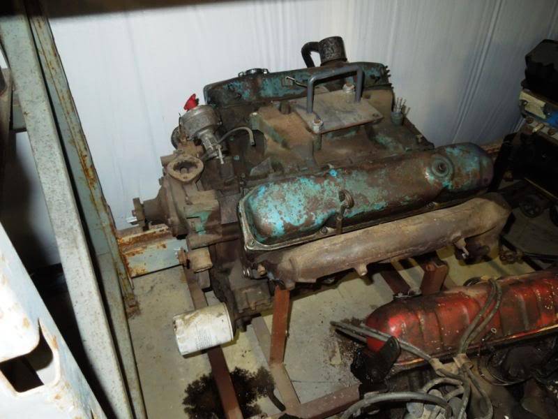

The engine in it is a 69 Charger 440 HP. I got the original 383 when I purchased the car. I am getting ready to send it out to get rebuilt.
Carb...

The 440 Has a complete VIN stamped on the side of it...
XS23L9B243290 or it could be an XS29L9B... that 4th digit is really hard to make out.
Shows to be a 1969 Dodge Charger Special L - V8 440 CID 1-4BBL "RB" (High Performance), built in Hamtrack Michigan. Pretty Cool (I guess)
