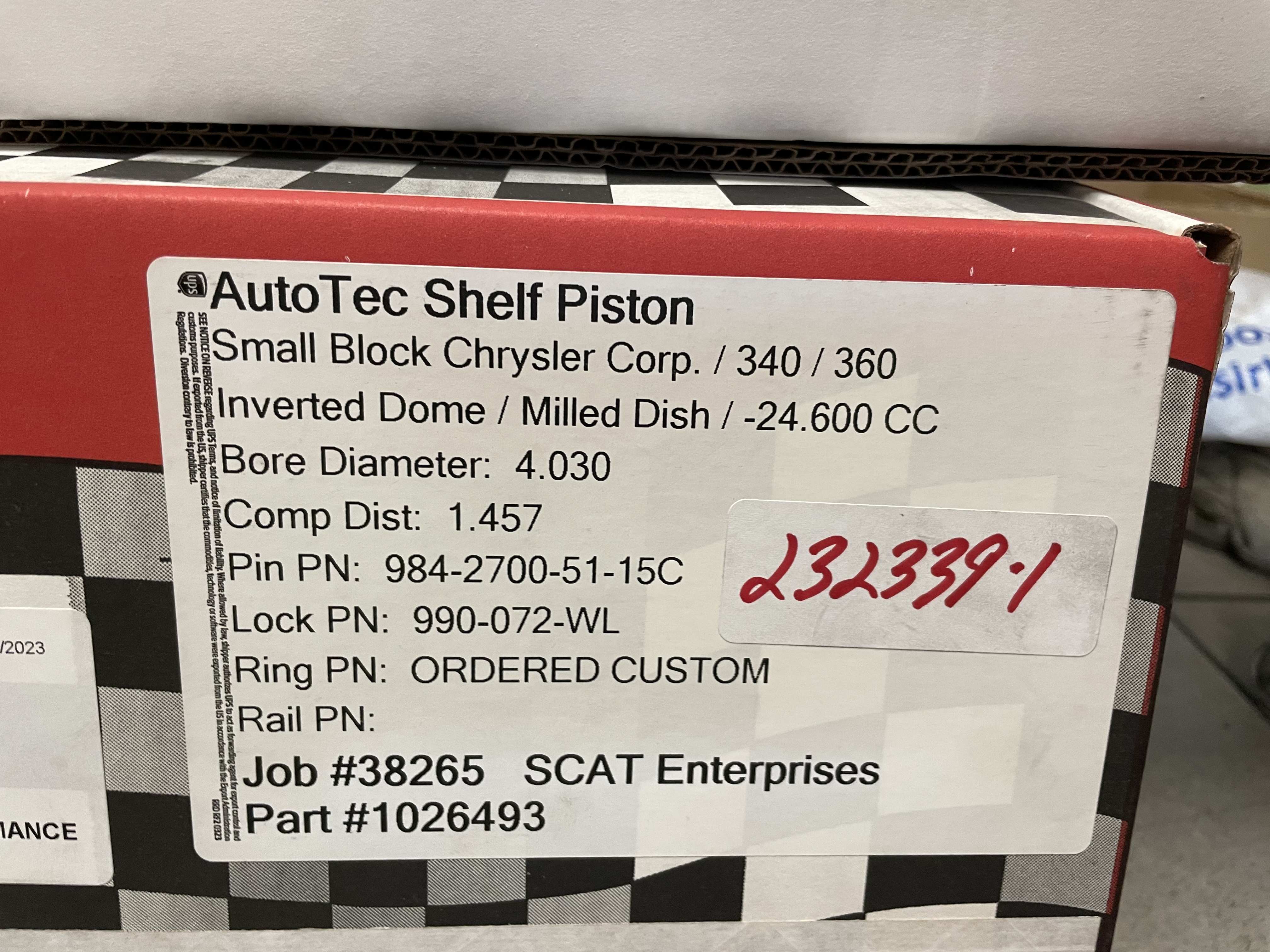

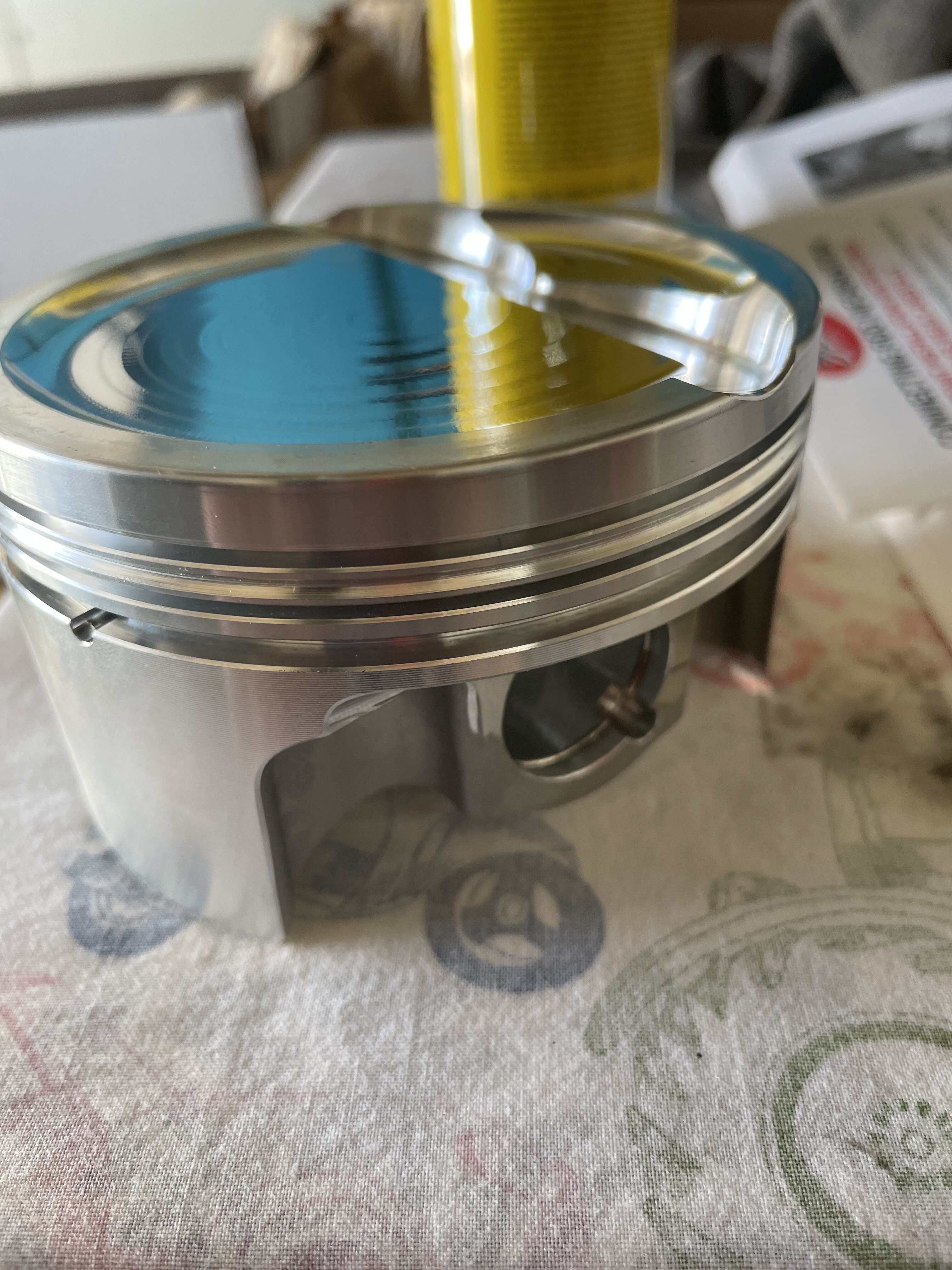

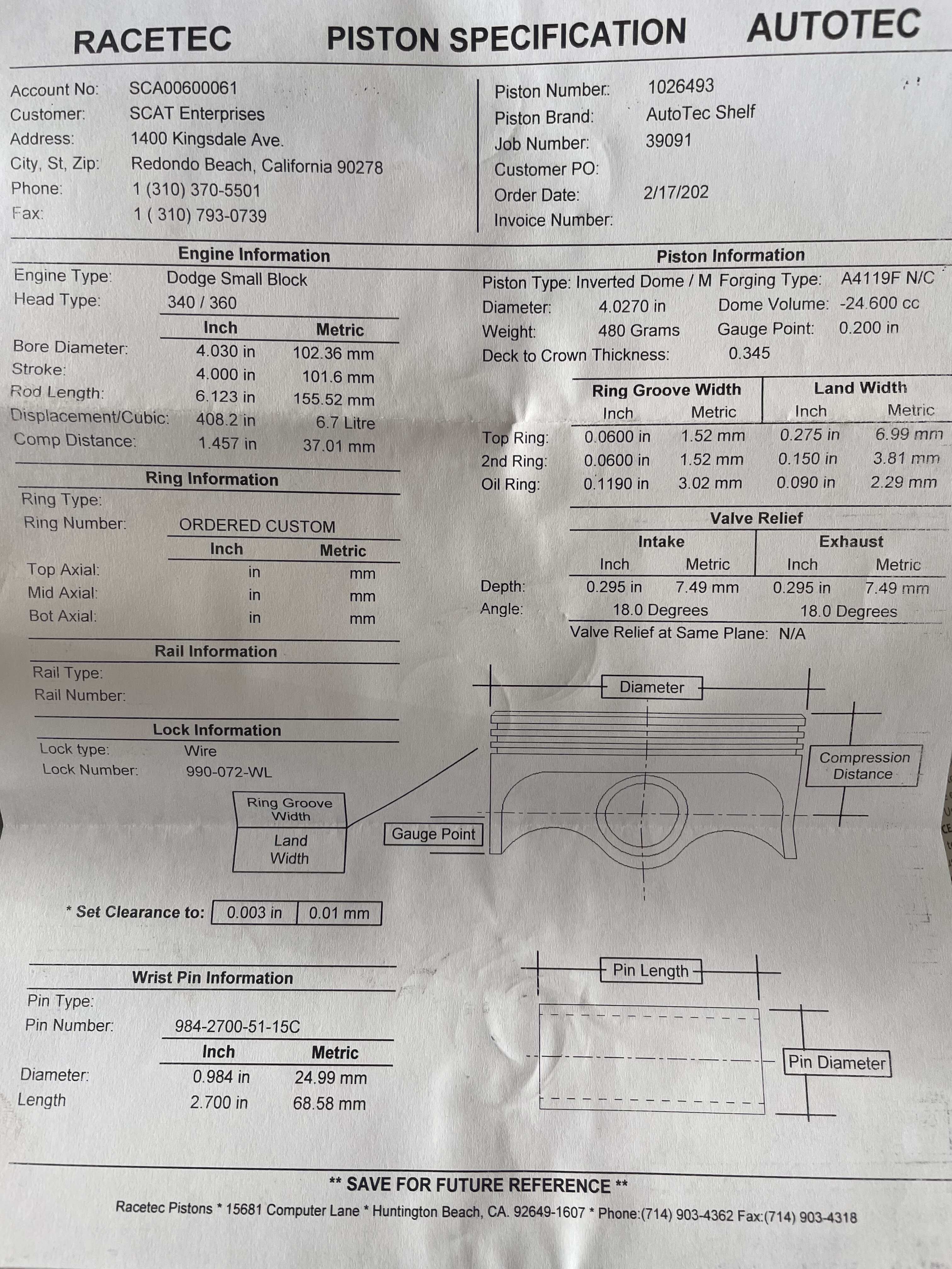

I am building a 408 stroker and got the kit for 4.030” bore from Scat. They supplied Autotec 4032 alloy 1024693 pistons (will be 9:1 static comp with my block 596 heads) and a ring package an4030. I measured the rings in the bores and both top and bottom ring gap are 0.026” which seems large. No where I can find the recommended ring gap in the paperwork or on the net I will call them Monday but wondered if anyone has experience with these pistons as I was hoping to get the bottom end done this weekend ?
