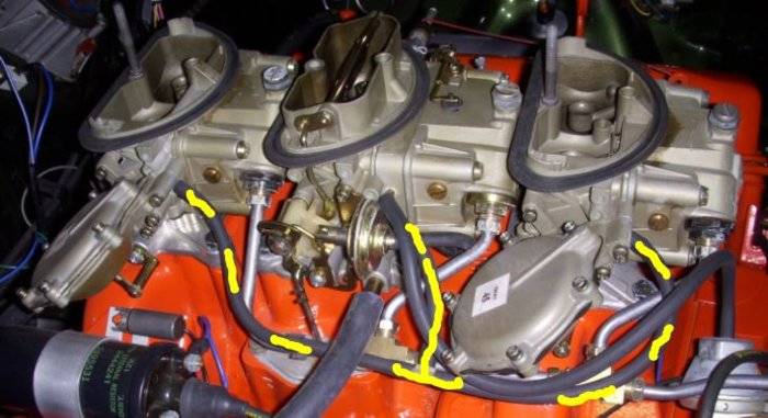

First, I know very little, so a hi tech answer will be over my head. I notice that the secondaries are linked to a cam by the main throttle. When I move it back and forth, the secondary linkages do not move. I see that there appear to be vacuum devices on the other side of the shafts on the secondaries. It looks like those diaphragms would cause the secondaries to open, as the other connection via linkage to the main throttle seems passive.
If I crank the car and accelerate by manipulating the main throttle by hand at the center carb, the secondaries just sit there. The linkages do not advance and open them.
I have a lot of gas coming out the exhaust. My suspicion is that the secondaries are not letting any air in.
Any ideas? Should the secondaries open when I move the main throttle linkage, or are they controlled via diaphragms on the other side? If so, what triggers the diaphragms to open the secondaries?
