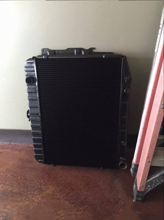

When the block froze, it also took out the radiator and heater core. Took them both to Doug at Industrial Radiator in Santa Maria, CA - he was able to find high quality replacements and reuse original reservoirs and frames. Also did the checks on the AC condenser and evaporator coils.

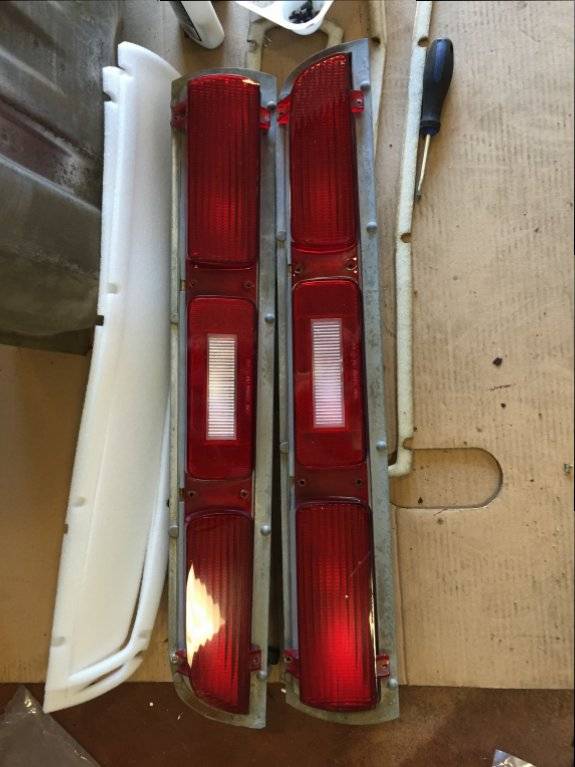

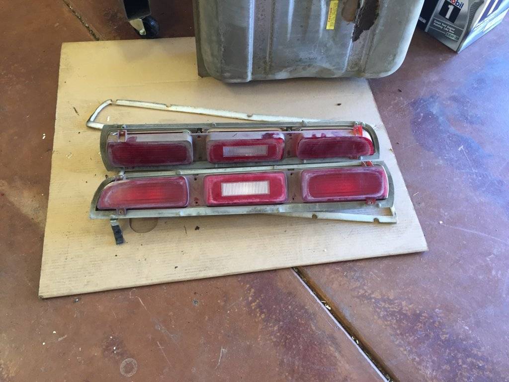

Some not so great before and after pictures of the tail lights. I used some Meguiar's Mirror Glaze No 17 Clear Plastic Cleaner with a buffing clothe to get the fine scratches out, followed by Clear Plastic Polish No. 10.
Hard to see but I thought they turned out pretty good. Cleaned the housings before reassembly.

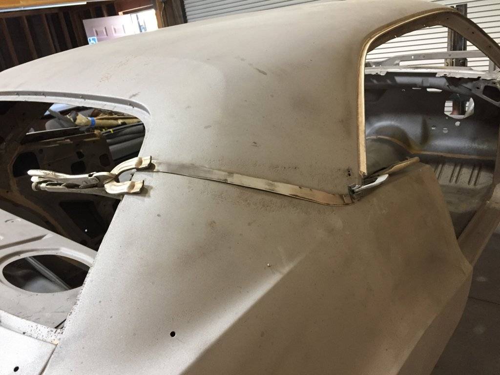

One thing I forgot to show on the body work - the seams where the roof is welded to body at the C-pillar were just plain scary looking. That was a pretty wide gap from the factory that they just filled with putty, and slapped the vinyl roof over it. You could see on my car where the putty had long cracked, and was probably the source of some of the water in the trunk. Every car I have seen that is unpainted with the vinyl roof removed shows this gap, usually in rusted and ragged condition. So we debated about what to do, and finally I asked Jesus just to weld them up. So second picture shows the fabricated metal strip used to fill the gap. Should hold up much better than the factory job did, and be invisible when completed.

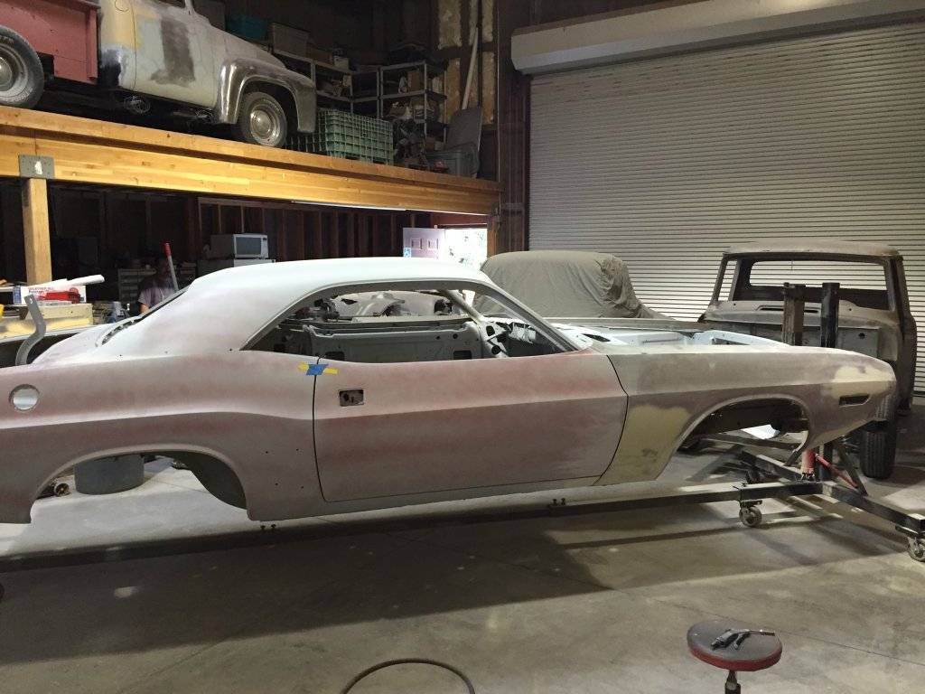

Went by the body shop on Friday, and Jesus is hanging the fenders and doors to check panel gaps. He will set it down on jack stands to get the weight distribution correct for the final check. This car had tight gaps before disassembly, and they are looking fine now, so I don't expect problems with that.

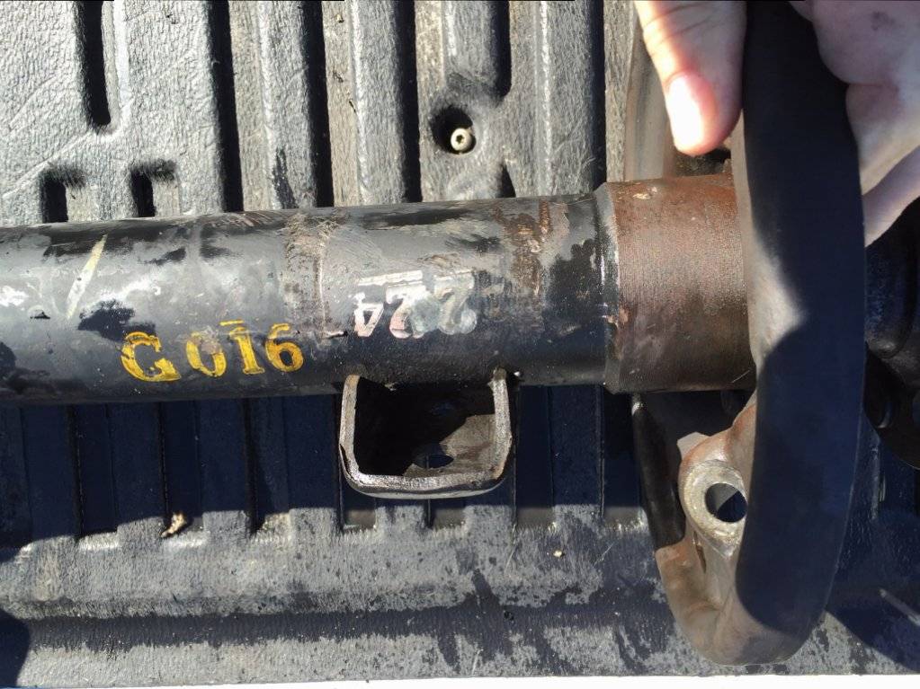

Spent Saturday scouring the local yards for door hinge bolts (for some reason cannot find one set) and the S-hook for one door hinge was missing. Found a set of hinges on a 71 Duster in Paso Robles, those will work just fine! Sunday, sanded and painted the rear axle (primed). Had hoped to just clear coat the thing to preserve the original inspection markings, but got some sort of weird reaction between the rust inhibitor and clear coat that caused the whole thing to turn white. Thankfully I have lots of pics to be able to restore the markings. Anyone know who makes the stencils for the numbers painted on the axle?

Here is a picture of the rear axle stencils I will need to duplicate - does anyone know of someone reproducing these?
