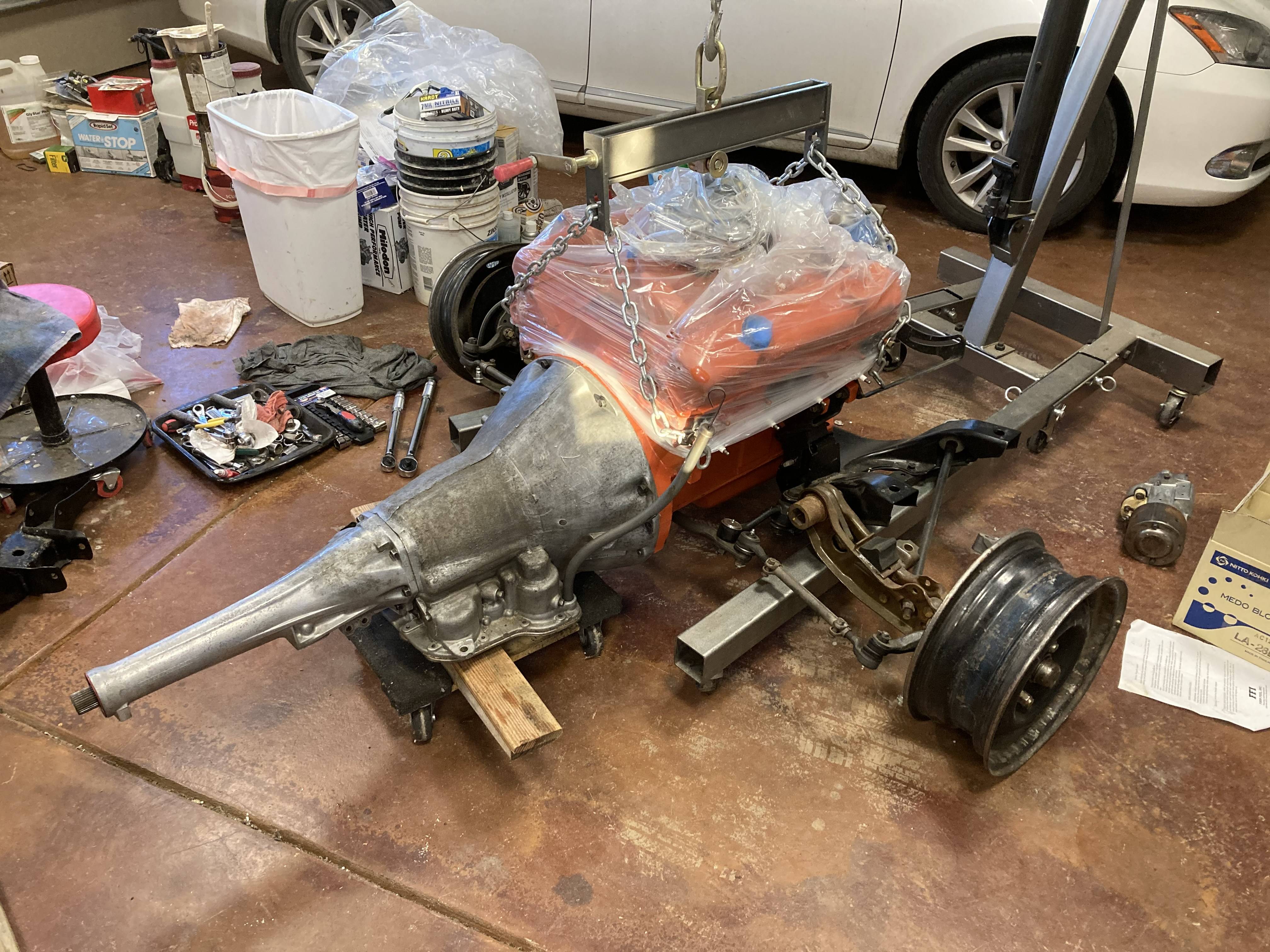

K-frame complete with engine and trans

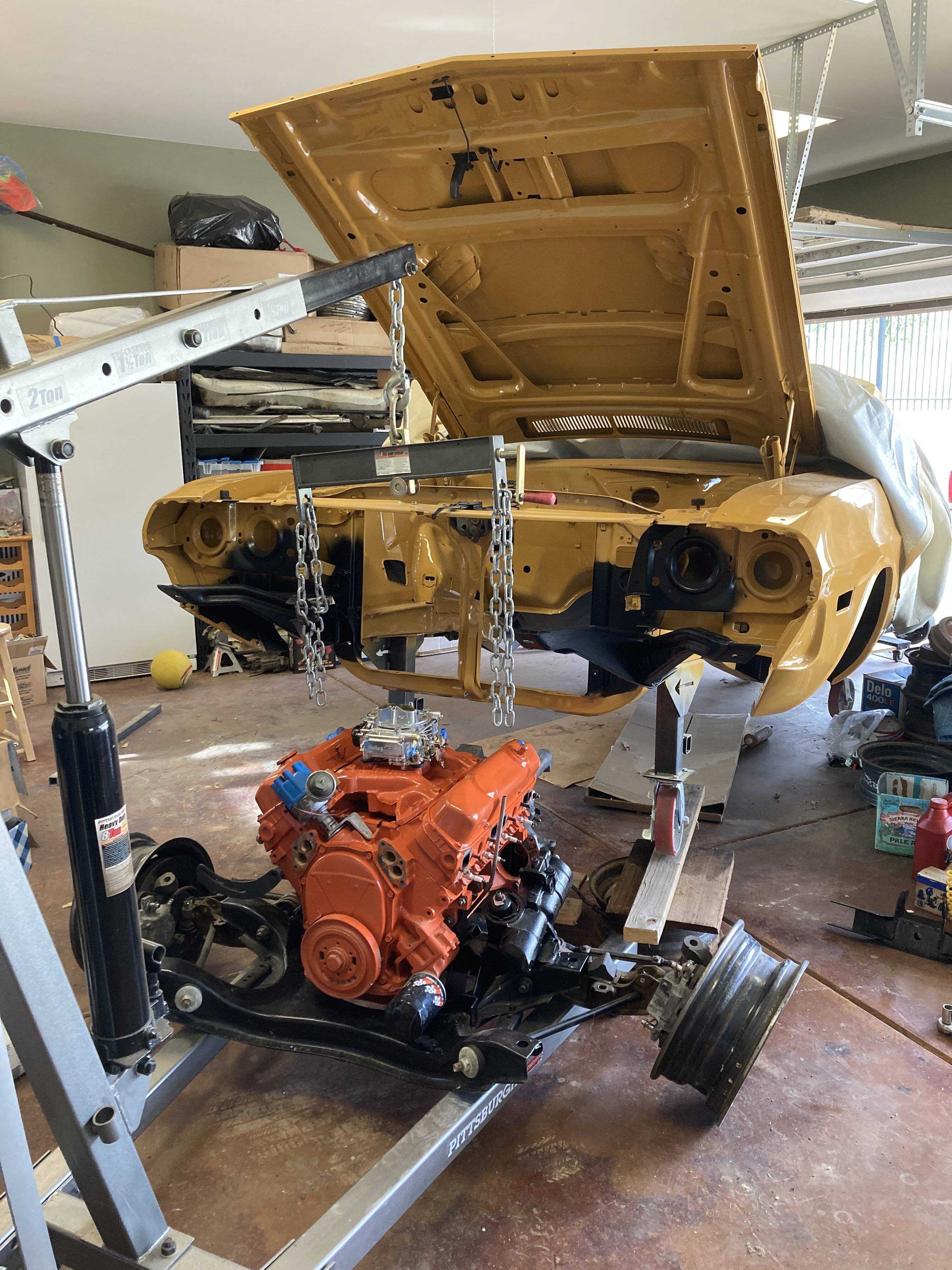

Lifting car over K-frame - one foot at a time!
It's in finally!

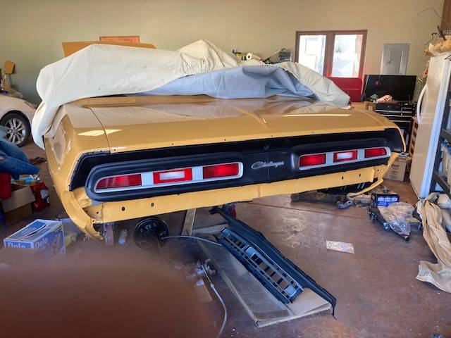

Tail Panel - I went ahead and installed lights and surround panel so they would not get damaged moving other parts around.

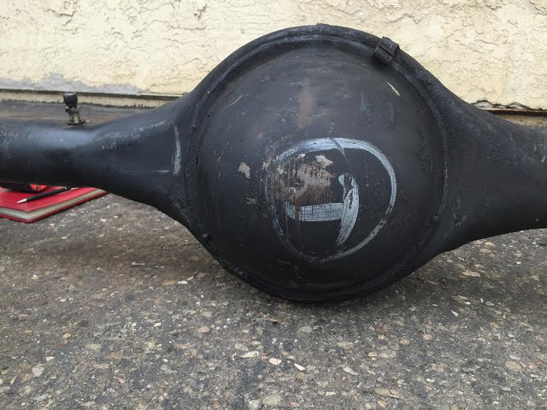

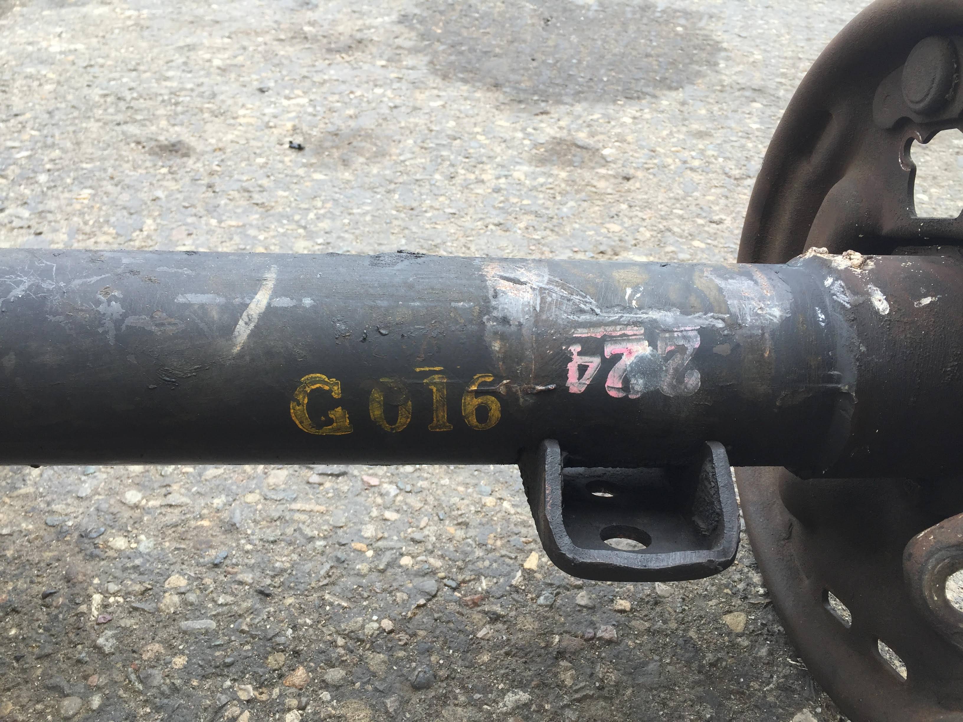

This car had a BOATLOAD of factory inspection markings - would LOVE to know what the Circle-J on the pumpkin was for - anyone know?

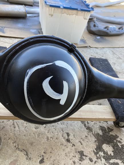

Here is the differential markings - old and new. I got a little big on the circle for the recreation, but overall pretty happy with it.

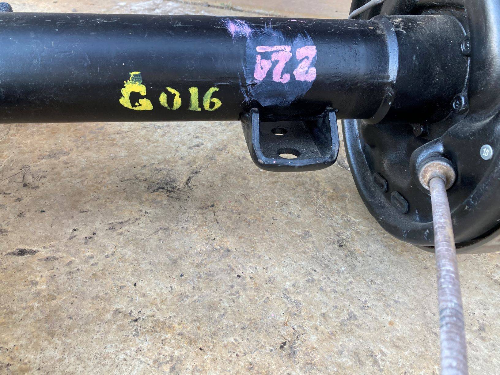

There were also two numbers stenciled onto the axle - I was able to send the photo shown to Stencil Stop (found them online) with the dimensions of the original numbers and they recreated the ragged edges from the factory where the paint bled under the stencil. I was very happy with the results. Anyone know what these numbers signify?

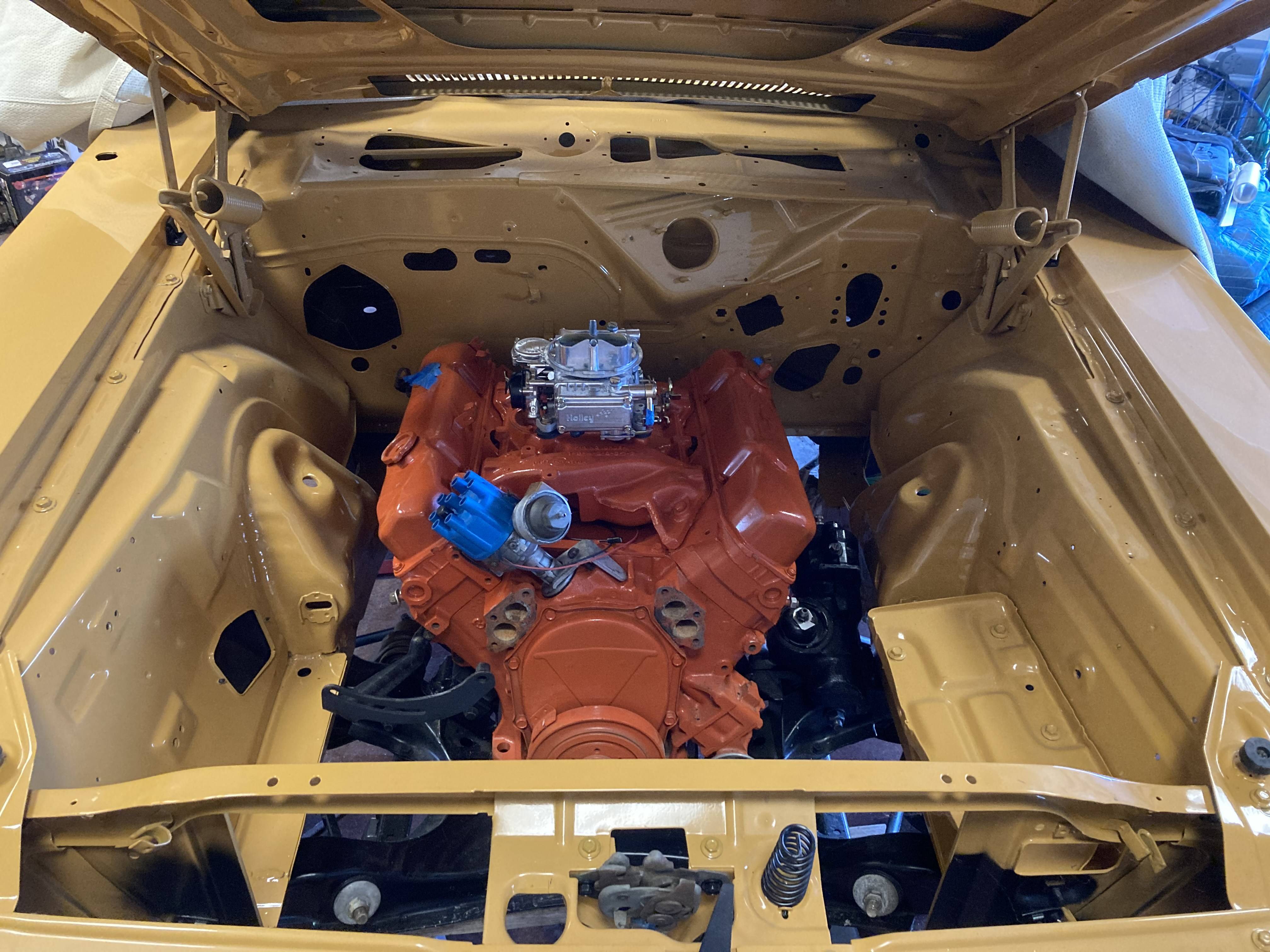

Torsion Bars installed so car is finally sitting on 4 tires again.
Air Box installed today and starting to work on the wiring harnesses. One friend suggested I replace underhood wiring with new and can reuse interior looms - they look to be in good shape but will test to make sure. Have others done the same thing?

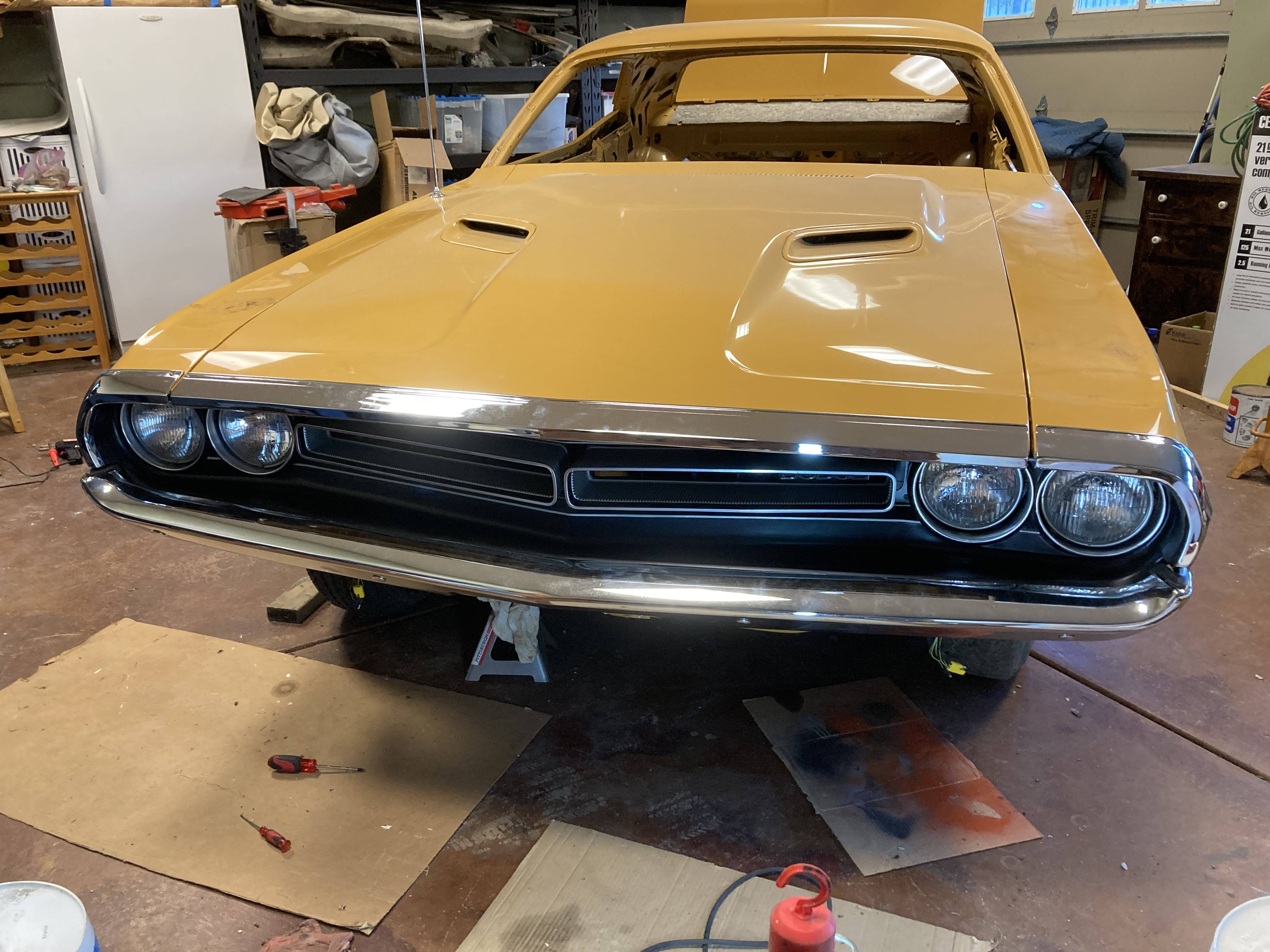

Nice work! I’m looking forward to seeing how to mount and the hardware used to install the wide chrome trim on the front..... I have an nos set to install on my 71 project and I have found no parts to install.....

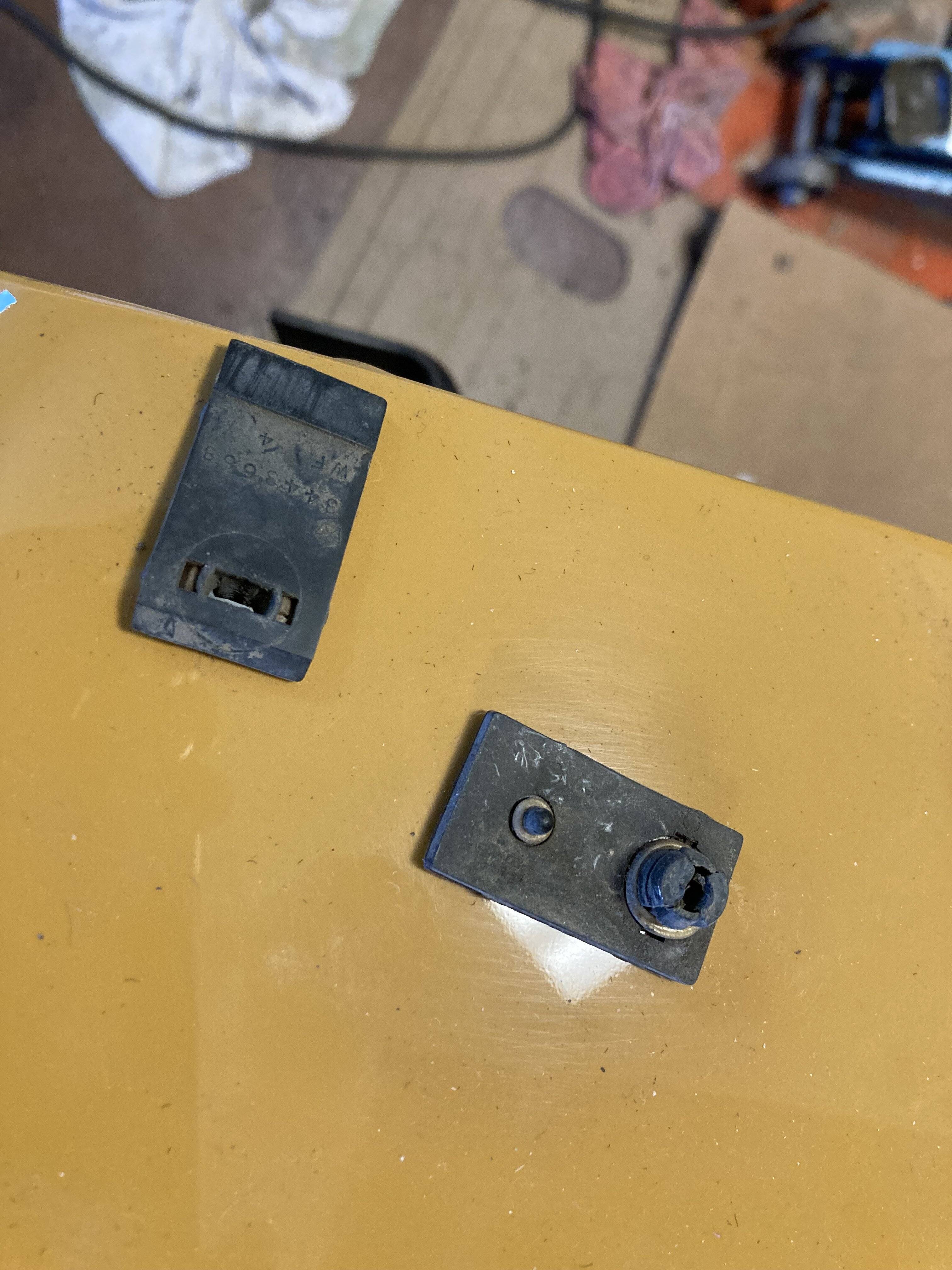

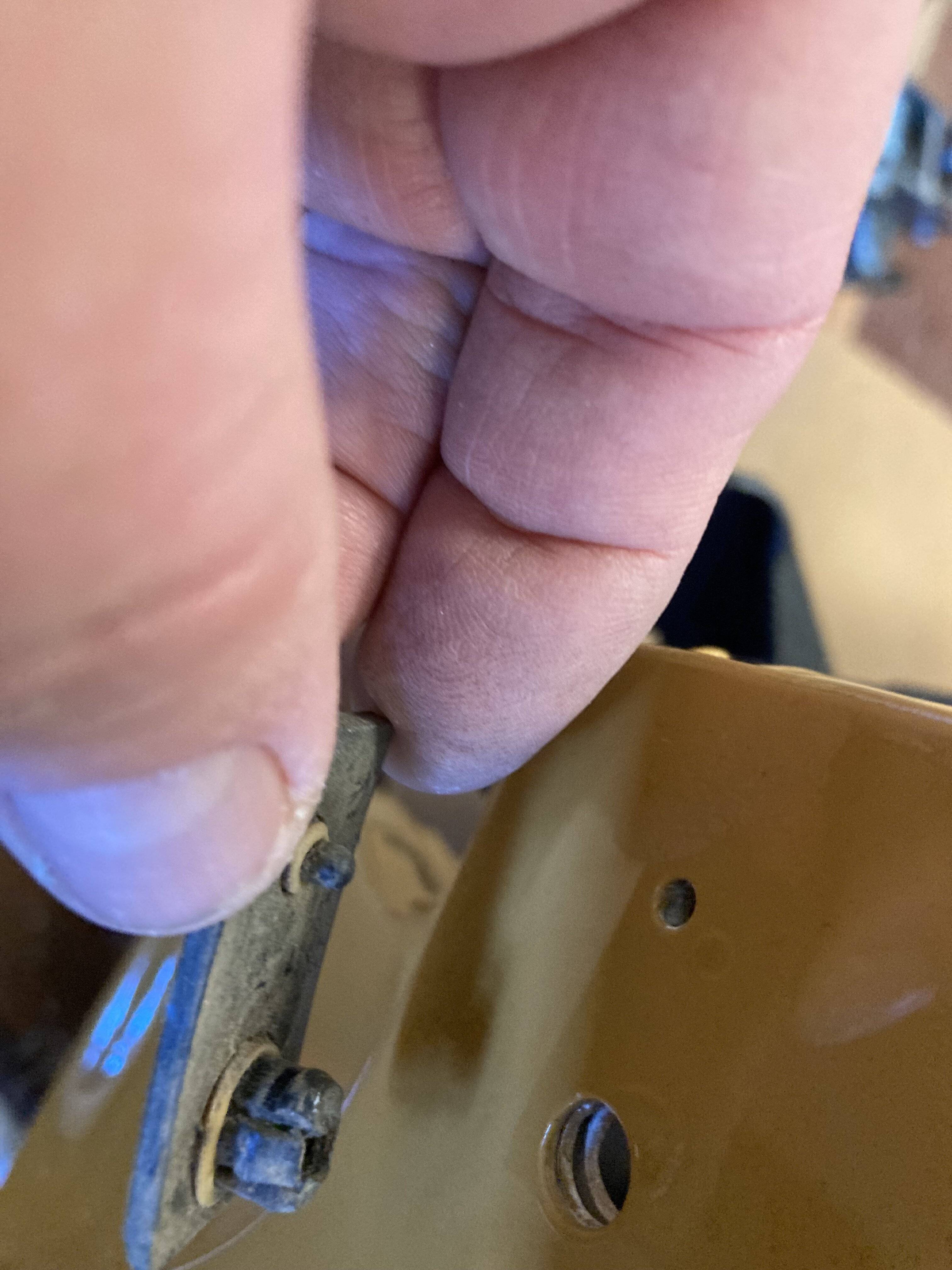

I finally got my parts together and installed them - took a couple of pictures for you. The hood trim piece simply bolts on - the leading edge bolts through the holes where the stock trim piece would bolt on, with small bolts installed from the back side. The trim piece also has studs along the rear edge that drop into holes drilled into the hood - these are cinched down with stamped nuts from underneath.
The two trim pieces on the front fenders mount differently. They do not have any screws along the front edge. Instead, you install the headlight surrounds like a stock vehicle - these include the front lip trim for the fender. There is a set of double-holes on the fender, three sets per side. Each set of holes consists of a square hole and a smaller pin-hole. You will need a set of 6 plastic inserts to install, each has a locator pin (like a trim badge) that goes into the smaller hole, and a square expansion peg that has to be tapped into the square hole. Once these 6 plastic pieces are tapped into place, the trim pieces can be installed. They essentially "cup" the headlight bezel on the leading edge, then you install 6 beveled screws through holes in the trim piece - these bolt through the square plastic pegs, expanding them outward to lock it all in place (like the plastic pegs you often see on screws for your license plate).
I have included a couple of pictures of the plastic pieces here and a snap of the finished install, let me know if you need other shots.

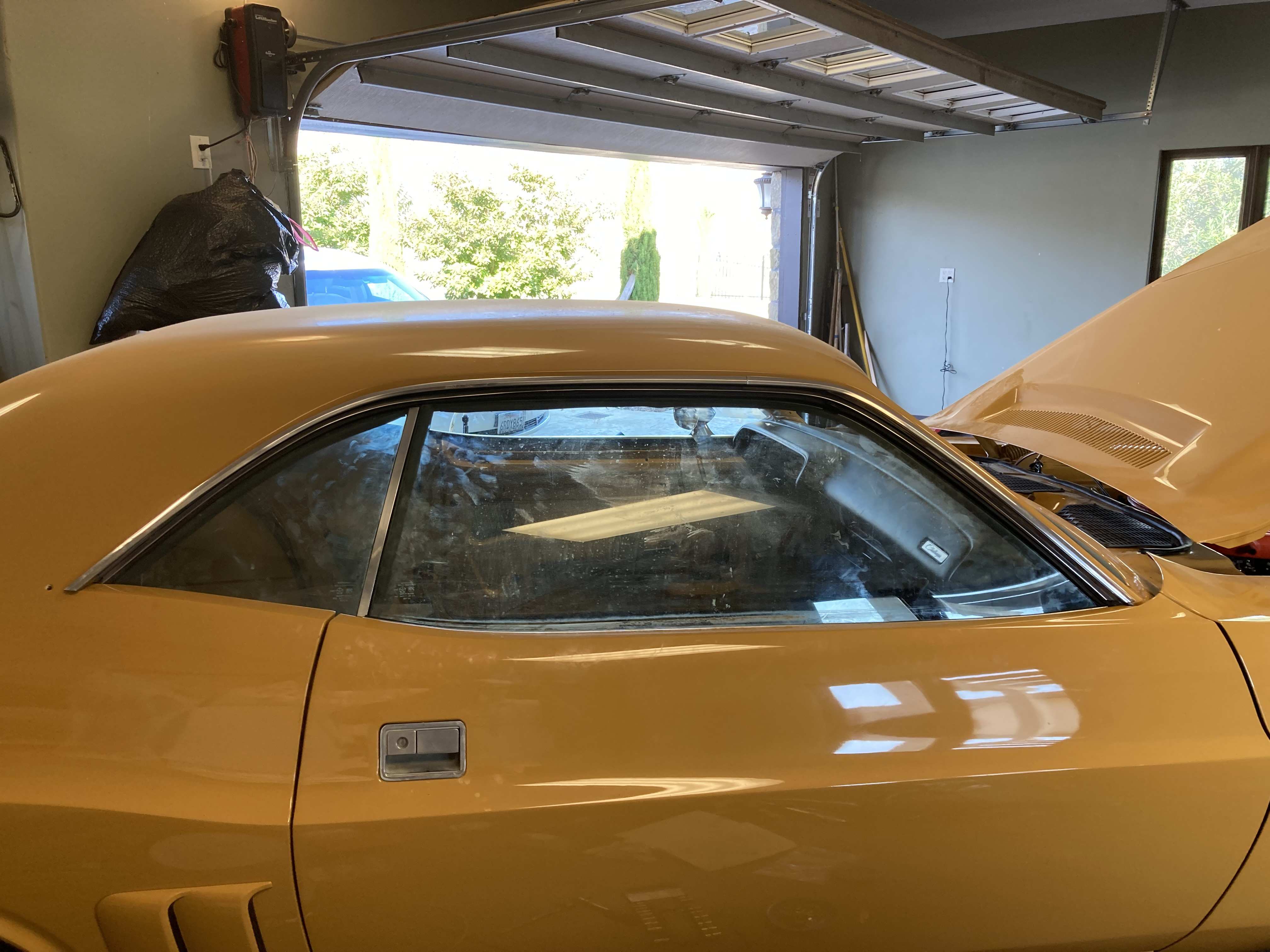

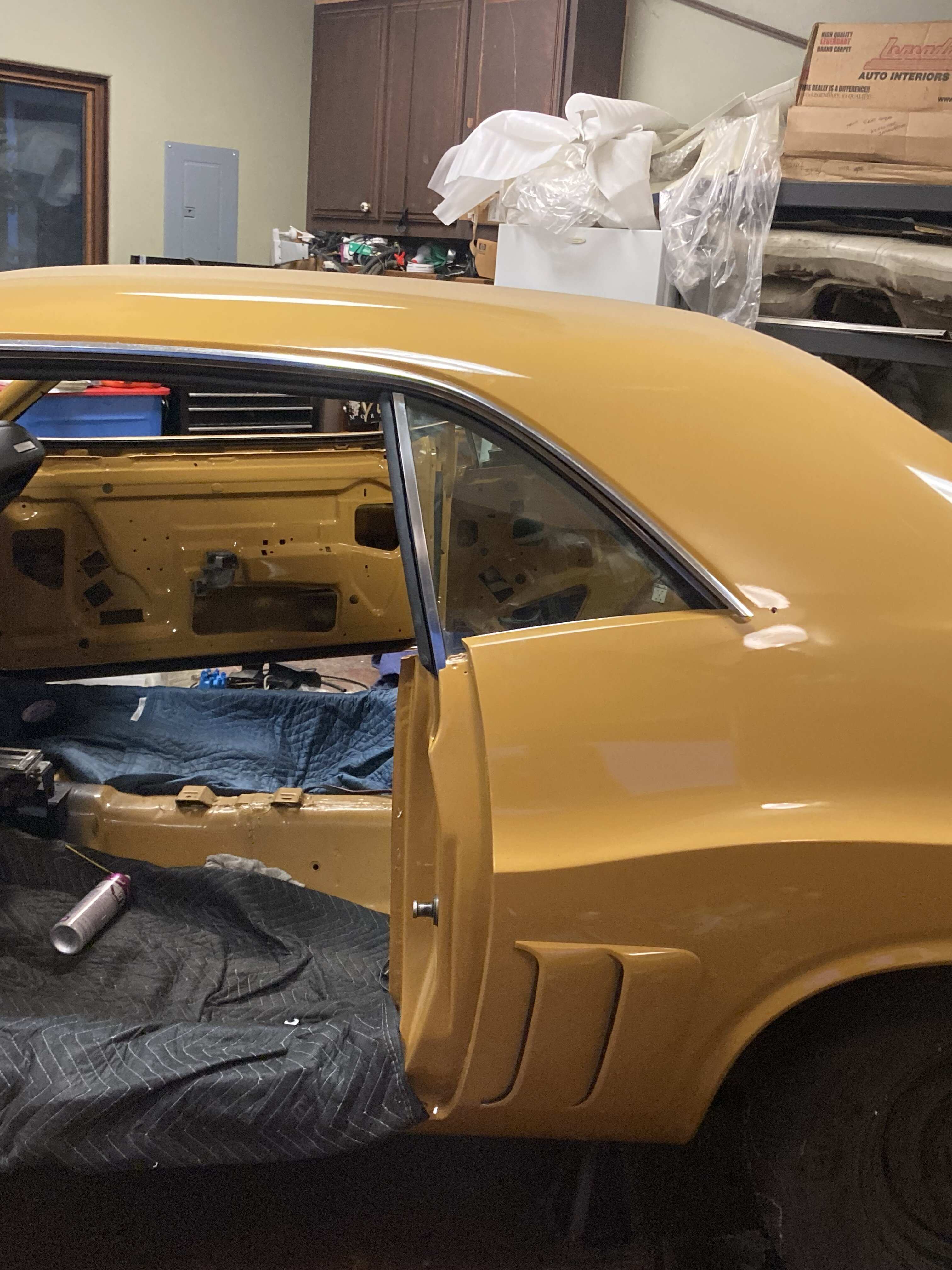

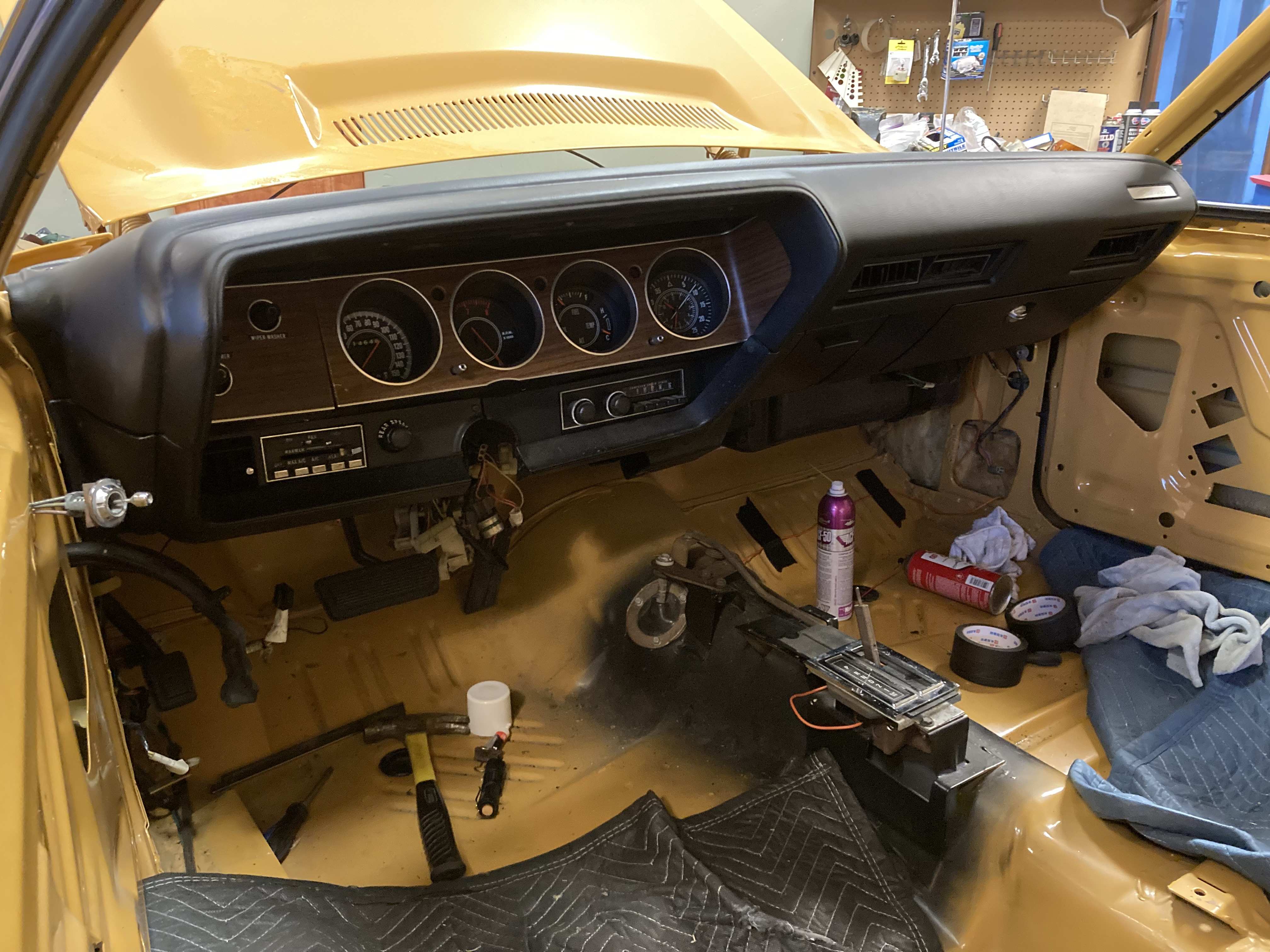

It has been a long time since I last updated - lots of things going on that have taken my time away from the project. But as of today, I have the dashboard complete and installed, most of the wiring harness installed, and now working on the side windows. This is a great thread that is referred to by many and I used the info a lot when installing my door and quarter window glass: Cuda door and side window replacement in Body Shop over on e-bodies.org. Alan G provides a good sequence to getting things in the door and assembled, but I still don't relish the job! Still have to finish driver front door window but getting closer!

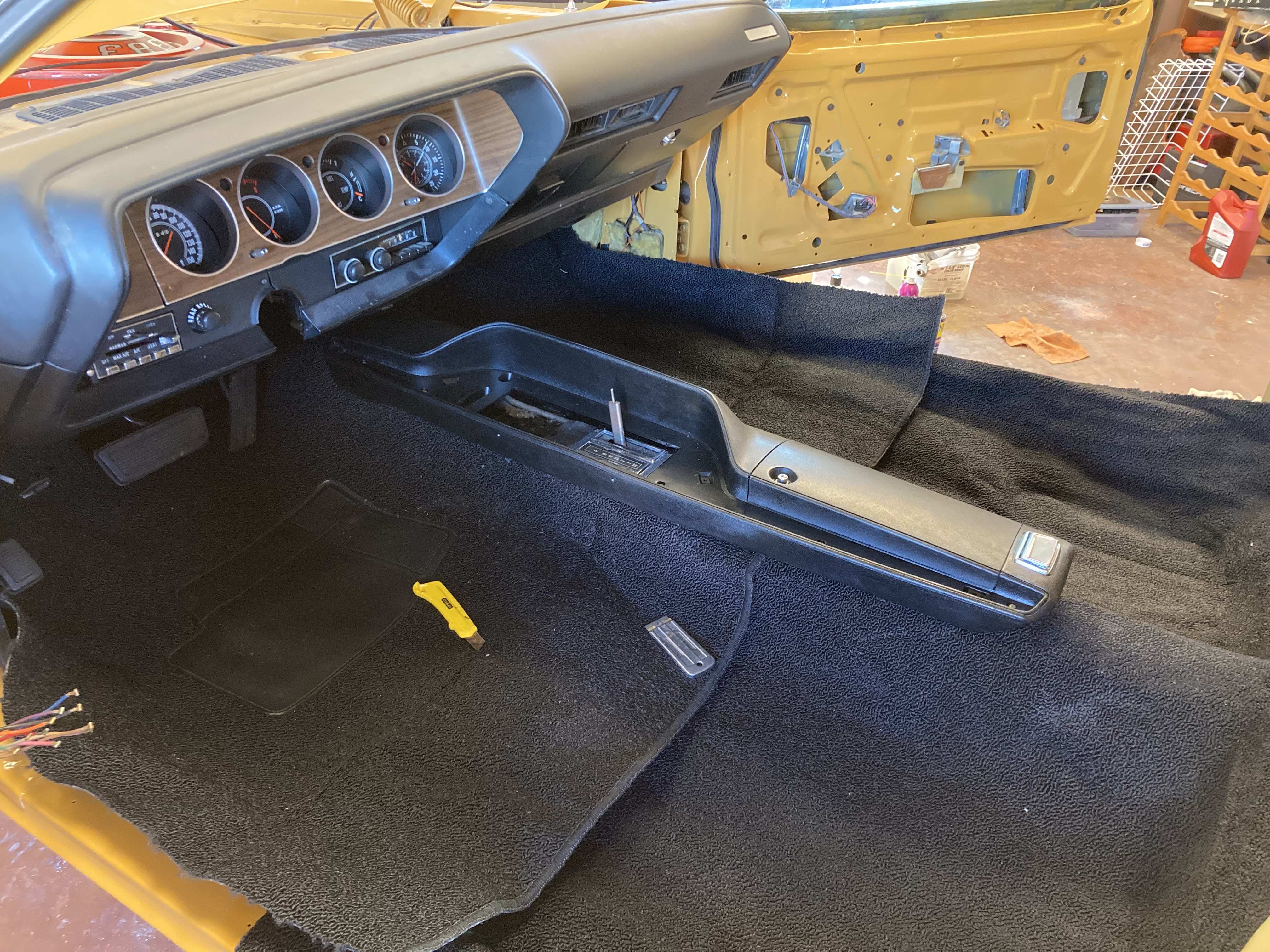

Thanks Nigel! Another member helped me with suggestions to get the door windows installed - and I was very happy to be done with that part! Now working on the carpets - I bought Legendary set and while they are similar to originals, the weight of the carpet is not as good as the originals - new ones have a plasticky feel to them and pile does not seem to be as deep. Also still looking for a local upholstery shop that can help me with the vinyl roof and headliner installation.
