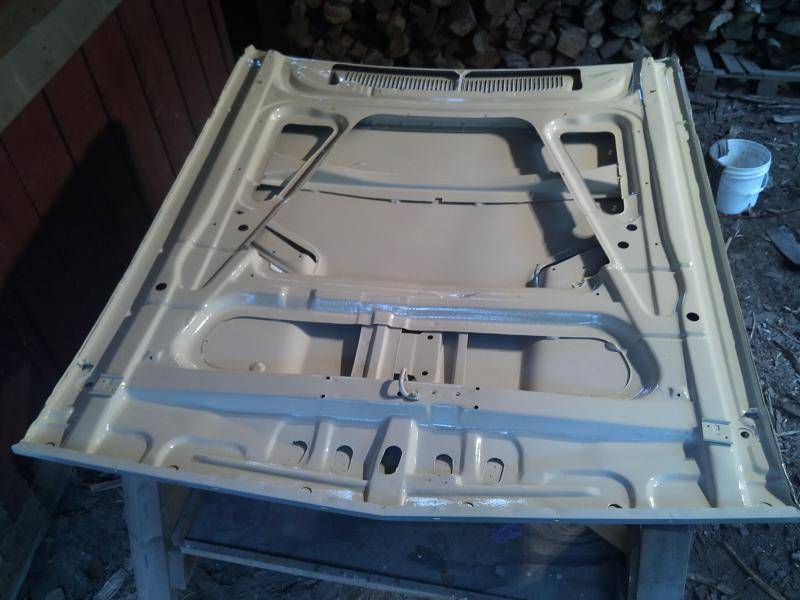

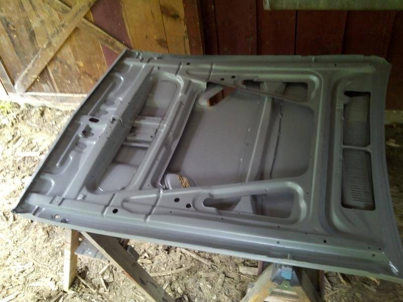

Thanks again Leo. My motor guy is pretty well respected in my area and has a lot of experience. I saw the flywheel and it looks pretty bad. I will try my local parts house. Hard to find time to work on Challenger during the summer time with all the other stuff going on around the house and a full time job. I do need to get it painted before it starts to get too cold outside. I really do not have a conditioned paint booth area to paint it so I will be relying on the outside air temp wo be within the specifications required by the paint manufacture. I was able to epoxy prime the underside of the hood today to get ready for some Alpine White single stage.
Happy 4th everyone!
Bill
Oct 6, 2012
593
55
Vermont
Epoxy primed and 3 coats of Alpine white single stage on underside of hood.

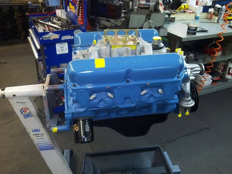

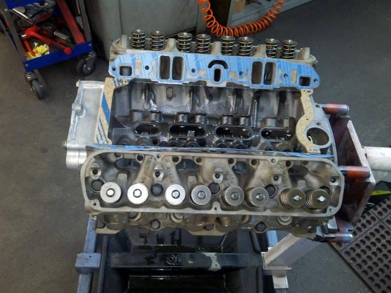

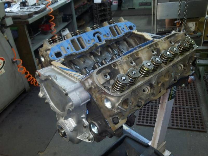

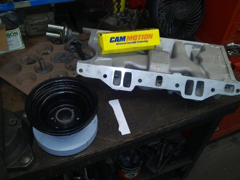

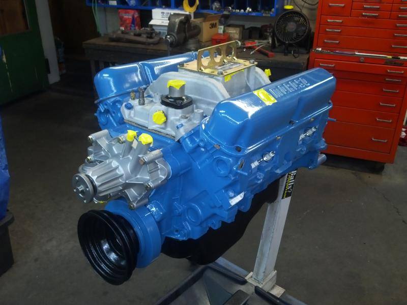

My motor guy sent the new internal balanced flywheel that I got from JEGS out with the crank to be balanced. The place that does the balancing said it was a little tricky but they were able to get it done. Motor guy should get it back early next week and start to be able to build everything up. He was showing me one of the connecting rods had a copper coating on it. Pretty interesting story as to why they did that copper coating at the factory. We purchased a new oil pan. I have two oil pans but they are both pretty well dented up and have some thin rust areas. Purchased a new water pump and fuel pump as well. Paint may not happen till springtime next year. Motor, interior,wiring (would like to do ISIS power system) will be good winter time projects.
Q. We are assuming the original color of the motor is blue for a 1973 340? It looks like someone painted orange over the blue on the oil pan. Is there a name for that color blue Chrysler originally painted on the motor?
Q. I would like to put the battery in the trunk. I was thinking of routing the wire from the trunk to the engine area through some PVC plastic or steel pipe to protect it from chaffing. Anyone ever done this?

Leo
You are an amazing individual. EMT makes a lot of sense. Looks like blue is the color to use.
Thank you. I will get back to work on your car as soon as possible. lol
