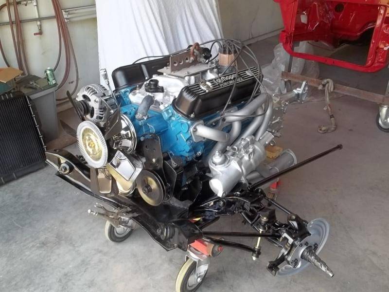

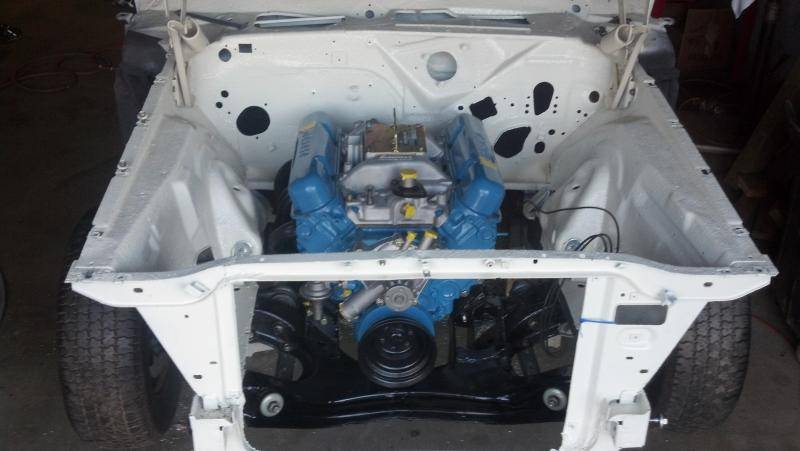

Looks pretty. Did you change to the rubber reusable gaskets ? I would recommend that you paint the pan blue also. Black makes it more difficult to spot fluid leaks. Also a black harmonic balancer makes it much easier to see the white timing mark with dim light as the best contrast you can get is white against black. JMO
Looking good though.

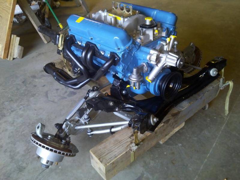

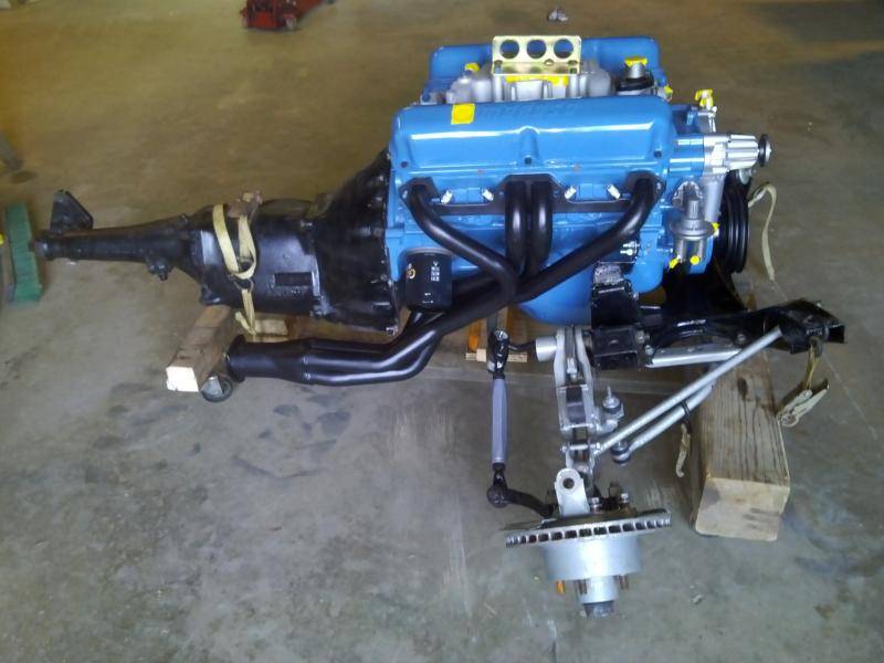

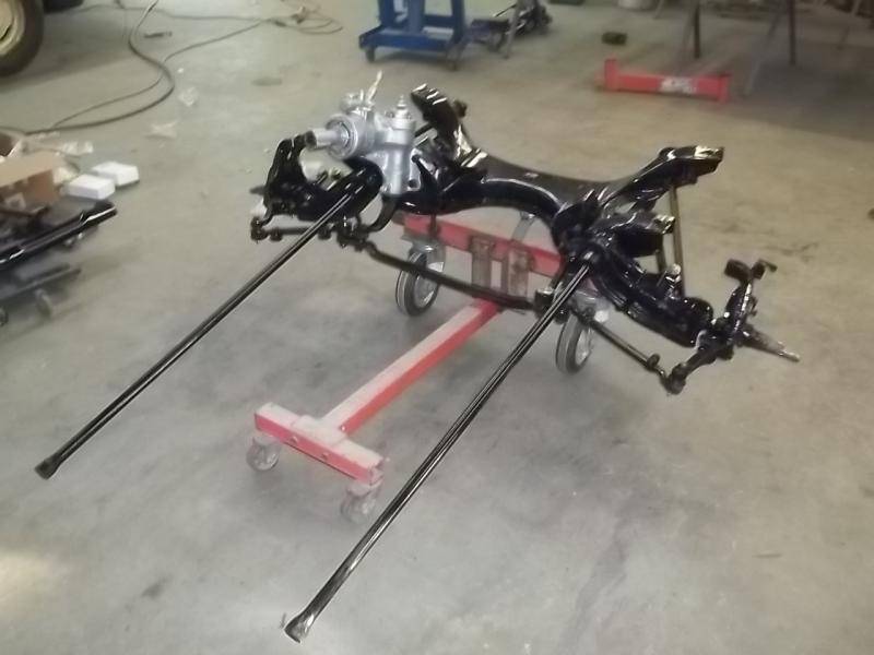

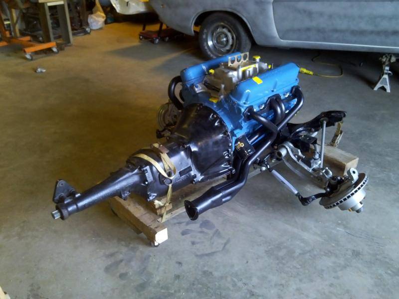

Q2. Anybody have a rough drawing or picture with measurements of a K frame dolly that will hold k frame, engine and tranny? I can make out of metal or wood or both.
this is what i have. i can measure it up for you if you want.

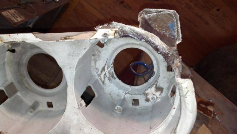

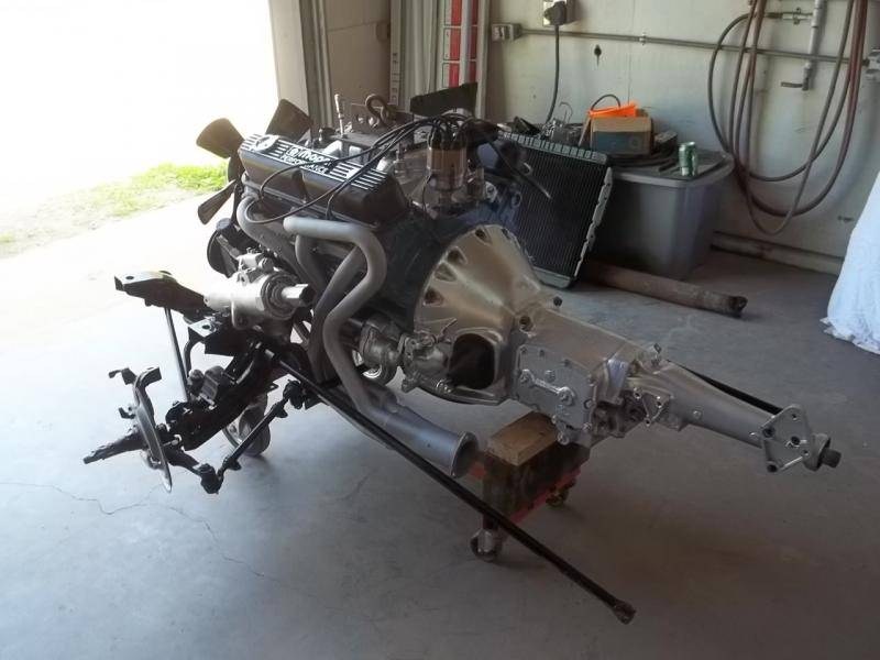

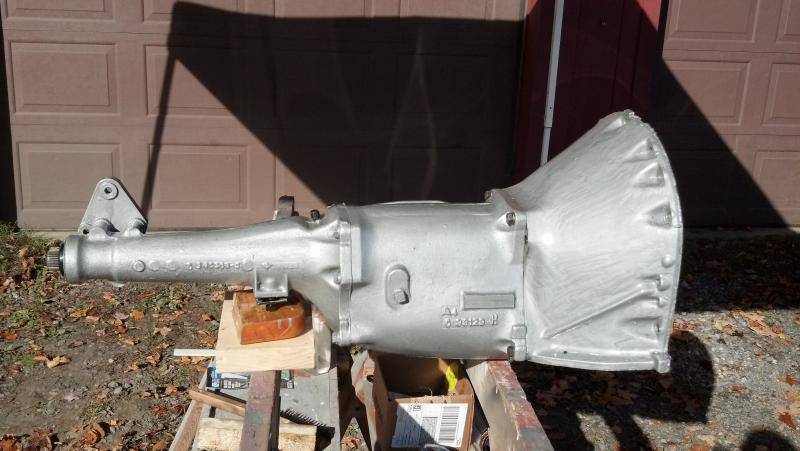

004.jpgNew seals, gaskets and o-rings in the transmission (including the reverse shifter little o-ring, what a pain that was but I was able to do it). Trying my hand at a little fiberglass repair work. Building that little ear on the header grille. It's not quite as bad as working with wood (lol).

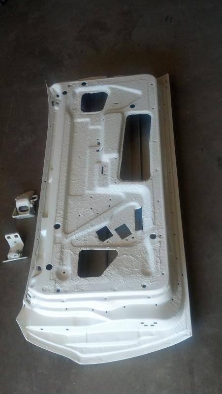

007.jpg 008.jpg sandblasted, rust encapsulated, epoxy primed, lizard skinned and cut in the edges with single stage of the passenger side door.

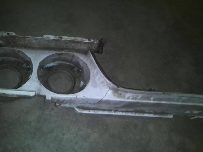

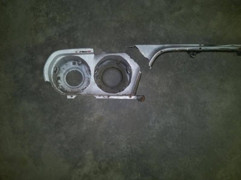

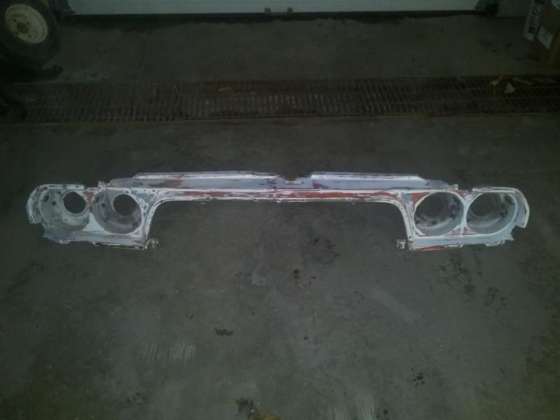

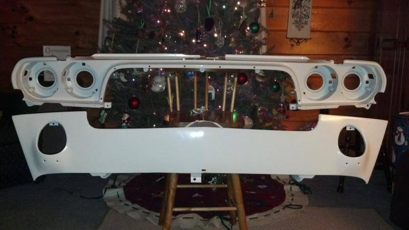

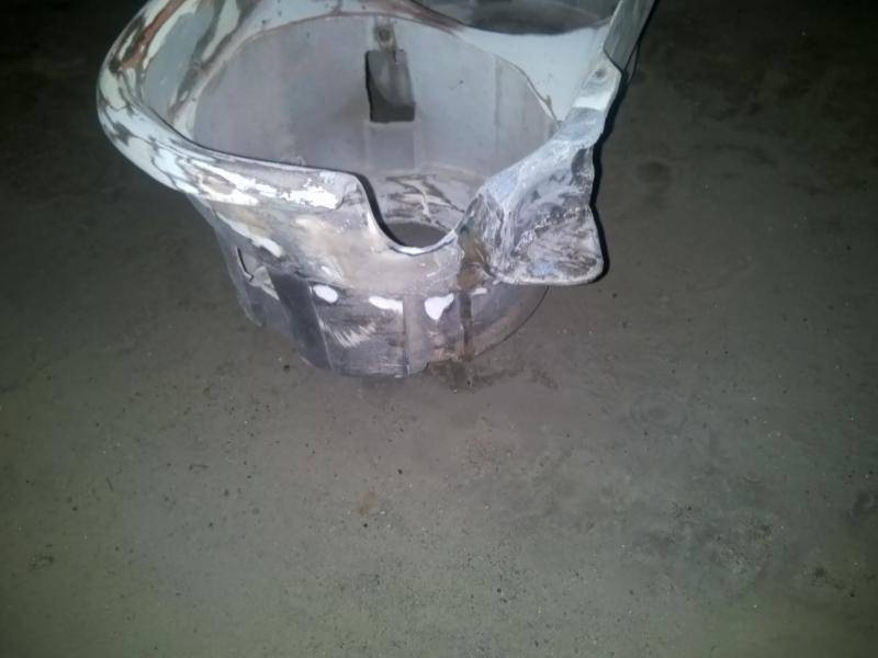

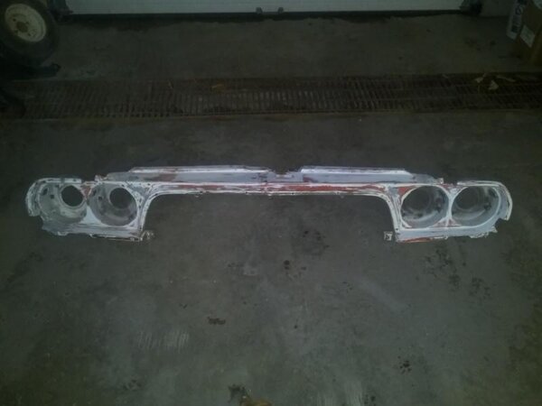

I check out FEBO every day and there is a lot of amazing stuff happening out there that is near and dear to my large mopar heart. Hope I don't bore you with my novice project happenins but if and when it's finished this journal will be a cool thing for me to look back on some day. Still "dubbin". Working on the header grille. Should have some coats of highbuild primer on it and the front lower valance this weekend. Fiixing all the cracks, fabbing up the little fiberglass mounting ear that was broke off and lost, smoothing everything out and basically making one price out of two of the header grille. It's all good fun. 045.jpg046.jpg
Headergrill and Lower valance repaired and primed.
