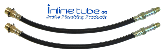

    Don't forget to replace the rubber flex hose lines that from the caliper to the frame bracket.
    In-line sells an exact reproduction of the original with the gold ends, it that is important to you.
    Inline Tube H017 - Pair, 2 piece, Front Disc Brake Hose with correct Gold Zinc Ends. 2pc Raybestos #BH35017
    Paid $24 for the pair- well worth it.

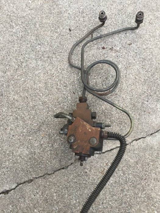

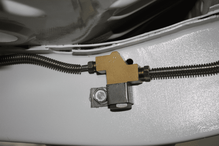

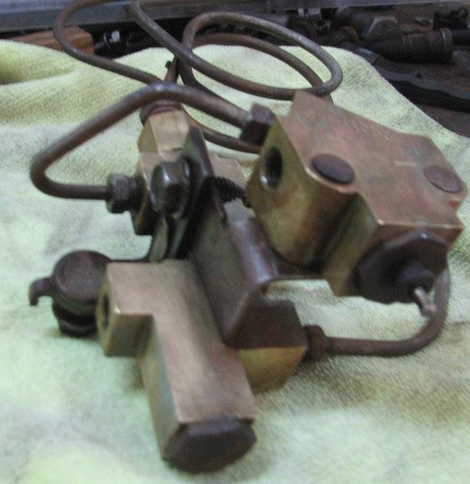

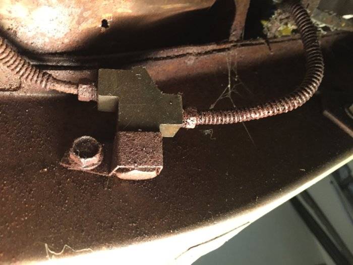

    My 1970 Challenger came factory with power disc brakes front/ drum brakes rear and has this valve.
    Here is a close up of my original (below driver seat on frame)
    2nd, 3rd pics are my original proportioning valve and distribution valve

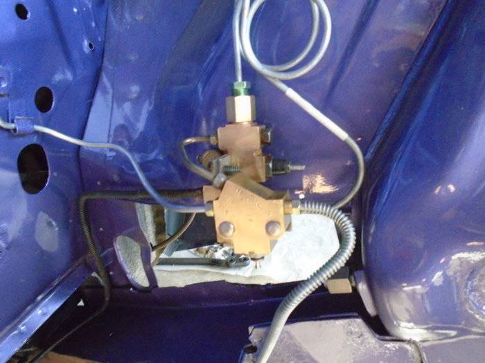

  12. ph23vo
    ph23vo Well-Known Member
    Messages:
    119
    Likes Received:
    24
    Joined:
    Apr 3, 2011
    Location:
    seattle
    early 70 disc cars had the second valve bolted lower on the frame...later 70 disc cars had it incorporated into the prop valve bolted to inner fender below m--cyl..use this style [see my car pic] and your drum rear brake line will screw right into it!.. [darker line in my pic] also make sure you rebuild the valves this guy has the seals Home | Muscle Car Research LLC easy to do upper lines to mcyl only depend on your set up having power brakes or manual.. good luck
