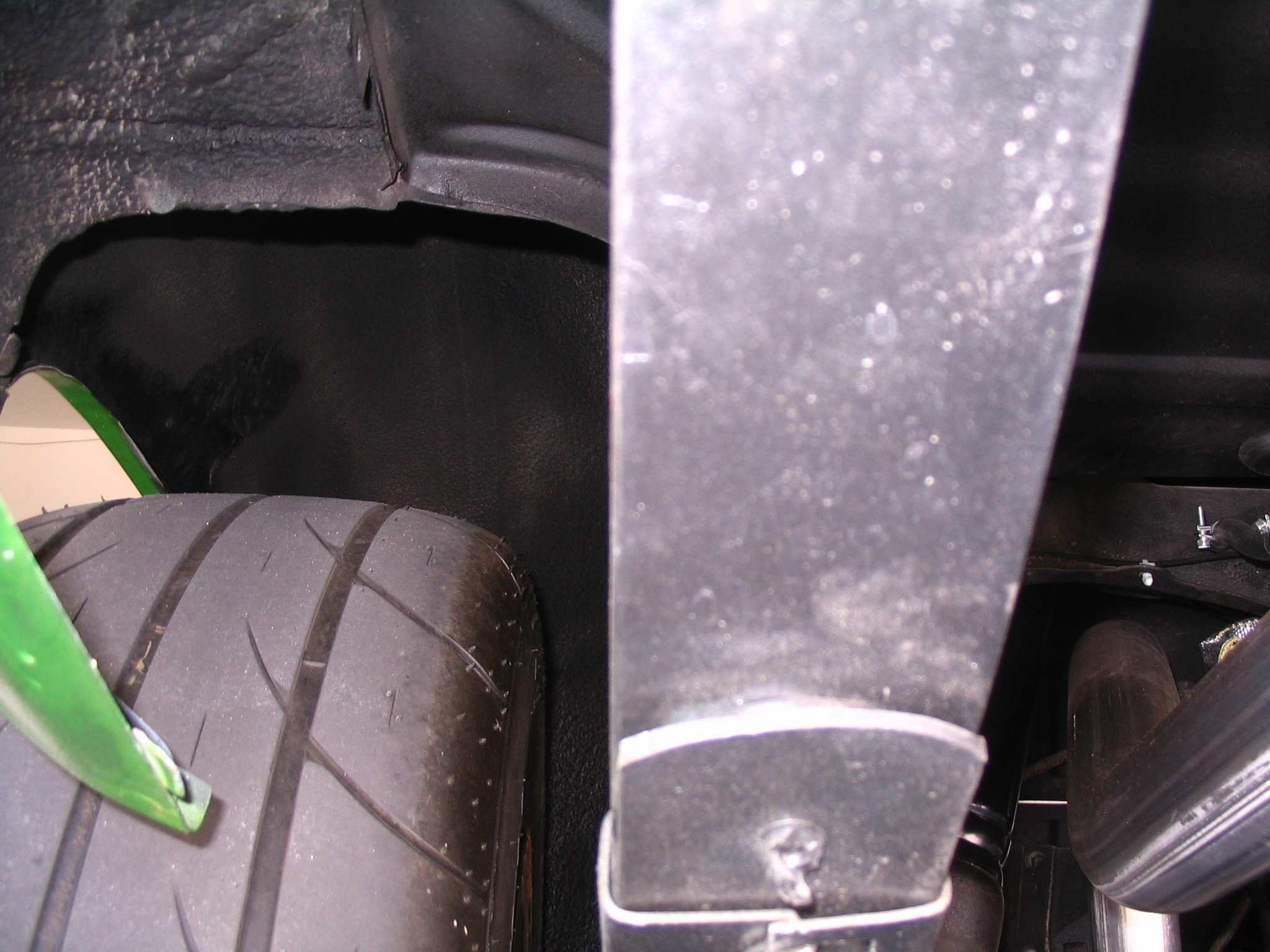

I put an A-body 8-3/4 and one inch offset spring hangers on mine and 295-50-15's on 15 x 10 keystones fit right on with room to spare.

Very nice Cratos. Stock springs or Espos +1? What offset on the rims?

15 x 10 keystones Klassics. and superstock springs ( I like the old school rake look) with 1 inch off set hanger kit
