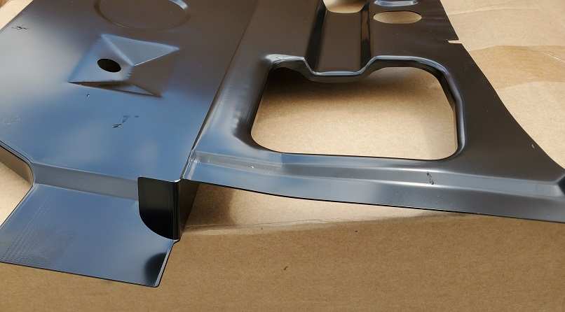

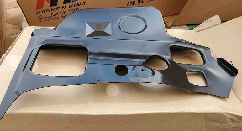

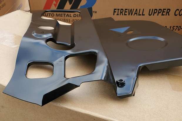

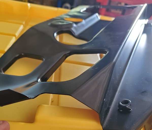

The cowl side panel I bought a couple years ago is just horrible compared to the rest of the the AMD sheet metal I have (damn near a whole car, lol). Is this simply what people are having to work with? I'm hoping there is a chance AMD retooled and these aren't like this anymore.
Also, I know someone with the exact same part in the exact same condition.

I am aware that things aren't expected to fit perfectly out of the box, however every other part I've gotten from AMD at the very least is able to be placed into it's respective spot and it will "fit".
The inner cowl panels shown above are the only pieces I've seen that literally require something akin to stomping on them get into the general shape they are supposed to be. As mentioned, the dynacorn parts are arrow straight, but seem "thinner".

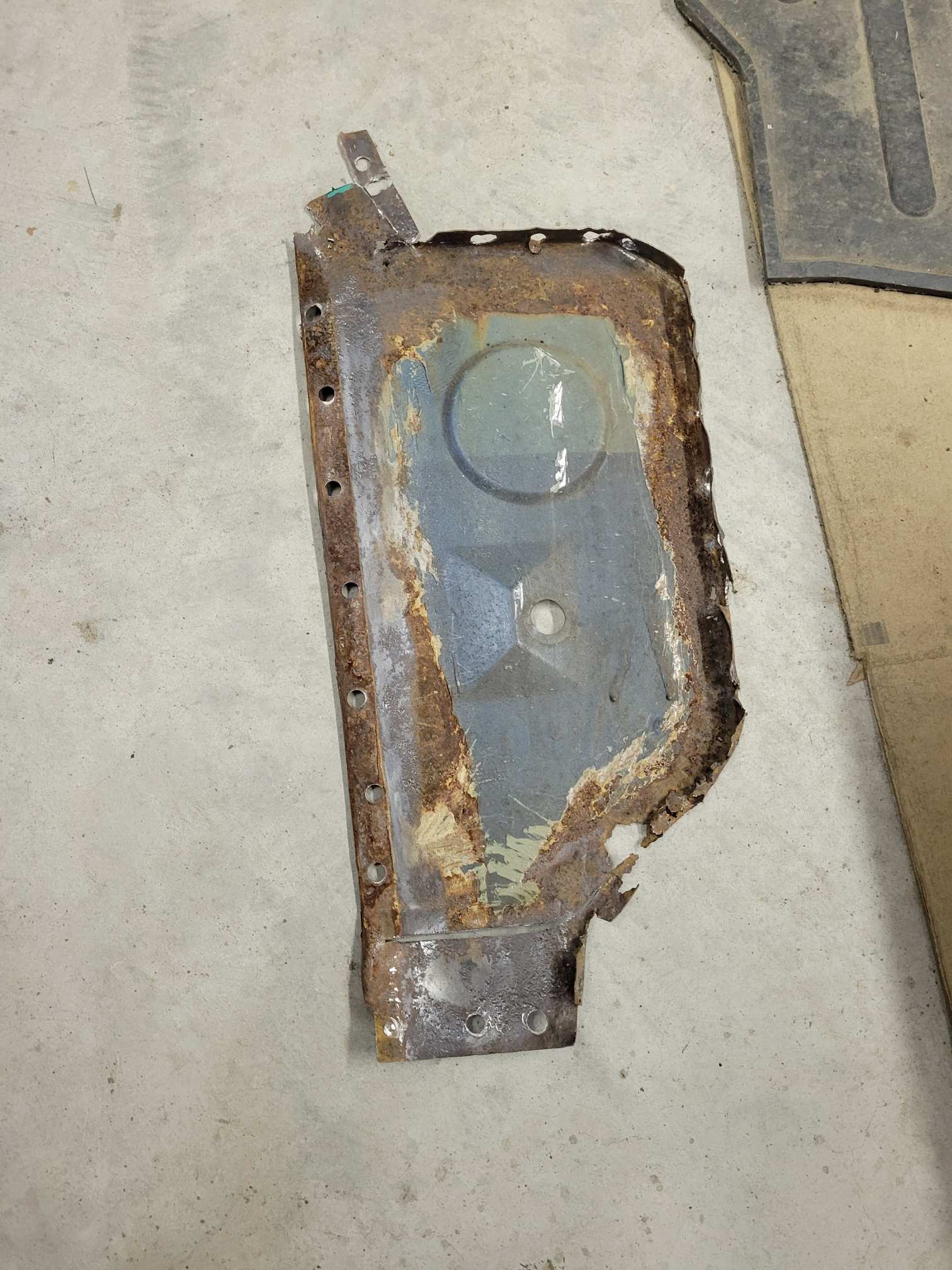

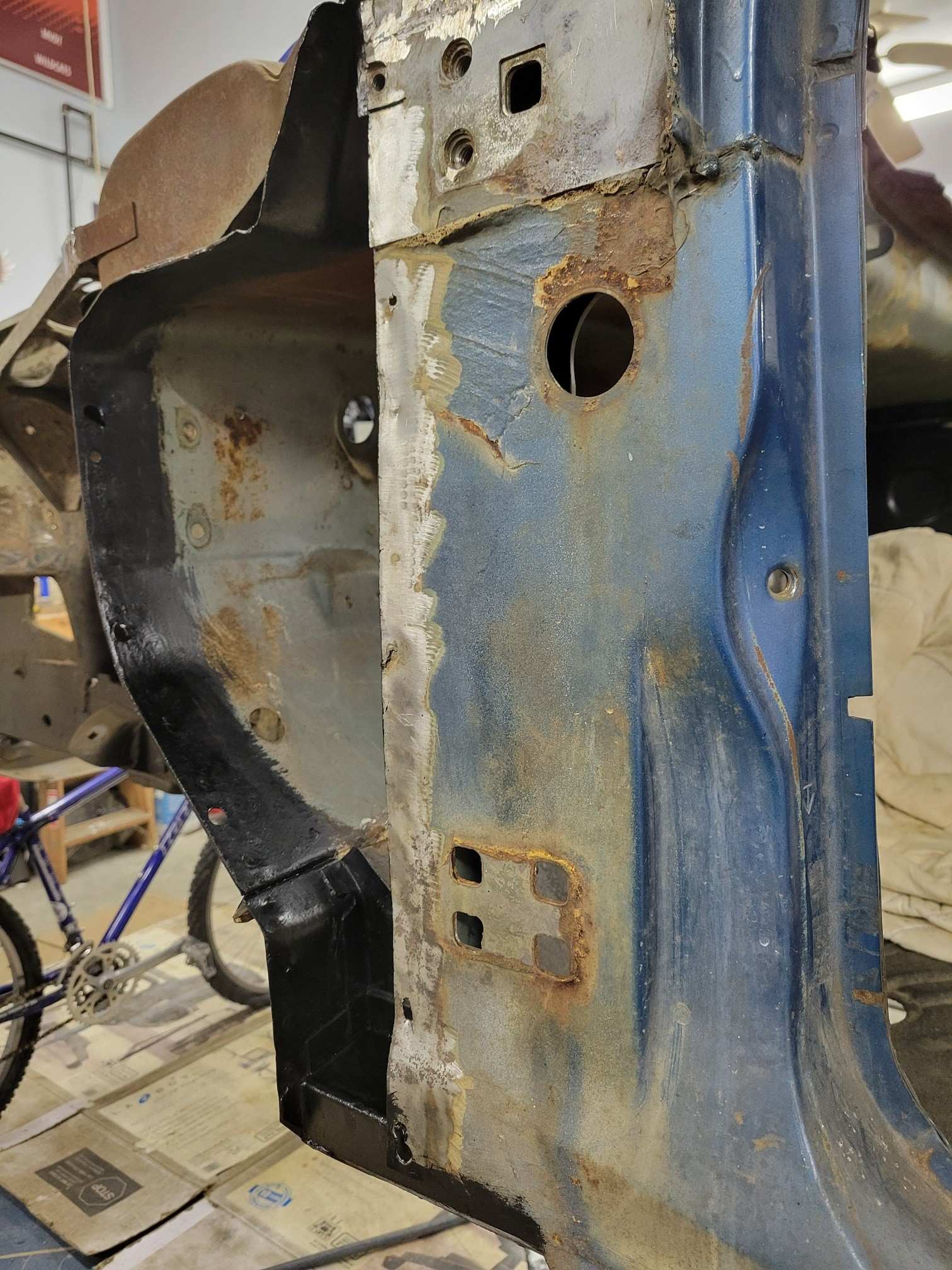

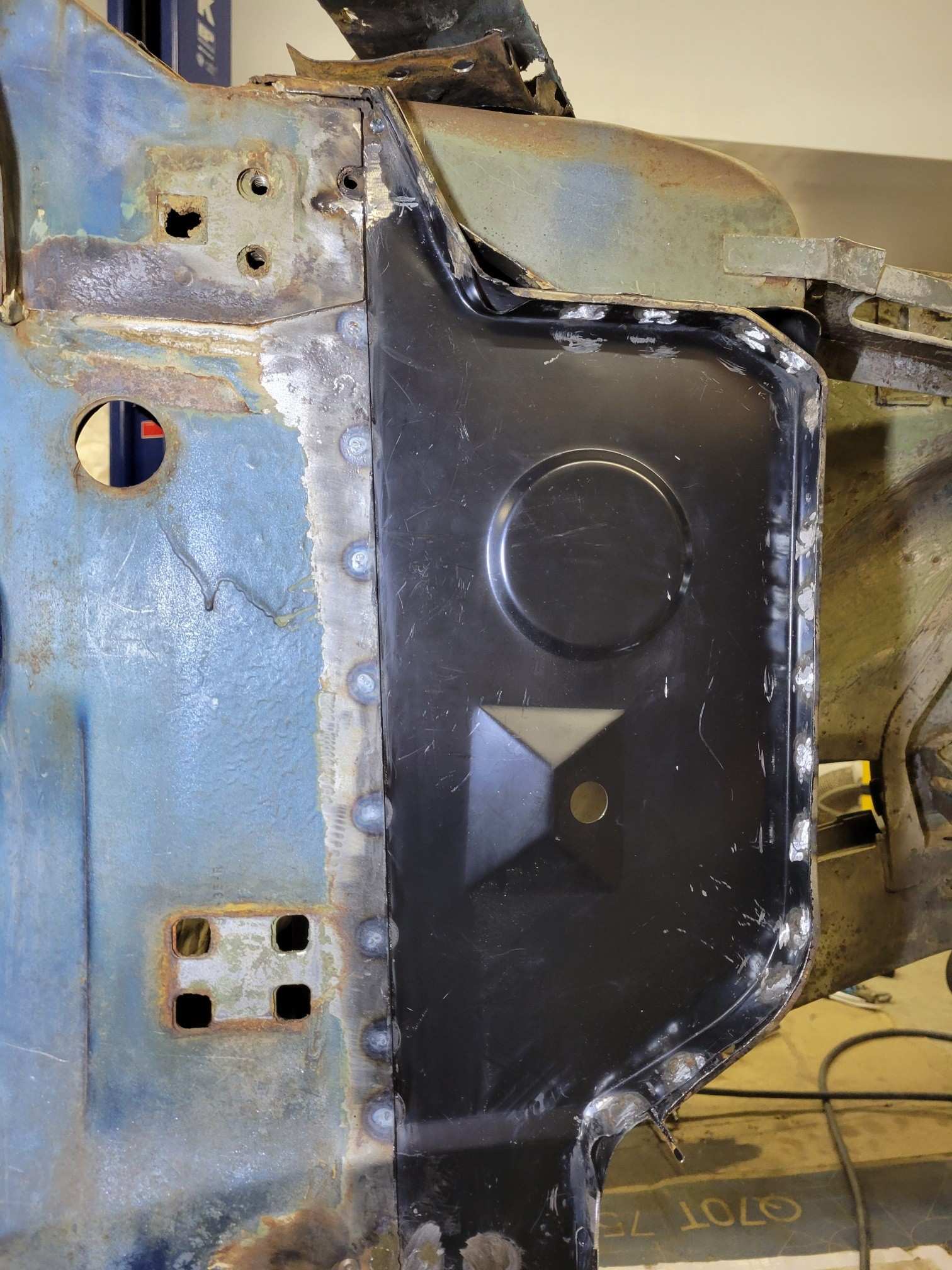

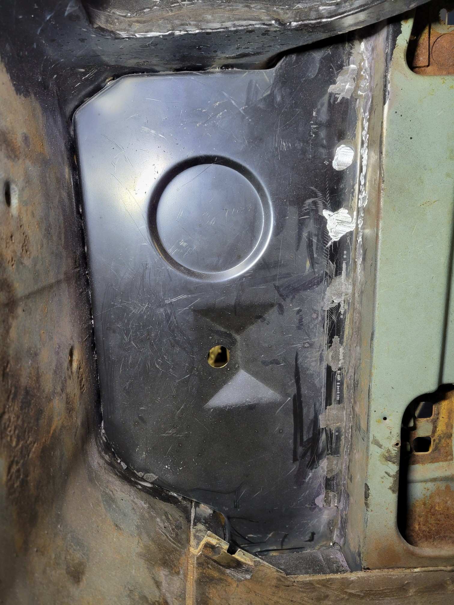

Cuda416 and Xcudame, I can definitely relate. I just recently finished the right side cowl panel on my 70 Chall and just started welding in the left side today. I bought the same AMD panels that Cuda416 bought, and, like Xcudame noted, there's always some tweaking that needs to be done. But I do like AMD's metal thickness, particularly in this structural area, so I forked out nearly double the cost compared to other brands. Because the metal around my door hinge mounts were good, rather than go through the difficulty in replacing the entire side cowl panel (drilling out spot welds and dealing with multiple metal layers and risking positional shift, I cut the AMD panel in half and butt/spot welded in the new piece. At times I felt like a ball turret gunner in a B-17 while welding in under the dash...very cramped, especially with the welding helmet. As I've been welding in new replacement pieces, I try and leave as much of the original EDP(?) on the new panel seams, while at the same time, I cover the original, exposed metal with Eastwood Encapsulator Plus. Then I take a small, modified wire-wheel, put it in a hand-held drill, and place it in the spot/plug weld holes to reveal fresh metal for welding. That way the encapsulator coating between the two welded pieces gives a little more rust protection. I didn't put seam sealer in between the panels because most of it melts or is chemically altered from the weld heat and just makes a mess. Granted, the encapsulator melts/alters as well, so I may be throwing rocks at my own glass house. In my humble opinion, the seam sealer between panels is a two-edged sword. Yes, it quiets potential squeaks, etc., but it creates an environment for rust to form, especially when some of it is melted by plug welds. You can see in the pic of the ribbon of rust/rot around the right side cowl panel. That is what it looked like when I removed the old seam sealer, followed by a big, heavy sigh...three steps forward, two steps back. Wish you all the best in your restoration efforts. Thanks for listening.
