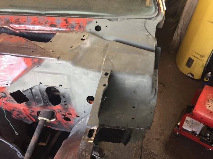

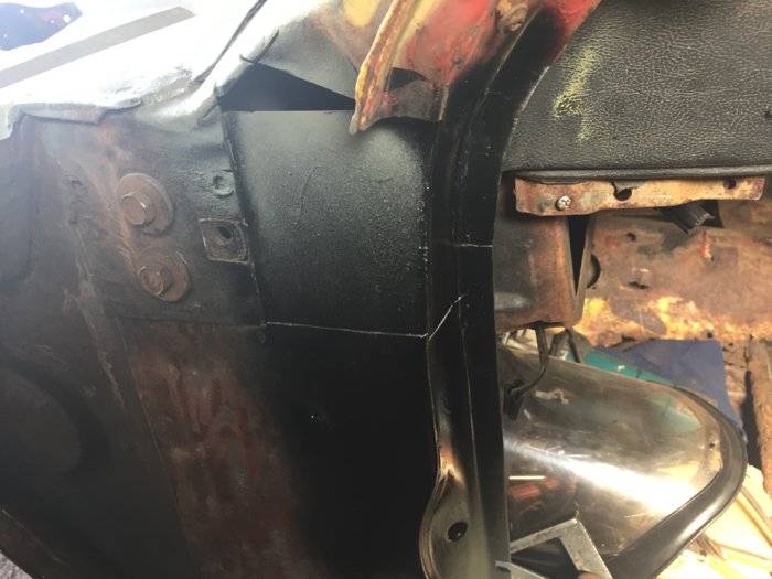

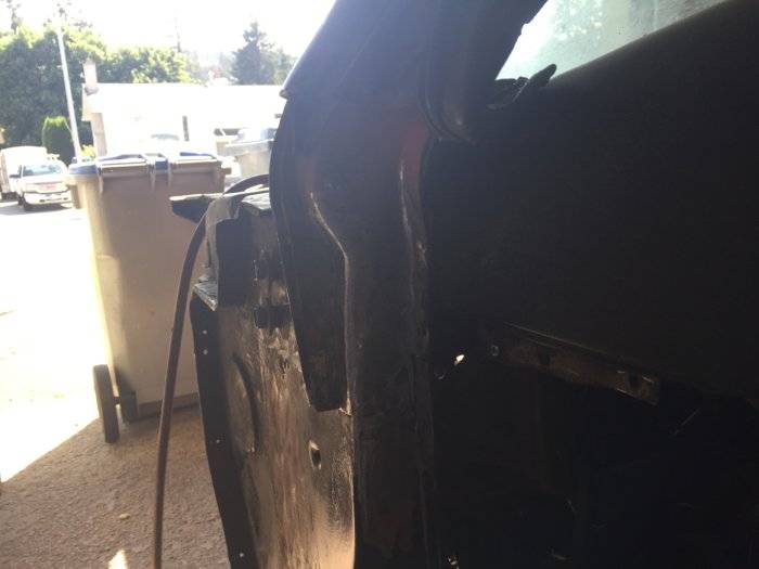

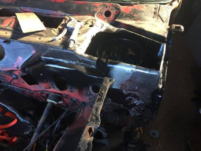

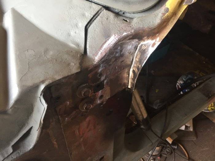

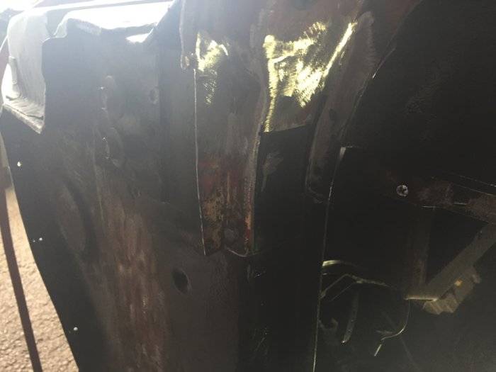

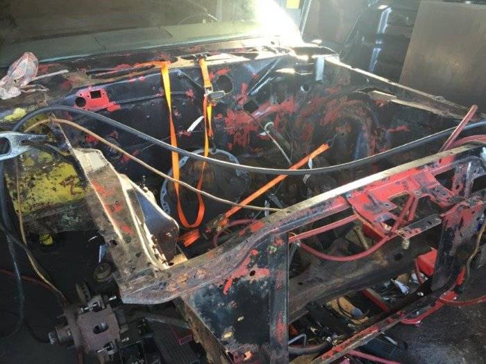

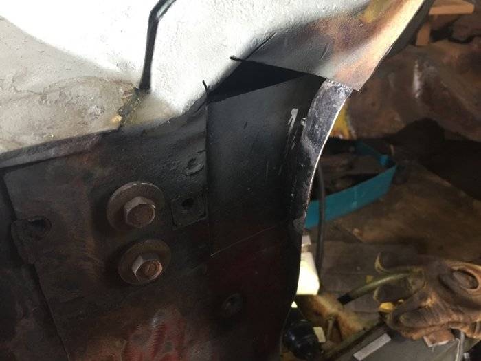

This side was quite rusty behind brake booster and upper and lower door jamb.The inside air vent had to be rebuilt. This car looks to me its on its second repair.The previous repair way back when was just a patch over rust and braise its all over as you will see, I am cutting it all out and welding in new metal.
