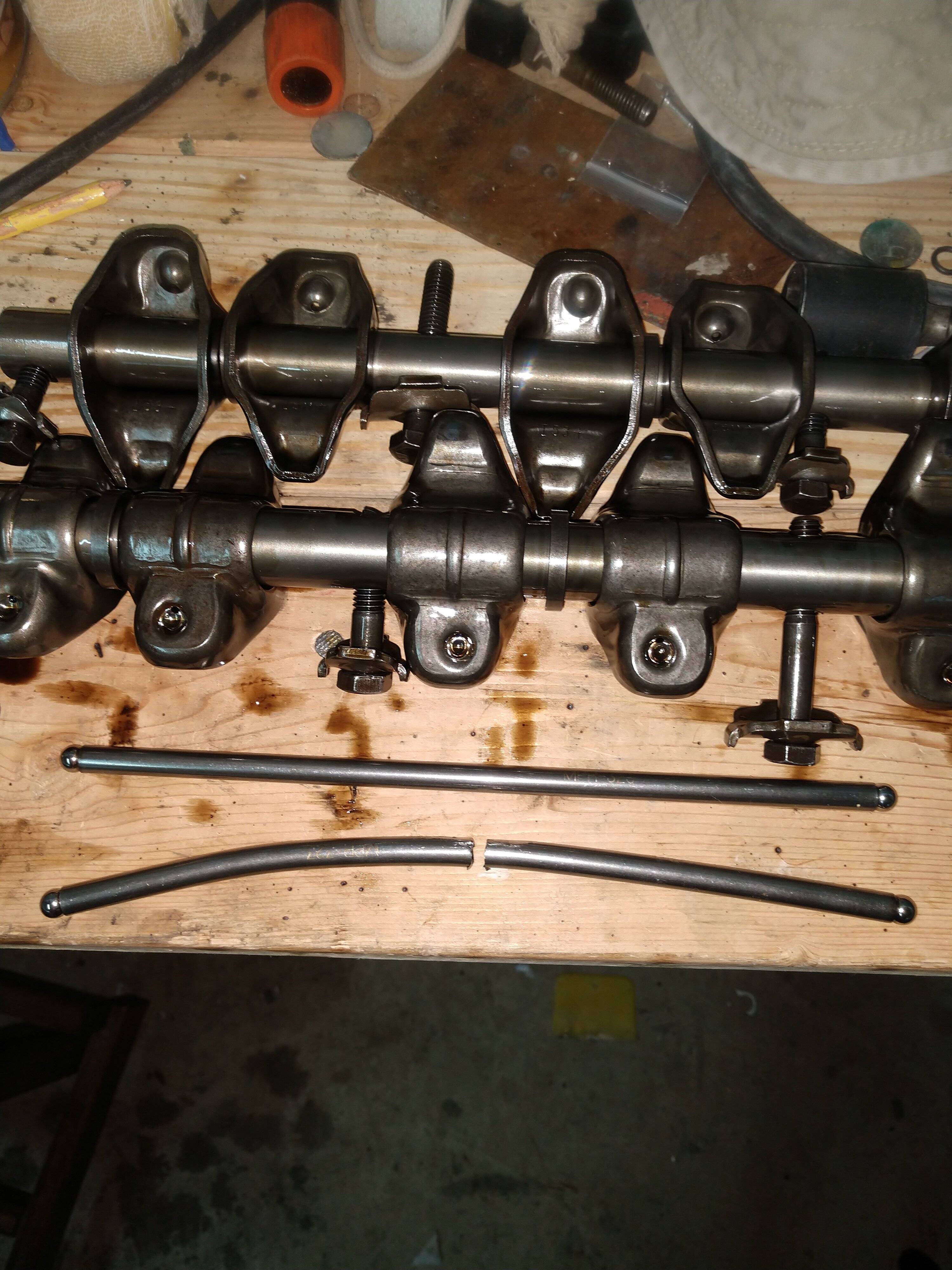

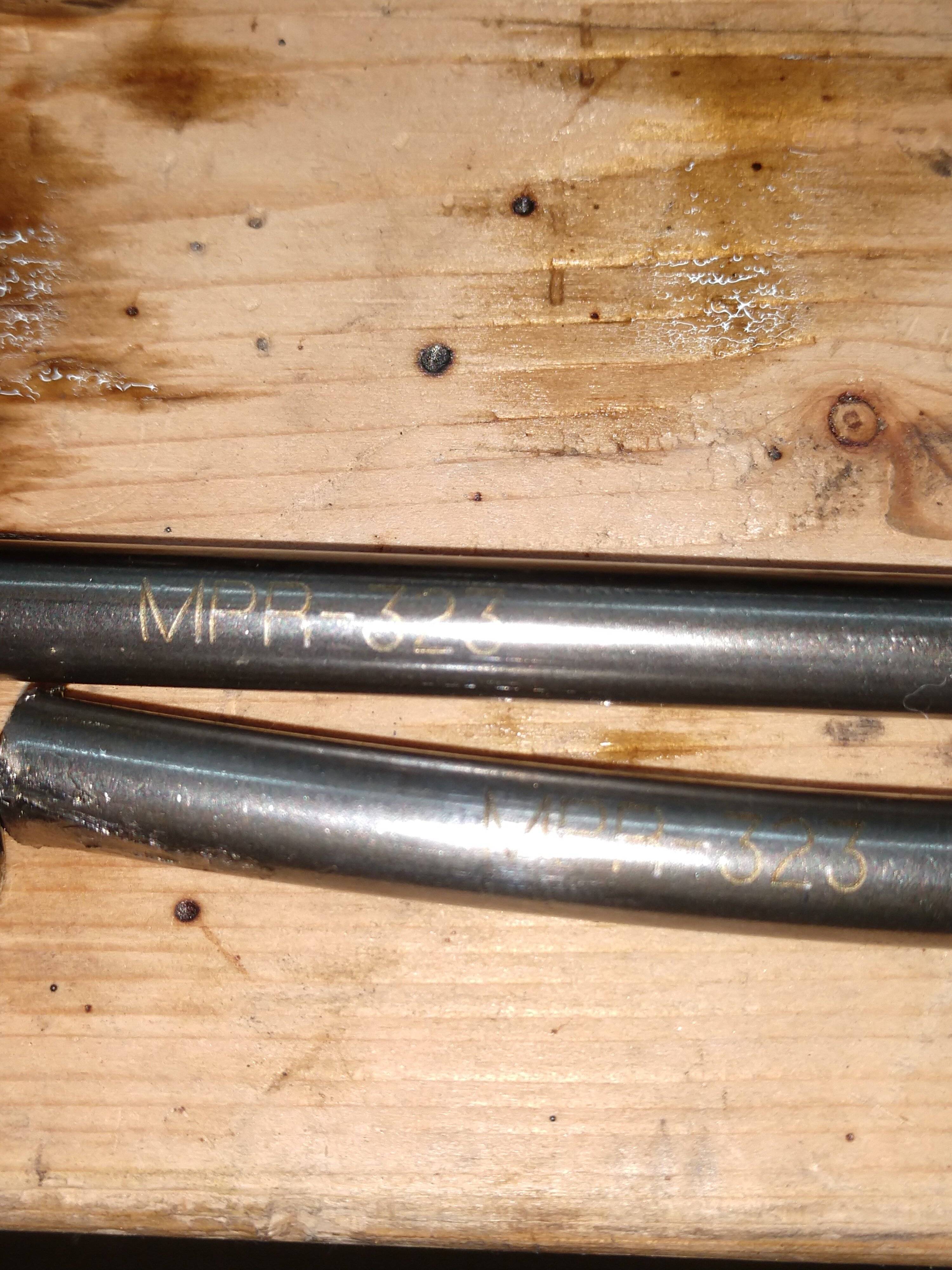

I started my Challenger and saw it had no oil pressure. I immediately shut it down. I checked a few things, sender wire, etc.. I pulled the valve covers and found the problem. A pushrod had broken and fell out. The lifter was way up, almost out of the bore... Fortunately the lifter looked undamaged. I have ordered 3/8 diameter, oiling, .080 pushrods and new rockers. (they looked fine but have many miles on them).
I've seen bent pushrods plenty of times, but never seen one break in half..
