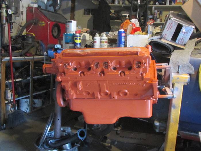

I installed a 1973 360 into a 1970 Barracuda with the stock oil pan without problems. The motor came from a 1973 Plymouth Fury.I have a 74 360 engine, that I don't know what type of car or truck it came out of. I was wondering if this is a correct oil pan to install in a E body. I'm going to install it in a 70 Barracuda. Thanks

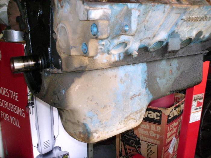

Did your oil pan look like mine?I installed a 1973 360 into a 1970 Barracuda with the stock oil pan without problems. The motor came from a 1973 Plymouth Fury.
Thanks, great info.Here is a good resource on the pans
Casting Numbers: Mopar Oil Pan Specifications 1961-1980
My '71 340 motor in my '73 Cuda has the "294" pan which looks pretty close to what you show, but the table shows the 360 as having a unique PN from the other small blocks.
That's the oil pan that I thought I needed. I asked Tony from Tony's Mopar parts, he said the pan I have was correct. If it wasn't I was going to see if he had one in stock. Thanks.
