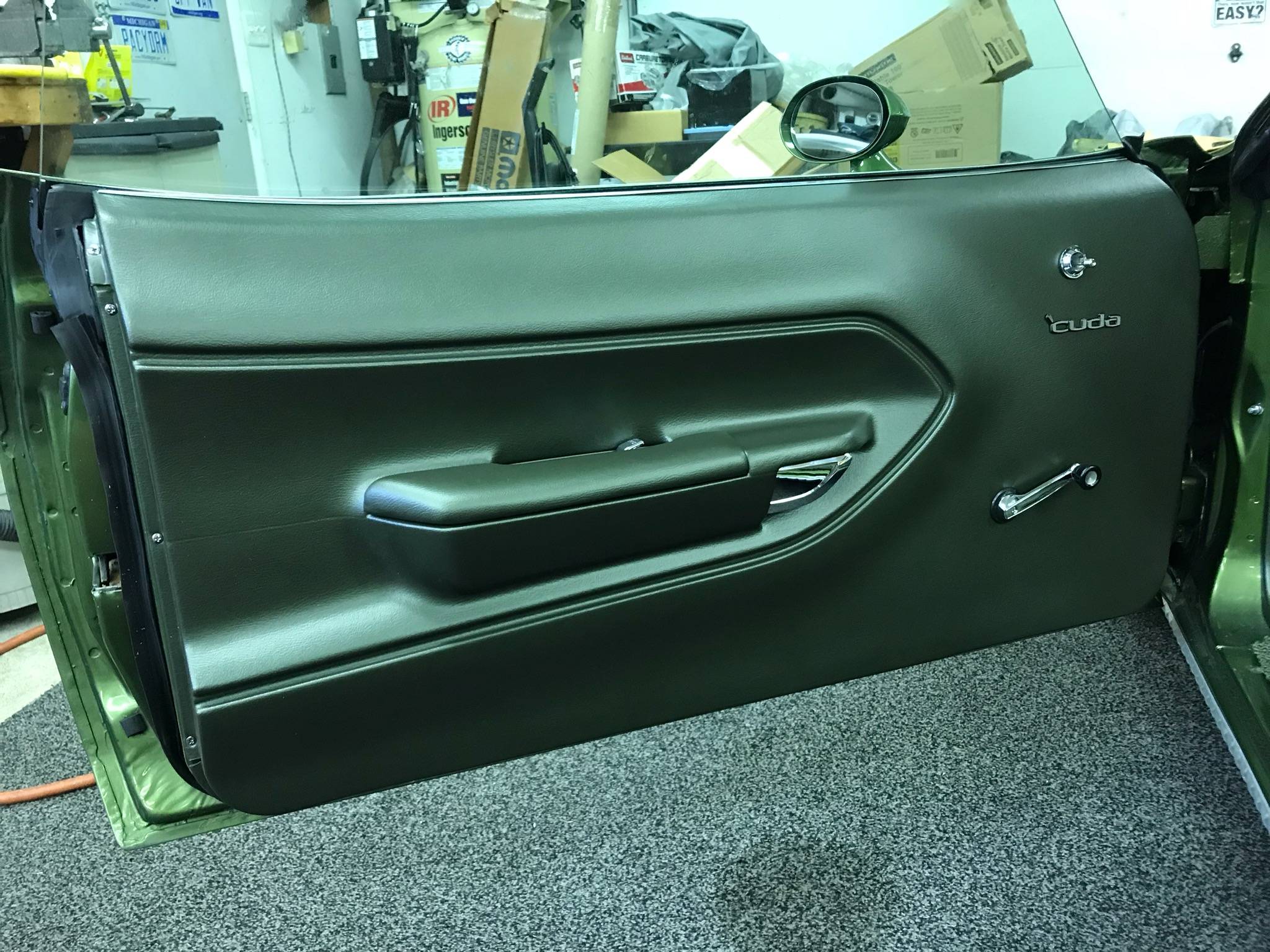

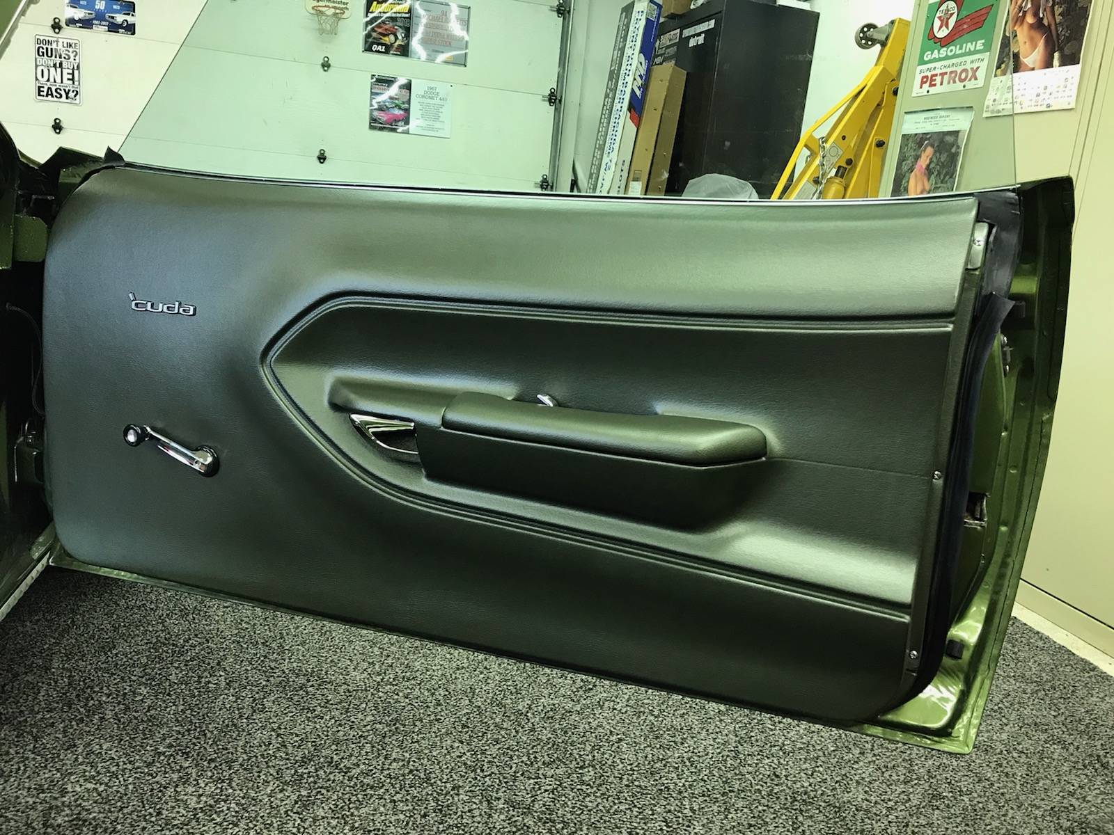

Clean surfaces and 3M Black Super-Weatherstrip adhesive. They'll never come out.
I just finished-up both of my doors, and they don't make a noise....except for a huge thud when you close them.
