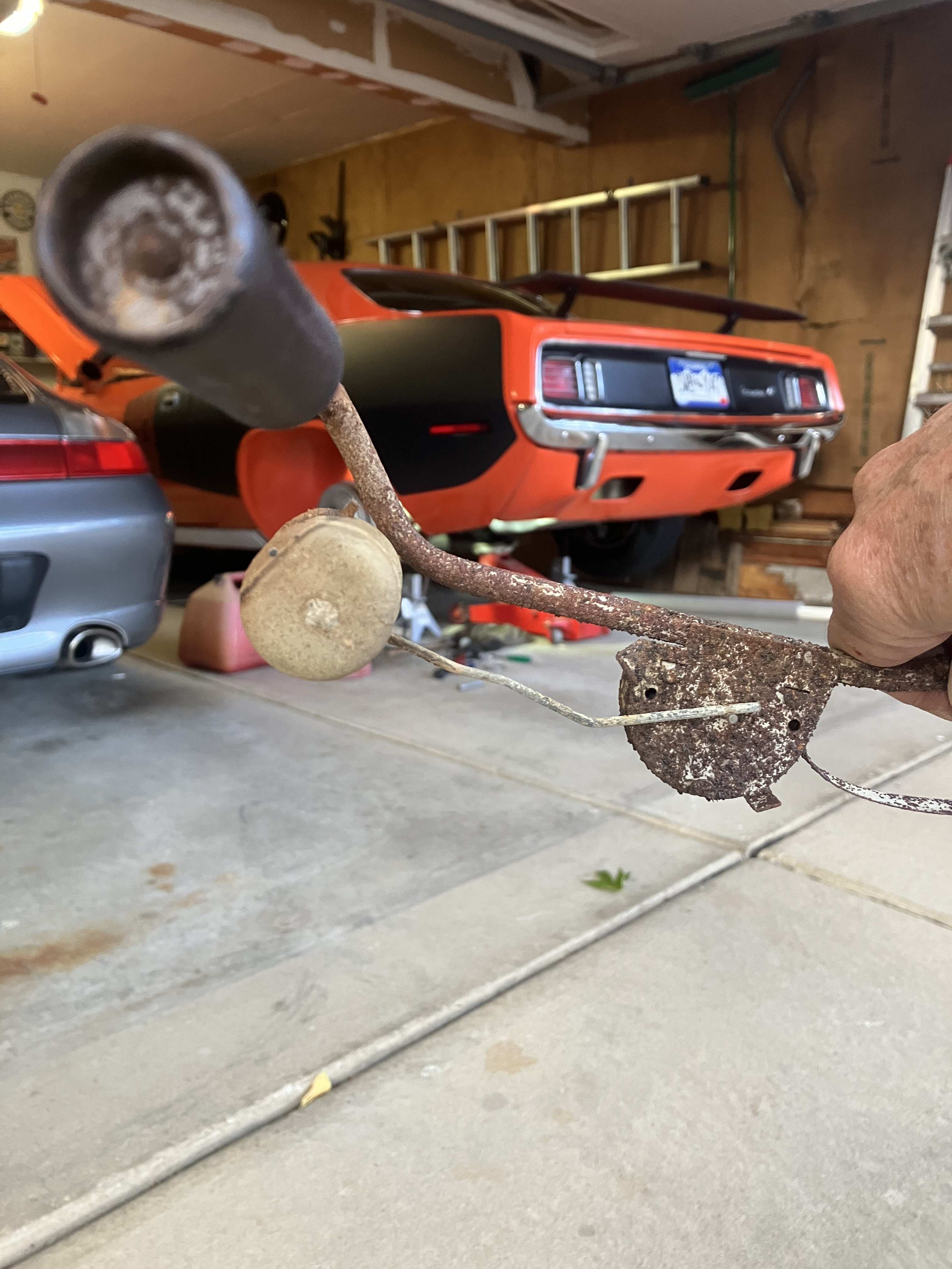

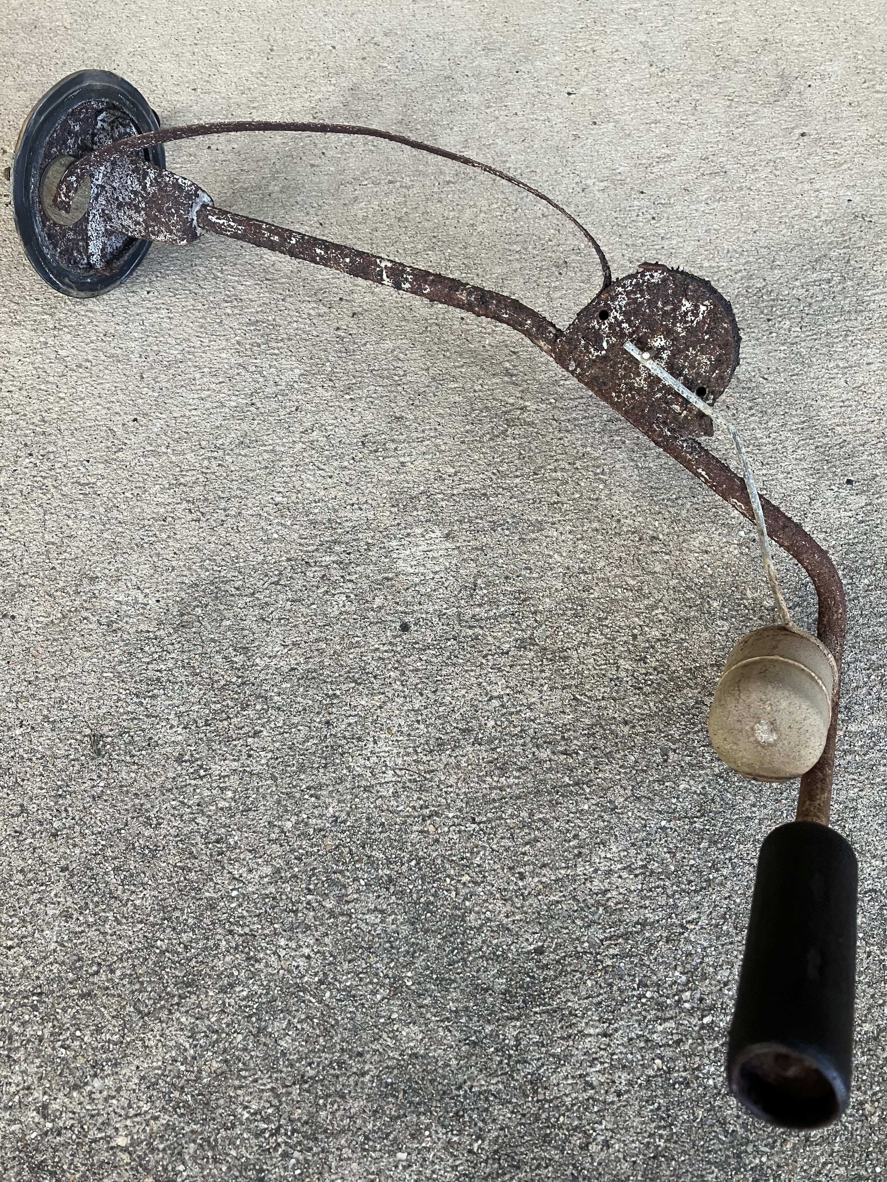

I love this forum! So helpful. You two inspired me, so I took a screwdriver and hammer to it and it came right off. Here is a picture of the crusty old thing, and another with it hanging upside down and the float does not ever fall by gravity of its own weight. I'm ordering a new one. I don't know what the prev owner coated the inside of the tank with, besides corrosion.
I took this opportunity to siphon another 5.5 or so gallons out, so probably have removed about 14 or so, I think it is fairly empty. I put the old unit back in just to seal the tank so I don't fill my garage with gas fumes. I'm ordering a new unit, now have to decide if I want to mess with the tank or not. Leaning toward not, even tho I'm sure it has crap in it.

That is one nasty looking sending unit! That gas tank has definitely had water in it at one time or another! You might try sticking your cellphone up to the sending unit hole and see if you can get some pictures of the inside of the gas tank. If the inside of the tank looks anything like that sending unit I would seriously consider getting a new tank.

I will remove the unit and see if I can get a photo of the inside of the tank. I agree, a new one may be in order!

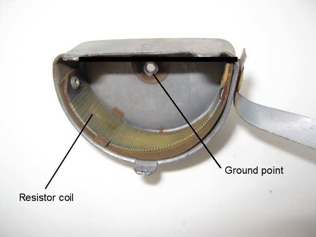

I'd pop the cover off the rheostate and see what it looks like.
Granted the arm looks bad, but none of that matters, the only part to be concerned with is that spring and feeler that rides on it. You just might be able to clean that up.

What Katfish said. a good soaking in Evaporust might bring it back. If it were me I'd try and resurrect it, but I like doing that kind of stuff. Here's what a nice inside looks like.

Well, today I cleaned up the old sending unit a bit (not a lot), and got the float arm swinging freely. Oh, the float is about 1/4 full of gas. With the unit outside the tank, I hooked it up with jumpers to the gauge wire and a ground, set the float to the high position, and sure enough, my gauge read full. Mystery solved (mostly). I was considering just putting my new sending unit in when I get it and call it good.
