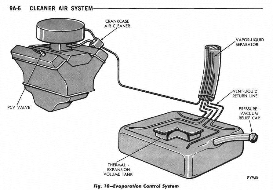

The four vent pipes go to the factory fuel tank vapor saver system. The four tubes are connected to the vapor liquid separator located up in the trunk.
The system description and layout diagram are in the 1971 factory service manual.

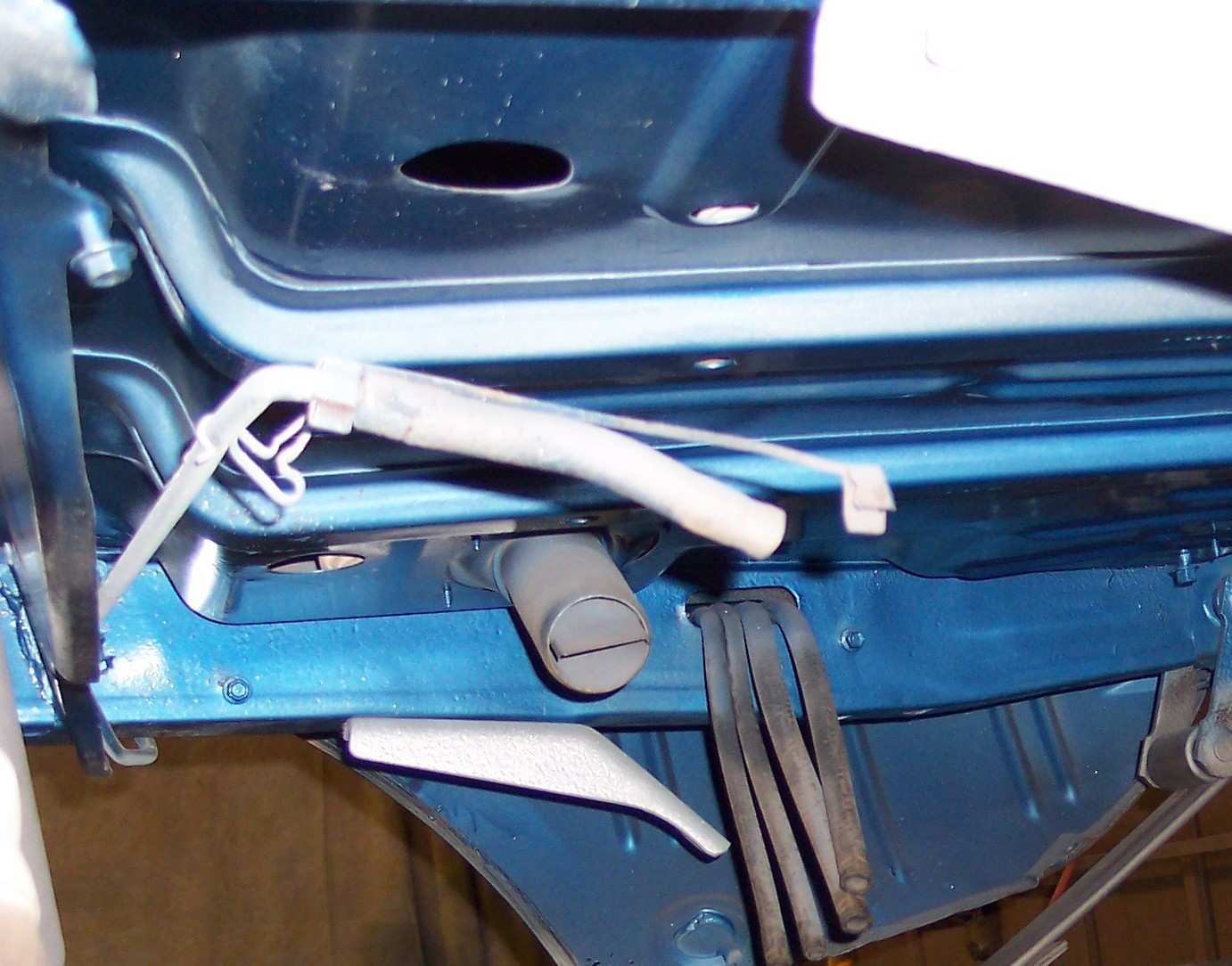

The part that Challenger RTA showed is the correct one, but if you are not concerned with the correct appearance, or if you just want to test things, you can obviously use any short length of copper wire or similar conductor to create a ground connection between the body and the sending unit.

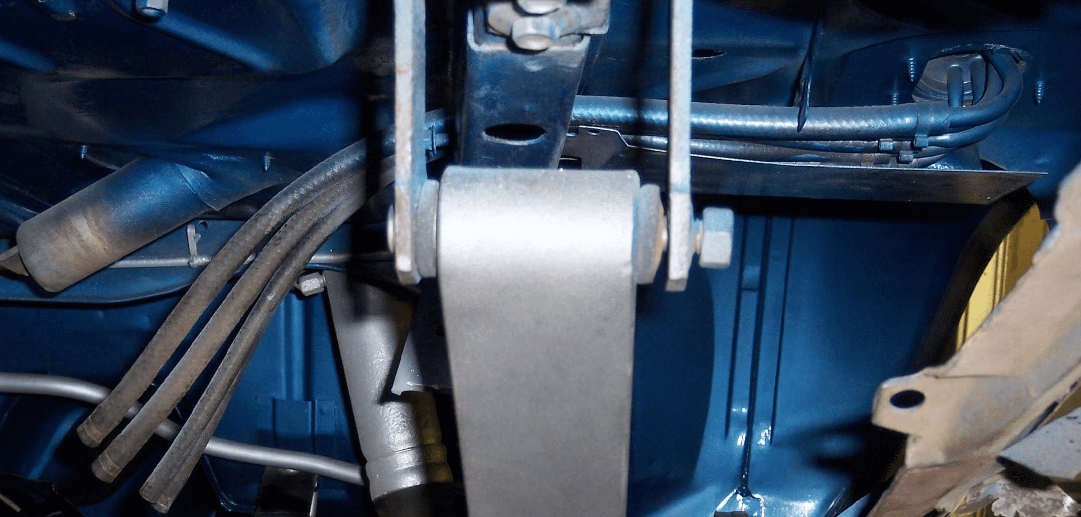

with the heat shield and muffler in place. cannot see without nmirror

filler neck first, the all those lines going to tank. does your car have the vapor recovery device in the trunk???? I bought a new 5 hose tank. installing was easy. those hoses line up with each other. one line is a vent that goes to the engine compartment...back in '71 it was hooked up to the PVC system...now it is a vent when filling tank...PVC is not needed--epa crap. just get a breathable cap. cars had those long before the epa
