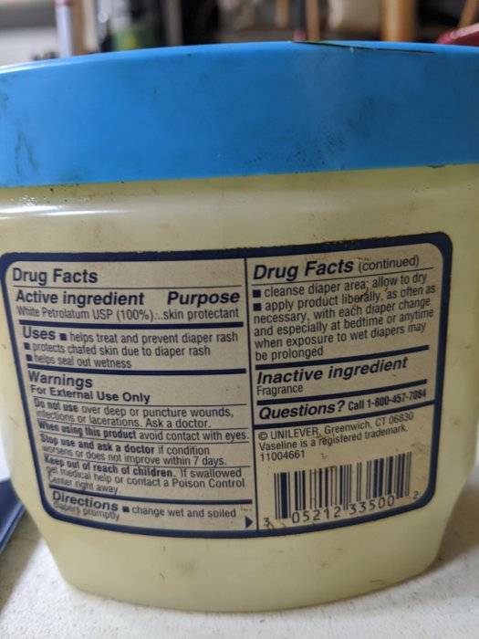

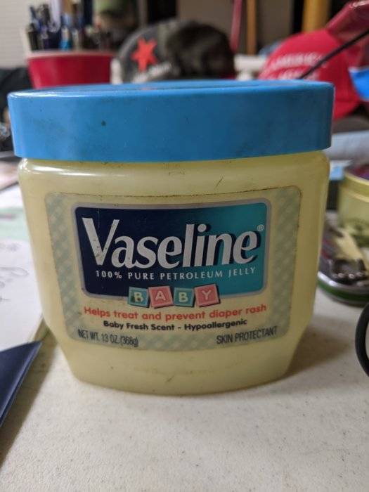

Generally the filler neck is removed first & installed last , but it can be tough to get it loose , once the neck & seal are out changing the tan seal is not hard as long as your hand fits through the trunk floor , use some lube sliding the filler neck / tube back in
I keep a small tub of Vaseline in my shop. I use it when I dont want a petroleum based product for Lube...Have used it on Fuel neck grommets often.....
It is petroleum based but it is easily broken down by gasoline. I have seen it as the recommended lube for fuel gaskets many times.
I have used it myself a lot over the years with no issues.
I use WD40 to lube the rubbers while removing things.
Thanks MoparMitch and Steve340. I actually have some vaseline in my garage from some past project. If you have seen it recommended many times for fuel gaskets and used it yourself with no issues that's what I was wanting to hear. This will be my next little project after I finish rebuilding my heater box and get it put back in.
