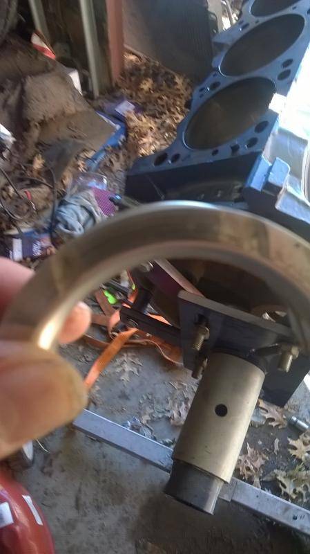

Wanting to get some insight from people more experienced then me with mopar power. I just took out my 71 340 and tore it down. I'm going as far as I can without going to a race block and heads. 71 340 (.040 overbore previously bored before my ownership) and decked block, forged 416 stroker kit for a total of roughly 418 ci. 71 X heads with a full race port and polish, performance valve job, dual valve springs adjustable pushrods, 1.5 roller rockers, port matched Mopar M1 intake. Holley 800+ CFM carb. I'm looking at a comp 20-226-4 cam with 110 LSA, 294/306 duration and .519/524 lift, The car also has Hooker super comp headers full 3 inch exhaust and a 3500 stall. I'm trying to get as close to 600HP out of this motor as I can. I know I'm probably being optimistic on how much power I can get with this setup. Anyone have some experience with how much power can be made here. I'm about to order the stroker kit in the next month or so and take everything to my machine shop.
