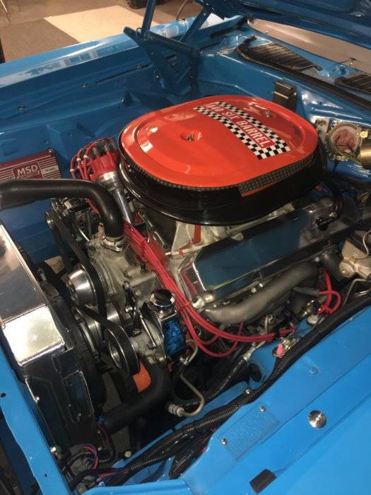

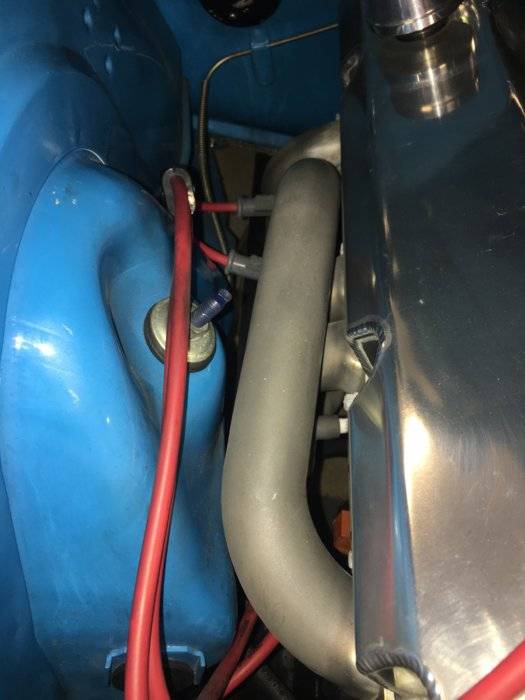

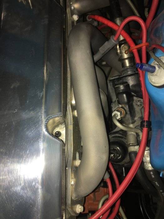

I bought part number 02-TTI440-178C4 (1-7/8 ceramic coated w/TB) and (0200-RED30x30x5a-440) angle reducer set, they have been on the motor 10 years and look pretty dang good. I have never washed the engine but, I don't use mine like many of you guys do. Just don't have the time. Overall it's the best set of headers I've owned. I paid 714.85 and that was 100.00 off due to a buddy at Time Machines in Tampa. Bought them directly from TTI. let me throw this in. I did a BB 69 camaro for my boss several years ago and used Hooker shorties. Sent the Headers and the entire exhaust system to JETHOT. I have to say, those guys do a great job. It's pricy though. Crap, everything is though. If you want a pic of mine, I can send. Just let me know.
