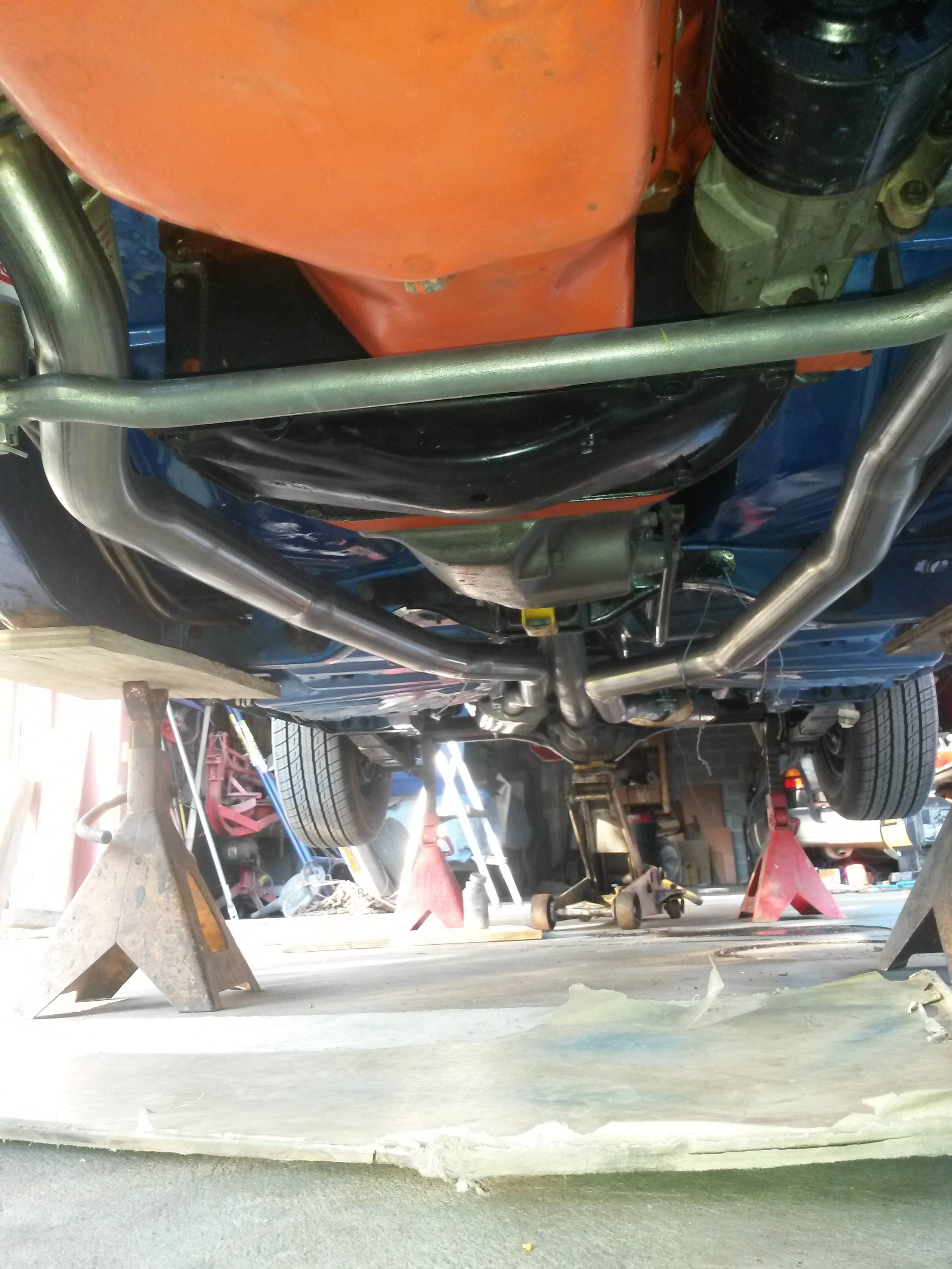

How do you get the tires jacked up that high to get that much blocking under them?
I use a highlift floor jack with a block of wood on the lift part of the floor jack. Make sure to chock the tires that are still on the ground.
I did mine with heavy duty jack stands car needs to be level concrete floor or driveway if on black top put plywood under jack stands good luck

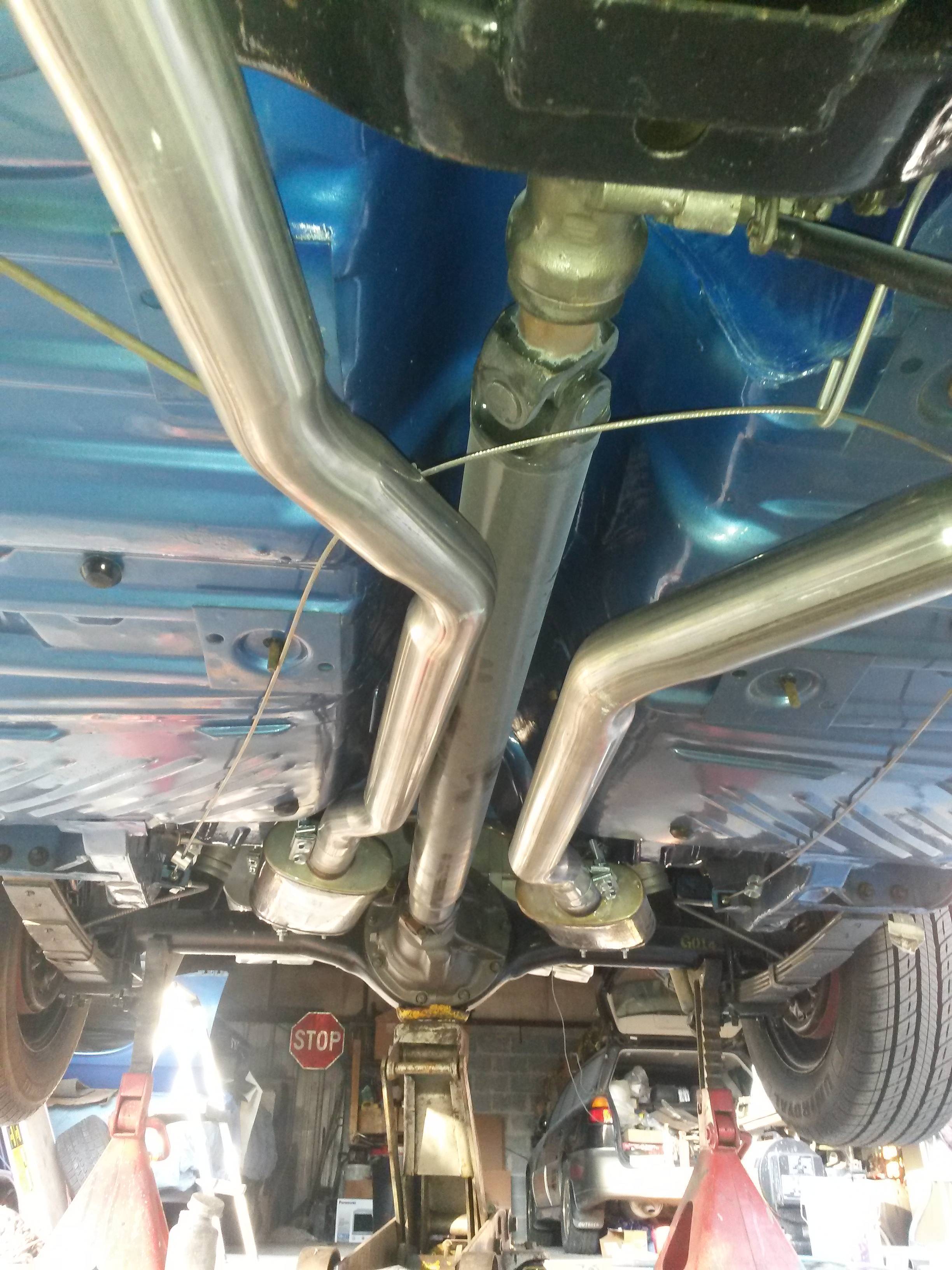

When I installed mine.Did it on 4 - 6 ton jack stand and left the 2 floor jacks under. Did not have to wrestle any thing so it was safe.
