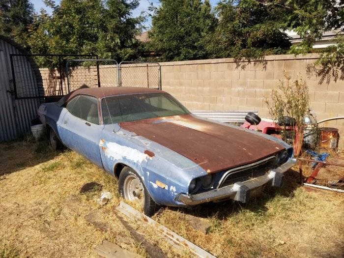

Hello everyone, I have had my e body for about a year and a half now. It is a 1974 Challenger with a 318 2-BBL that was bought by my aunt new from the dealership. When she went to get rid of it in the 80's, my dad purchased the car and continued to keep it in the family. Unfortunately, he had to park the car when he started a family about 20 years ago and it hadn't rolled from its resting place until he finally agreed to give it to me if agreed to fix it and that is what I have been doing for the last 1 1/2 years. About a year into working on it, I was able to get it running and driving again but it quickly blew a freeze plug between the engine and transmission and had to put the car on hold because I didn't have the time to fix it because I just started my Bachelors degree. When I finally found time to work on it again I found this site when looking for freeze plugs.
I actually got very lucky with the condition of it. There is a fair amount of surface rust but it is extremely straight and no rust in the floors or rocker panels. trunk is thin and needs to be replaced but has not rusted through yet. It is going to be a long journey but I am definitely up for it. The picture is from the day I towed it home.
All recommendations/ tips welcome.

Hello moparleo and thank you for the advice. So far this is a list of the things that I have been able to do to the car and thankfully they match your list for the most part.
For the fuel system, I have replaced the fuel pump, gas tank, fuel sending unit, rubber hoses, as well as rebuilt the carb.
For the cooling system, the radiator has been removed and rodded out, I have gotten a new radiator cap as well as upper and lower hoses,thermostat, the water pump was replaced after the first start and I realized it was leaking. There are also new coolant and vacuum hoses all around. No old rubber hoses.
As far as gaskets go, I have replaced the differential gasket as well as the axle flanges, transmission gasket as well as the oil pan gasket and. I'm sure there are a few more but I can't think of them right now. Still need to do the pinion seal.
For the braking system, There are new rubber hoses all around as well as new wheel cylinders, drums and brake shoes. For the front, there are new bearings (made sure to pack them really good), seals, rotors, calipers and pads.
The oil,fuel,air, and transmission filters have been replaced.
Other things I have done are replaced the motor mounts, all hose clamps with new ones, belts, new set of tires, and greased everything that needs greasing and replaced all fluids(oil, transmission,power steering, brake, differential, and coolant)
This is the majority of the things I have replaced before trying to start it for the fist time.
Unfortunately, the car did sit outside for the 20 years it sat and I never thought to check the wiring very well so that is something I probably need to do pretty soon. I hadn't pulled the engine but it is out now and I am replacing all the freeze plugs while it is out. I will probably go ahead and clean it and give it a coat of paint while it is out.
Is there anything else you could think of I should do while it is out of the car?
Thank you again for all the advice.

That sounds great. I am glad that you touched almost all of the bases. I would still look to change the metal fuel and brake lines as well. They are made of steel and corrode from the inside out, so you don't want to get a surprise fuel or brake fluid leak when you are heading down the road. An exhaust upgrade would also be a good thing to do as the muffler and exhaust pipes are probably not in great shape either. Take photos and post them for our members to see. Some are in the process of doing the same things that you are and photos are a good motivator to keep going.

Welcome you can treat the surface rust with a phosphoric based rust inhibitor doesn't look too deep.
All the parts Leo listed are available & don't run into a lot of cash the more you can do yourself the cheaper it will be & also add to your learning curve.
I would probably replace the Trans rear seal & universal joint as the grease & seals would have dried up also unplug all the electrical connectors & give a shot of contact cleaner
