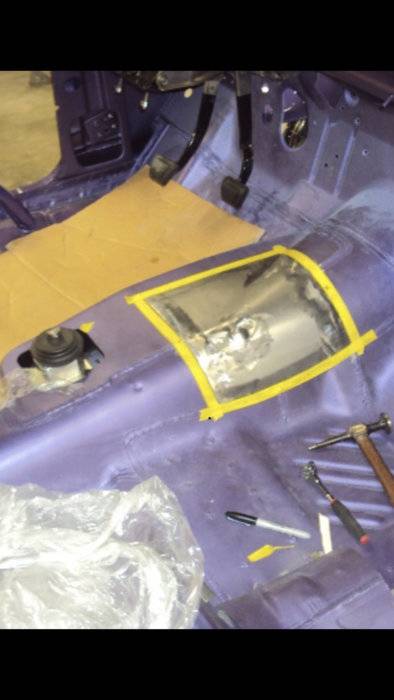

Agree 100% on the 5spd love it..but I did have to enlarge the RH side of my tunnel to clear

how much did you have to enlarge it?
Not a lot it actually came with a template. On a side note my car was an automatic originally. So maybe that part of the tunnel is a little tighter there than on an original 4spd car.

Mine came with the template as well. It’s been a while for mine but, I think Keisler sent a piece of sheet metal as well. For me it was already a manual ((3 speed) car, didn’t need it It all fit just fine.
