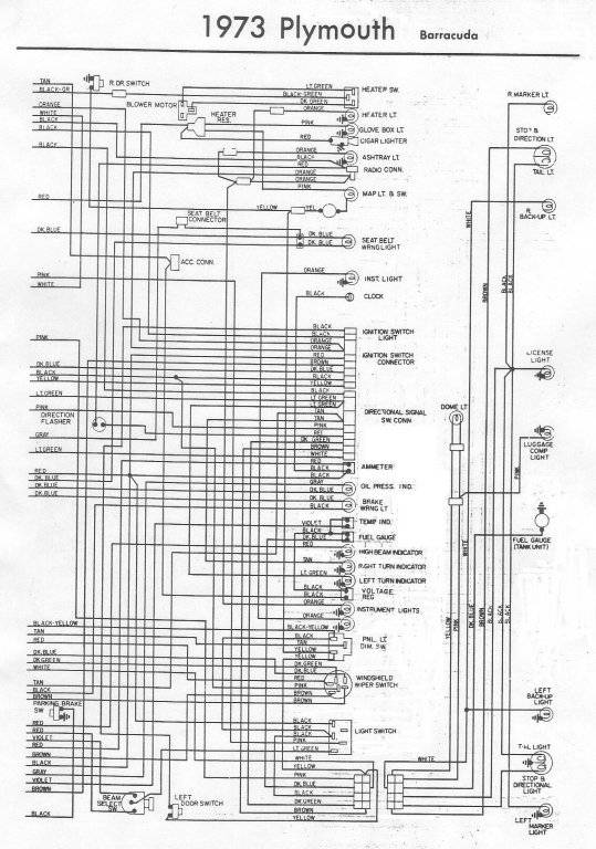

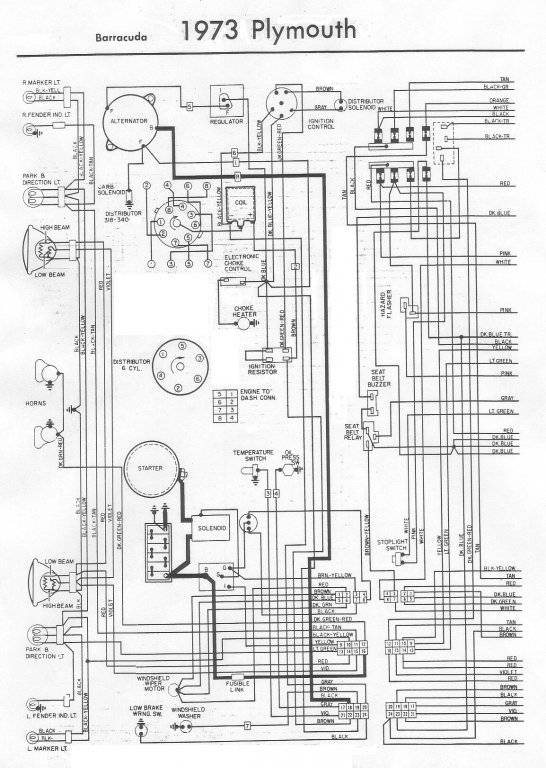

ok first my headlamp switch when i turned on the headlamps the parking and tail lights would go off.I took the switch apart and cleaned it that worked but I still don't have any dash lights come to think of it I don't think I have power to the gauges either. any help
