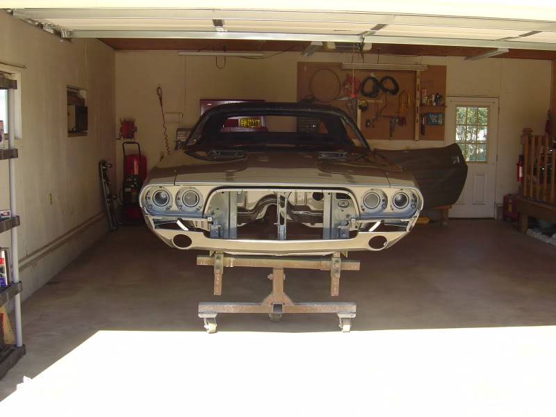

Well, here are the most recent pics that I have. I'm going out to Ohio Wednesday night to look at the car before going to the Mopar Nationals.
I'm hoping the car is painted. If it is, I'll have some new pics to show.

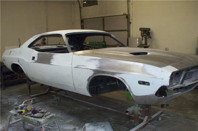

These pictures show the front fenders are on as well as the hood and trunk lid. The car was almost ready for primer in these pictures.

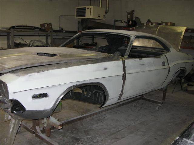

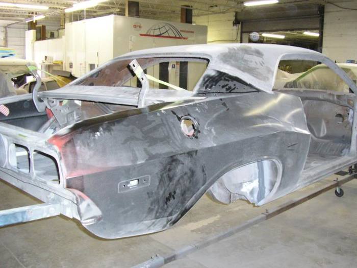

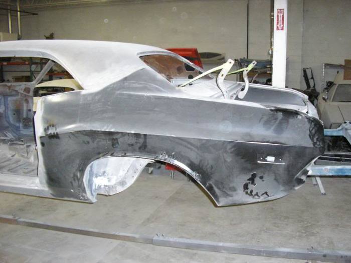

Here's some more of the bodywork.
Tim is a perfectionist. Once he started working on the car himself, he decided that there was a little too much filler on the car. Since he doesn't paint over anyone elses work, he completely stripped the car back down to bare metal.
I didn't mension it before but lower door skins were installed to fix some rust as well as an old repair that was done in the late 70's. You can see the repair in this first picture.

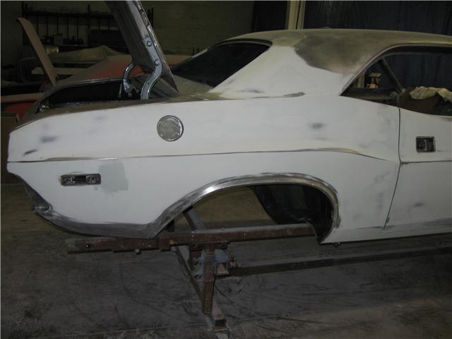

Back tracking a little bit, here are two pics of the new full quarters. They are Goodmarks. They didn't need a lot of work but did need some. The fuel filler hole isn't stamped deep enough. That area needed some work so the fuel cap would fit the body. There was also a small bodyline issue that needed some attension tward the back of the car. All things considered, the Goodmark quarters fit very well. They are a little thinner gauge than stock but undercoating was sprayed on them inside the trunk for added durability and protection...just like the factory did. Unlike the old quarter skins, the Goodmark quarters are really good in the side marker light area.
Tim insisted on having all the parts that would be installed on the quarters so he could make sure everything fit properly. I purchased all new wheelwell trim as well as the tail panel trim. I bought new side marker lights and sent the bumpers and fuel filler kneck/cap. All those parts were fitted to the car before paint.

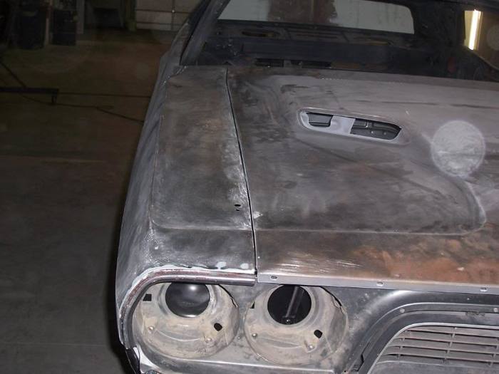

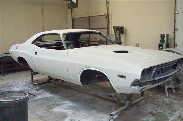

The replacement front fenders that I had purchased were rust free but had seen better days. The drivers side fender had some accident damage around the side marker. I didn't know it at the time but the accident had also sprung the fender and it was way out of wack. The passengers fender had a lot of small dents and dings in it.
After trying to fit the fenders to the car, the decition was made to use a pair of new Goodmark fenders. That may or may not have been a good choise but that's what was used.
The Goodmark fenders needed a lot of work. The passengers lower body line was a half inch off. The fender had to be sectioned so the bodyline would match the door.

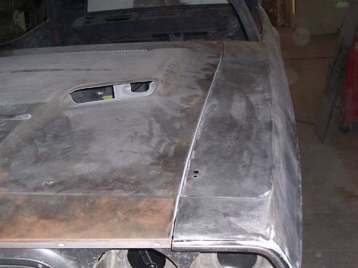

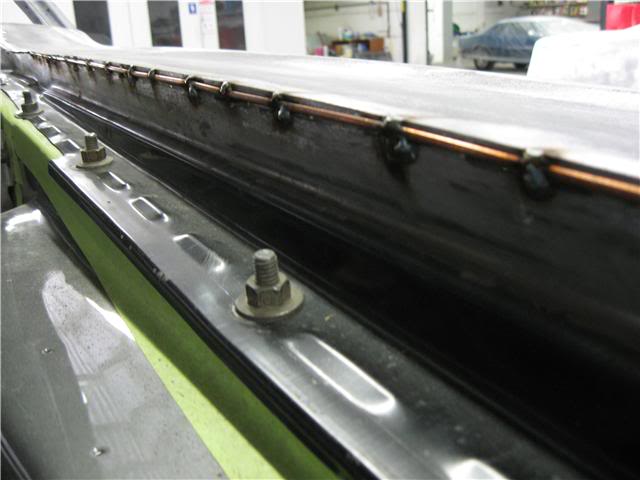

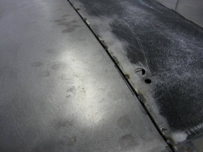

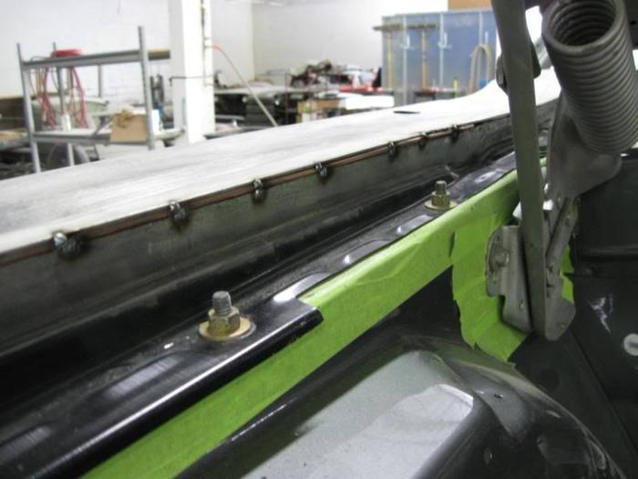

The other issue was how the fenders matched the contour of the hood. The hood hinges were sent out for a rebuild first, then installed on the car. With the hood adjusted as far down as possible, the fenders still sat 3/16" lower than the hood at the rear. Tim cut both fenders open along the top where they meet the hood. He then lifted the top of the fenders up inline with the hood and welded the gap closed. This allowed him to line up the fenders with the hood but also let him adjust the hood to fender gap at the same time.
Here are some pictures of the welding rod that was used to close the gap created by cutting open the fenders.
burdar
Jul 10, 2009
521
30
IOWA

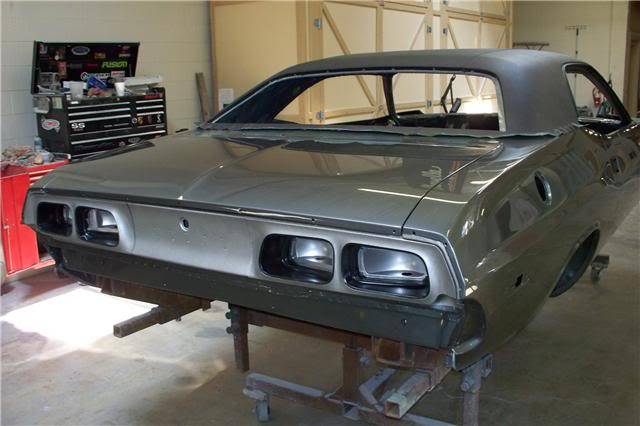

The end result is roughly a 3/16" gap between the hood and the fenders. All of the gaps were done this way. Welding rod was welded to the front of the doors and to the sides of the trunk lid to get all the gaps the same.

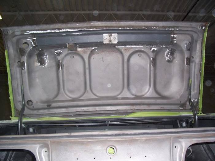

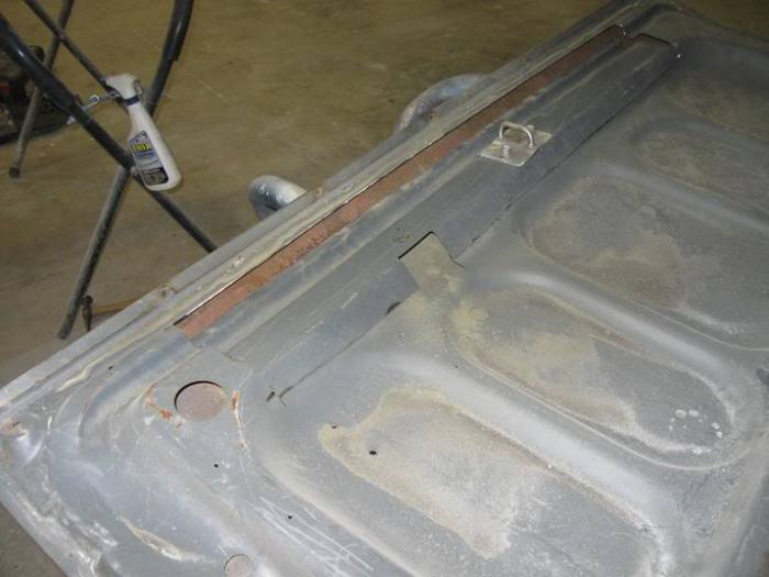

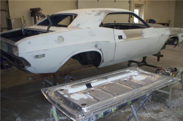

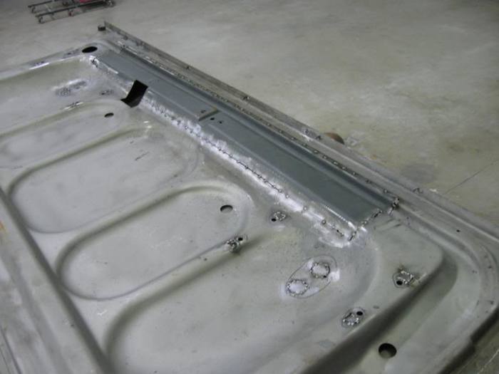

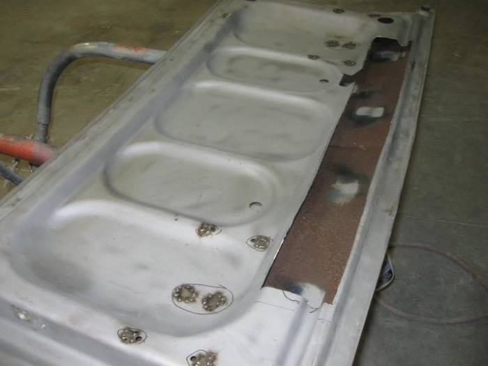

The area that Tim really helped me out with was the trunk lid. I bought a rust free 70-71 style lid years ago before new ones were being made. The outside of the lids are the same from 70-74 but the inner structure changed. 70-71 lids have holes in the framing for mounting the different spoilers that were available in those years. Since there were no spoilers available in 72-74, those lids don't have any of the extra holes in them.
For some reason, those extra holes really started to bother me. I had an extra trunk lid lying around that was the 72-74 style but it was rusty in the back lip area. Someone had also installed an aftermarket spoiler on it at some point, so there were four holes drilled in the top of it. I called Tim and asked how much money it would take to weld up the extra holes in the deck lid. I told him that he could cut up the extra lid to use for parts.
Tim said it would be pretty time consuming and it would be more cost effective to just buy a new lid without the holes in it. The problem was that he had already fit the 70-71 style lid to the car and had welded rods to it to even out the gaps. If I bought a new lid, he would have to re-gap the lid and basically start over. I told him not to bother and I would live with it. If anyone came up to me at a carshow and said the wrong trunk lid was on the car...I'd just tell them to mind their own business.
Well, a few days later on a Saturday, I got an e-mail from Tim. He said that he was having a good day in the shop and decided to fill in all those extra holes for me. He didn't want anyone to question the trunk lid so he just cranked up the 80's music and started welding. The best part was that he wasn't going to charge me for it. He said it was the least he could do since I was having to wait so long to get the car back.
Section of the junk lid was cut out to use on the good one.
Small holes already filled in on the good lid and the latch area cut out.
New piece welded to the trunk lid.
Finished lid mounted on the car.

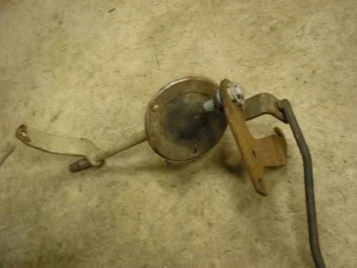

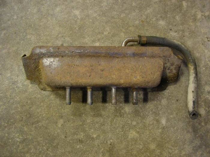

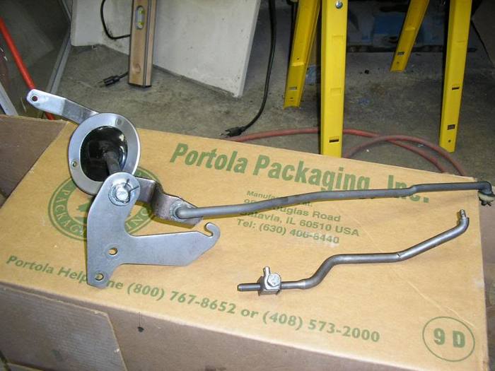

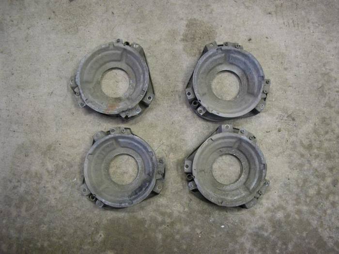

Here are just a few things I've been working on.
trans linkage before
trans linkage after

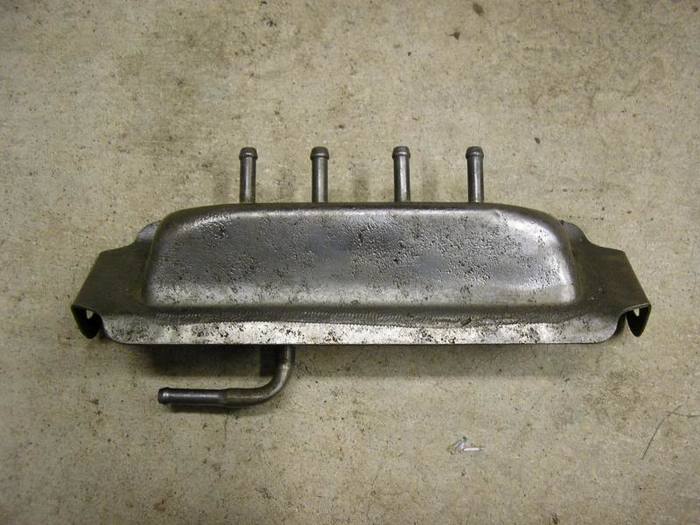

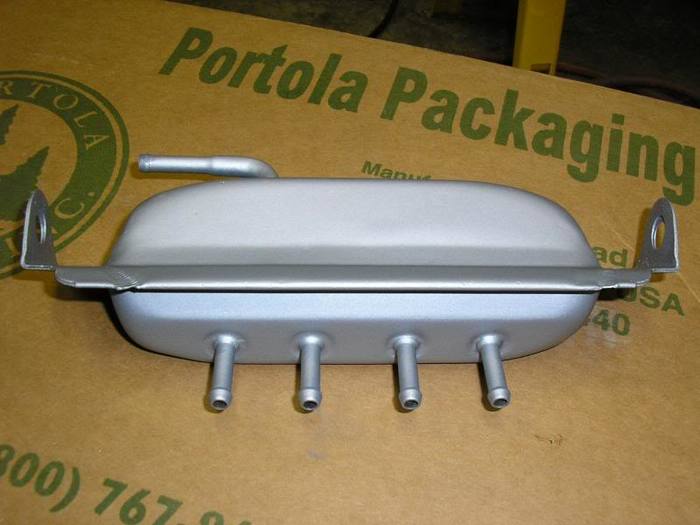

vapor separator before
vapor separator cleaned and all pin holes brazed
vapor separator smoothed and painted

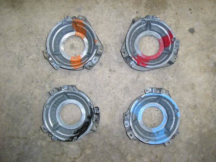

headlight buckets before cleaning
headlight buckets after hours of cleaning and paint marks reapplied.

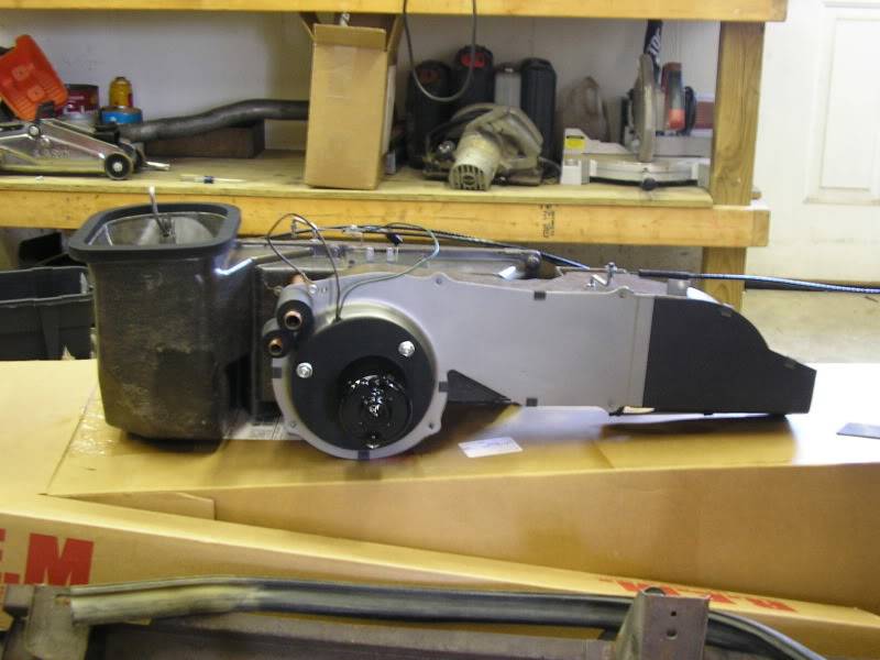

I have the heater box all apart and am about half way through its rebuild. I bought a gasket kit from Detroit Muscle Technologies for the build. The blower motor is apart for inspection and painting too.

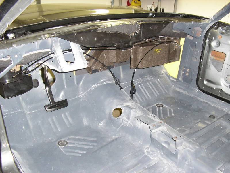

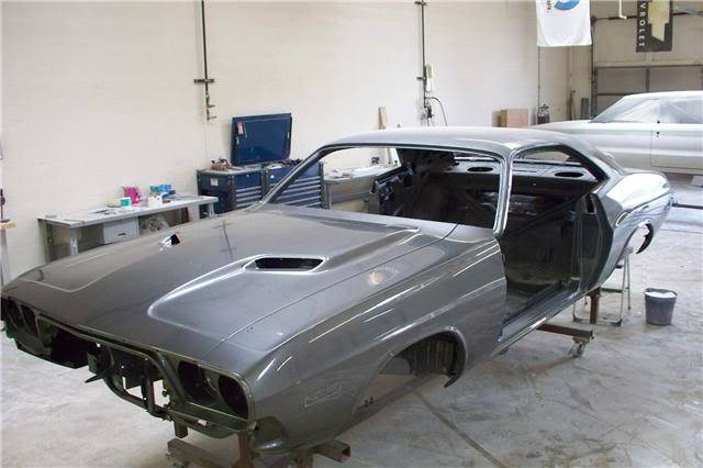

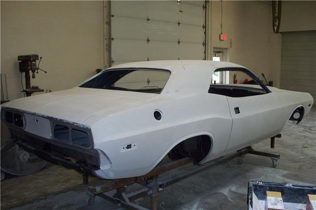

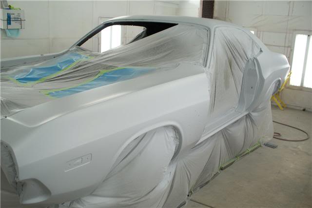

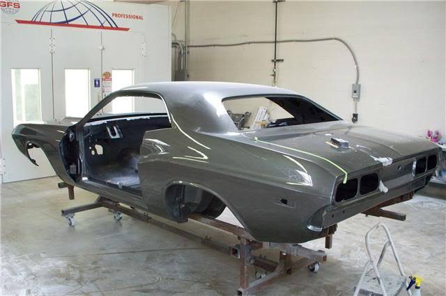

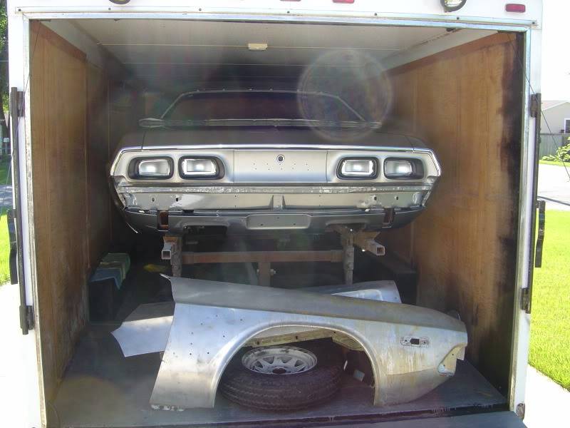

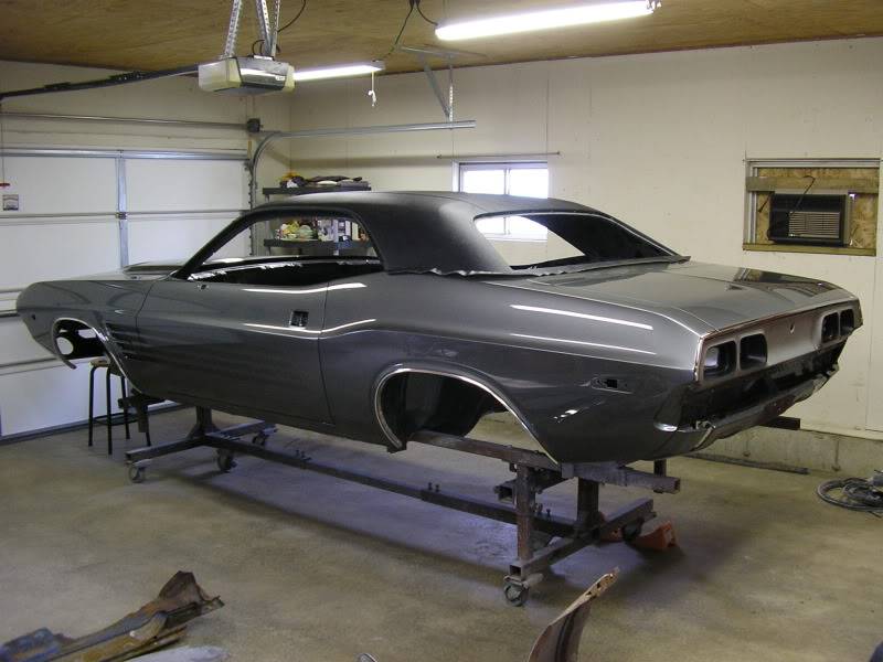

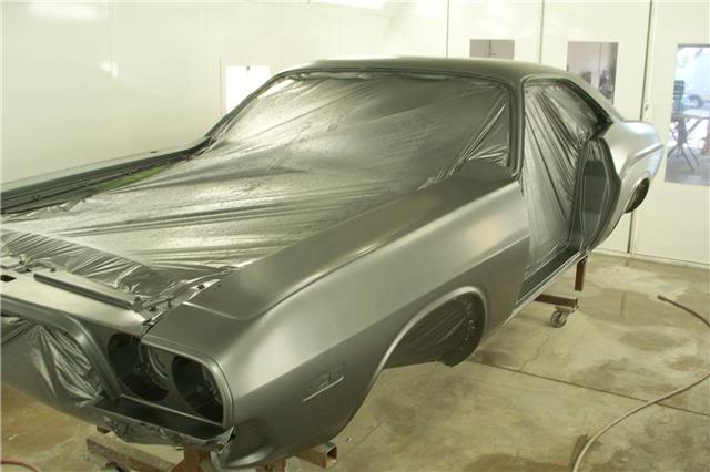

Going to get this thread up to date. I got the car back the day before Father's Day.

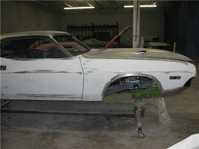

Filler work...
polyester primer
primer sanded

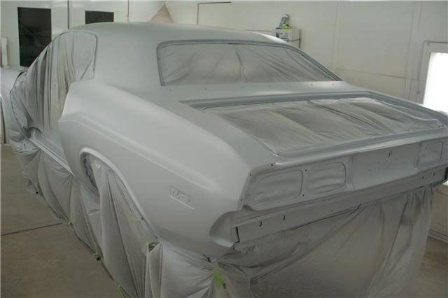

final primer
burdar
Jul 10, 2009
521
30
IOWA

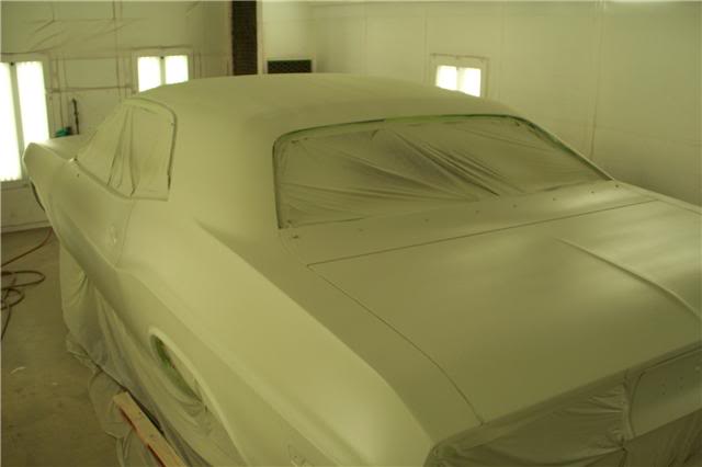

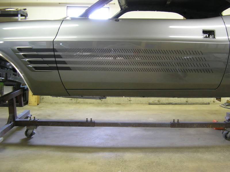

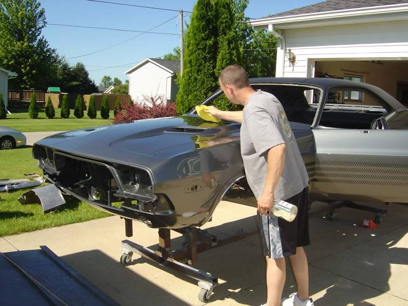

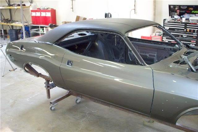

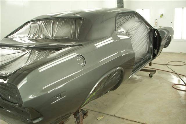

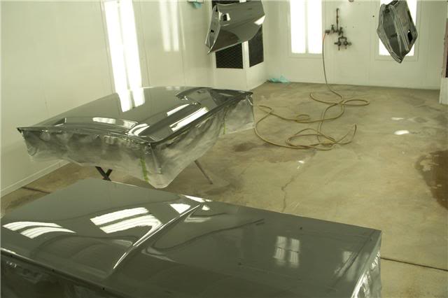

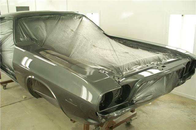

base coat
clear
wet sanding
vinyl top and argent paint

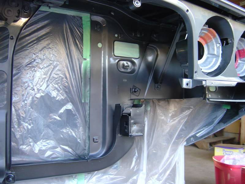

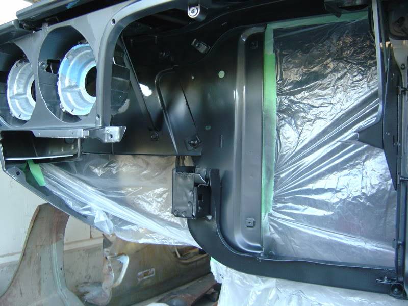

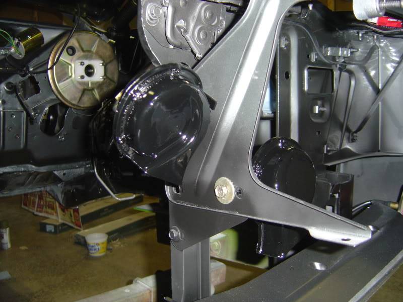

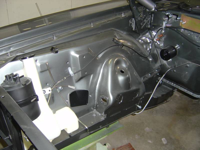

headlight buckets installed
rad blackout

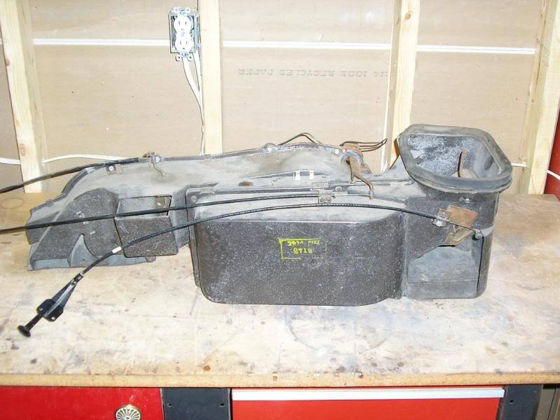

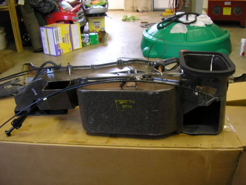

heater box before
after
installed
burdar
Jul 10, 2009
521
30
IOWA
horns blasted/painted and installed
