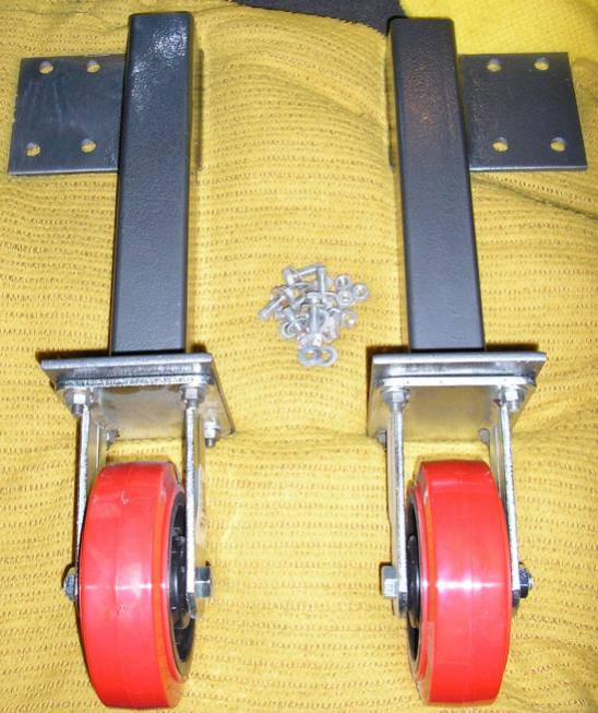

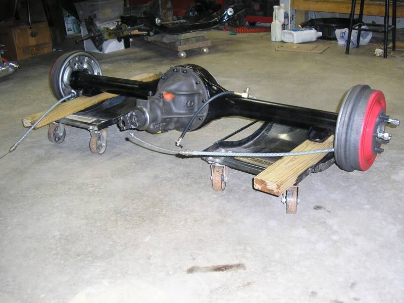

Here is a pic of my rear stands. They just mount to the front leaf spring hanger location. The front hangers bolt to the bumper bracket holes. The wheels are 6" hard rubber that I got at Menards. I have a piece of angle iron bolted in between the rear stands. I need to do the same thing in the front just so they are a littl more sturdy.

Thanks. I really need a set. I've looked for a set on the web but no luck. Those look good. Do you like those casters or do you think the inflatable ones would be better considering I have to roll mine out on the dirt from time to time?
Thanks again.

Originally I had some small 4" wheels on the stands and it was a PITA to move the car. With these hard rubber wheels it moves easily. I have no experience with the inflatable wheels.

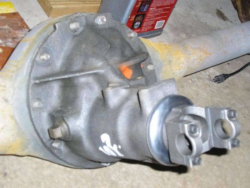

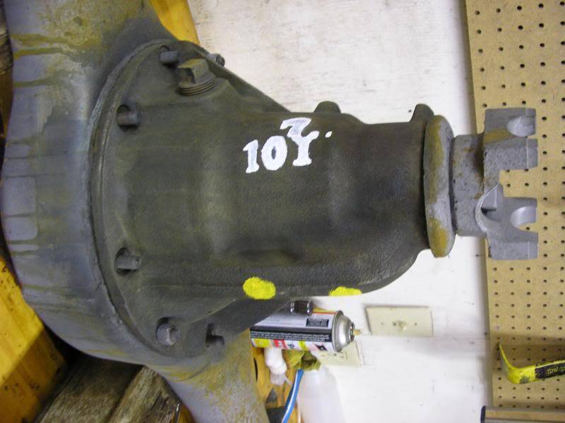

I wasn't happy with the way the rear end assembly looked so I tore it apart and redid it again.

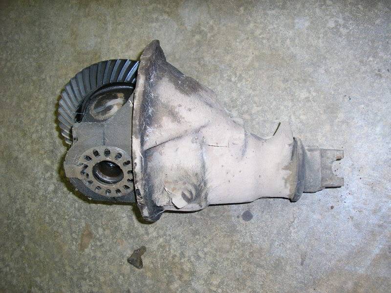

original center section/2.76 open

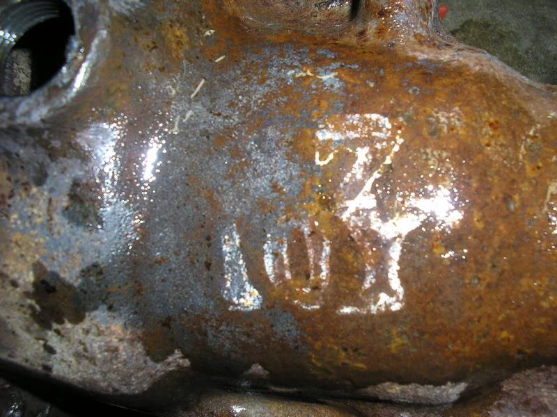

soaked in some used up EvapoRust looking for inspection marks...
two yellow dots indicate 2.76 gears
orange dot
stenciled date code possibly?
burdar
Jul 10, 2009
521
30
IOWA

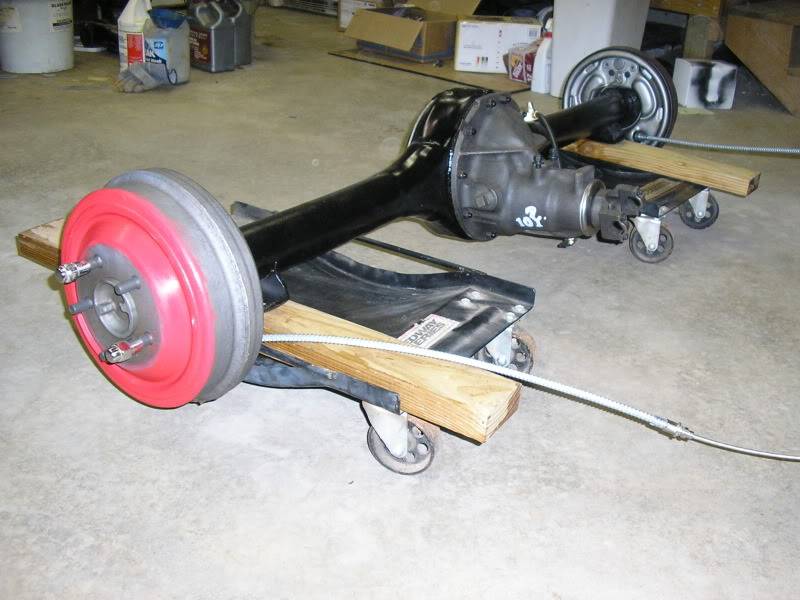

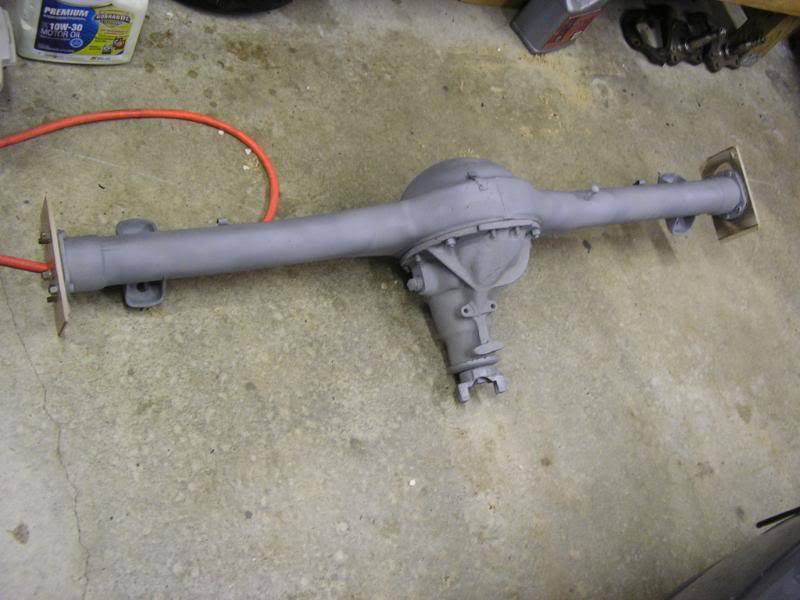

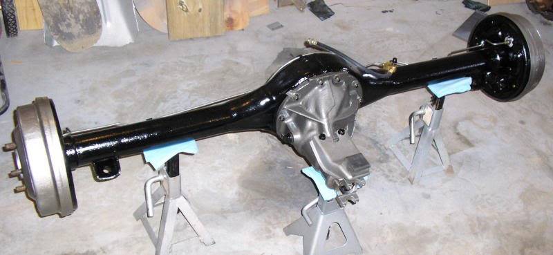

I previously painted the assembly with POR-15 and cast blast paint. To save myself a bunch of work stripping all that paint, I removed the axles and backing plates, made some wooden end plugs and had the assembly sand blasted.

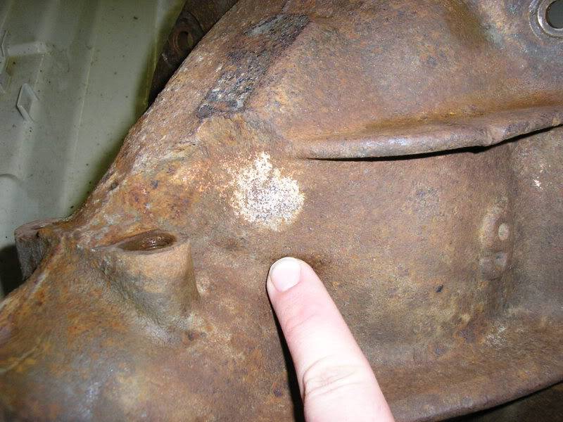

The center section I'm using is a 3.23 sure grip which was an available option on a 318 Challenger in 73. I darkened it and reapplied the markings I found on the original center section. The white section on the side didn't turn out as nice as I'd hoped. I should have used a stencil.
After RPMing and installing a new metal dust seal the center section looks decent I think.
I had the housing powder coated but the tubes were still very pitted. I then had the housing sprayed with a high build primer. The major pitting was sanded out and finally the housing was sprayed with a semi-gloss paint. I couldn't find any new factory looking brake drums so I used the originals. They were blasted...the red band was brushed onto the face and then they were RPMed.

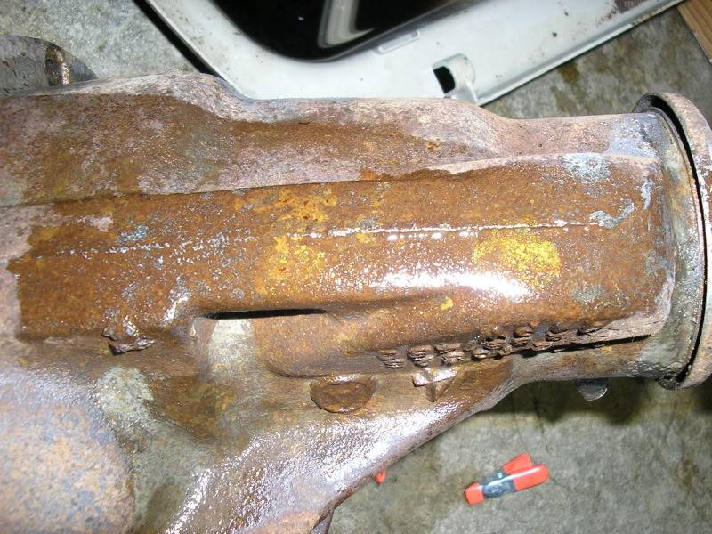

what I started with...
what it looks like now...the flash makes the drums look pink but they aren't

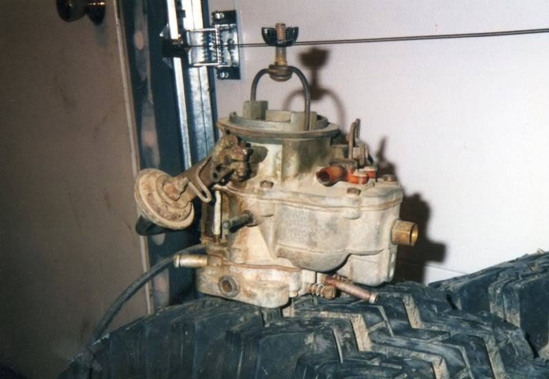

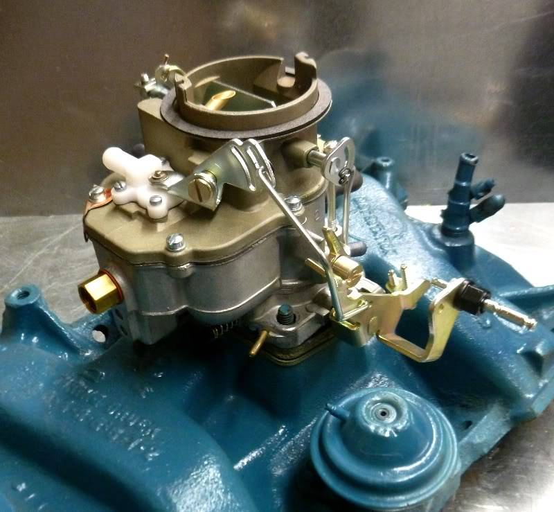

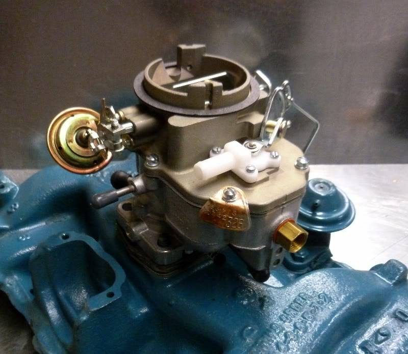

Just got the original carb back from Scott Smith.
before
after

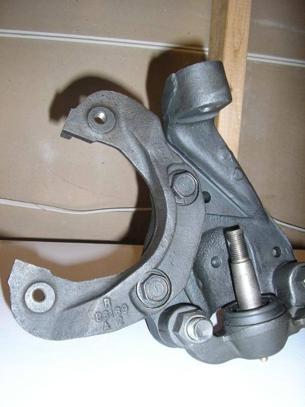

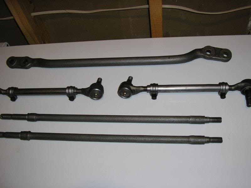

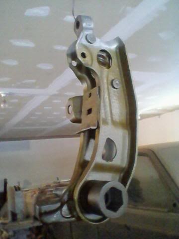

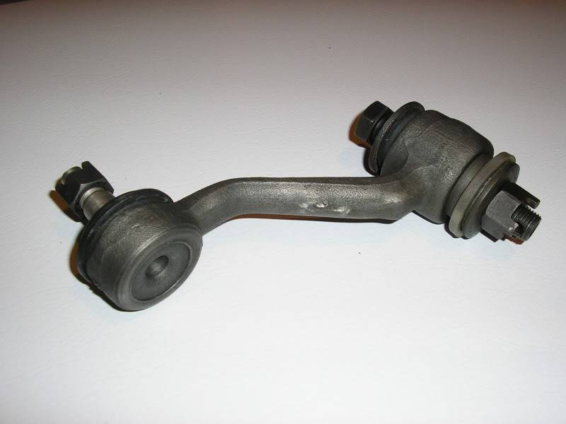

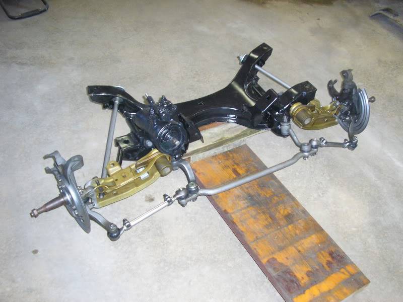

I've been using acid to clean up the suspension parts. After they are rust free, they were dipped in baking soda water to neutralise the acid. Then they were either darkened or left a lighter color and RPMed.
The original idler arm was in perfect shape. It was soaked in EvapoRust and RPMed.

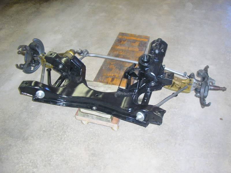

The LCA's had been painted with POR-15. I had them blasted...then I darkened the lower balljoint end, the rivets and the torsion bar socket. They were sprayed with Krylon battery protectant which imitates the look of cosmoline but dries completely. Then they were RPMed.
The K-member was powdercoated. They powdercoated the front swaybar by mistake. I was going to darken it and leave it natural. I blasted the original disc brake dust shields a long time ago which ruined the galvanized finish. I stripped off the POR-15 and lightly hit them with a wire wheel...then RPMed them. Here's the finished K-member assembly...

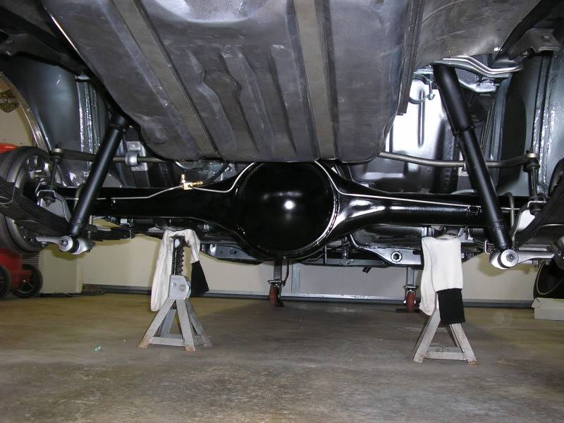

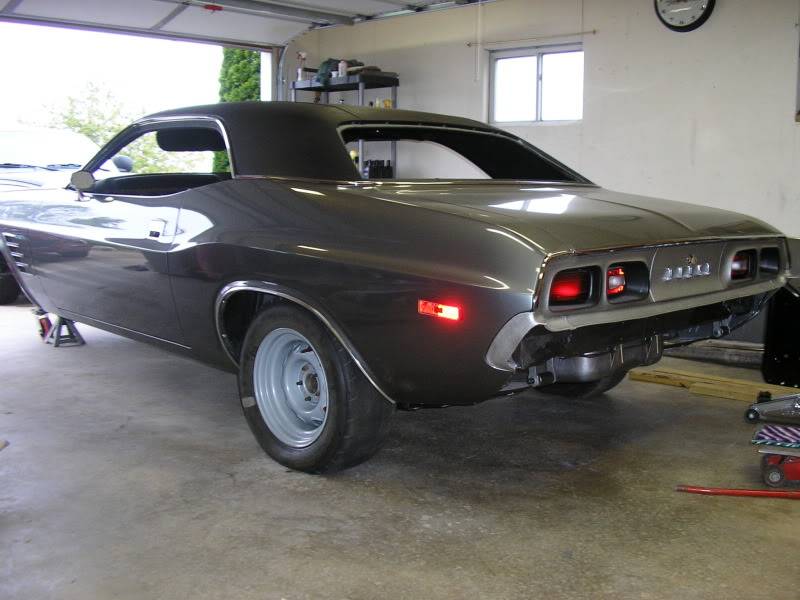

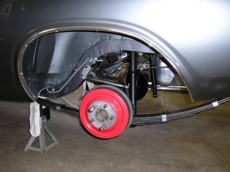

Some more progress to report. The rear axle assembly is now installed and the car is sitting on its rear suspension.

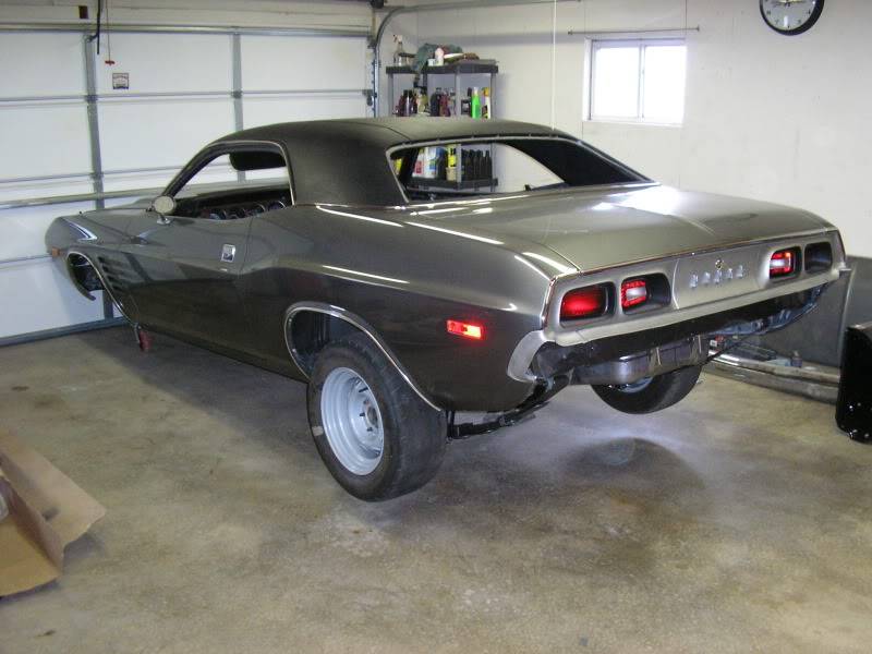

I drove out to Ohio in March to see the progress. I took the bumpers with me too. They wanted to make sure the bumpers fit the new quarters incase I decide to put the 70-72 style brakets on the car. I also took the back glass out there to double check the fitment since the full quarters had been installed.
When I was out there I ok'd a test sample of the body color. A few weeks later, the engine compartment, trunk and entire underneith side were painted. It's really starting to look good. Here are some pics.
What colour shade of gray is that....?
burdar
Jul 10, 2009
521
30
IOWA
The factory paint code is JA5. Dodge called it "dark silver metallic"...Plymouth called it "silver frost metallic". I'd have to look at the extra paint I have so see what the new code is. It's a Spies Hecker Alfa Romeo color. It was a perfect match to the original paint under the jack instruction decal.

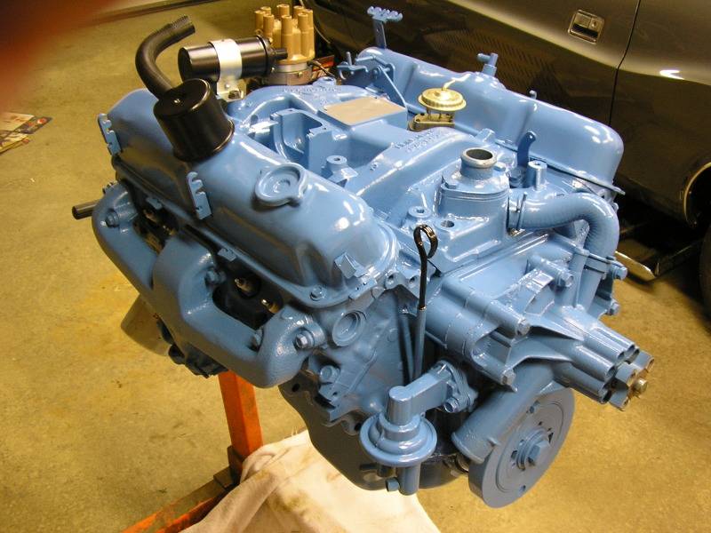

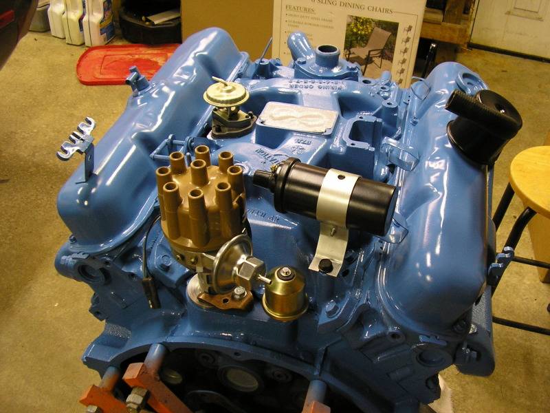

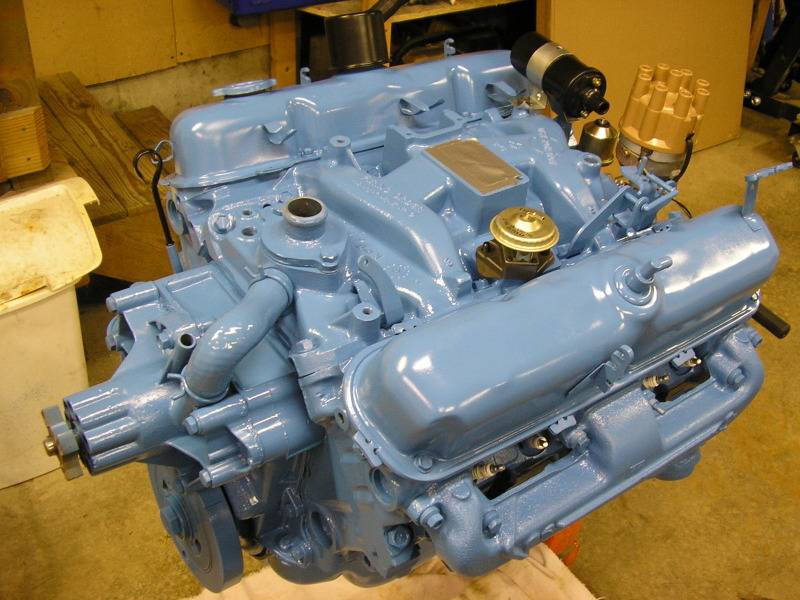

I just got the engine reassembled and painted so I thought I'd take a few pictures. I'll be working this week at getting the engine connected to the K-member and attaching all the other accessories.

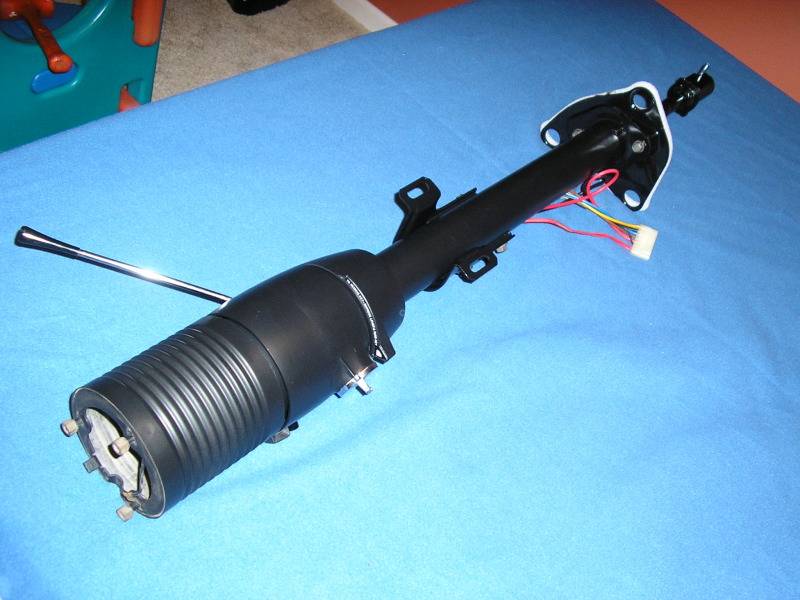

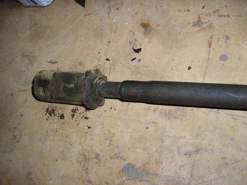

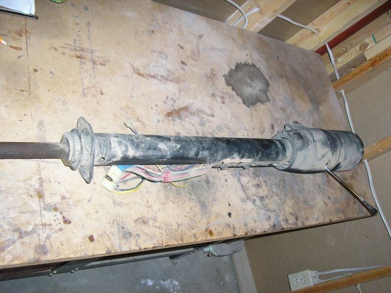

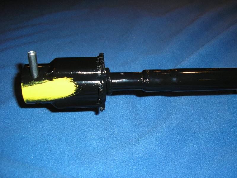

I got the steering column done last night. The rebuild went well. It's not very complicated. I just disassembled everything and bead blasted the upper parts. I hand sanded the tube since it wouldn't fit in the blast cabinet. I painted most of the pieces with SEM Trim BLack. The ignition key light, upper and lower mounts and the lower steering shaft got painted with gloss black Rustoleum. I made a new lower seal out of some scrap material from a DMT gasket kit. I still have to clean up the steering wheel.
Before...
After...
Steering coupler and shaft before...
Steering coupler and shaft after...

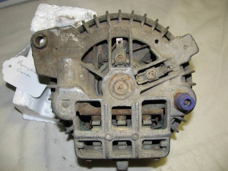

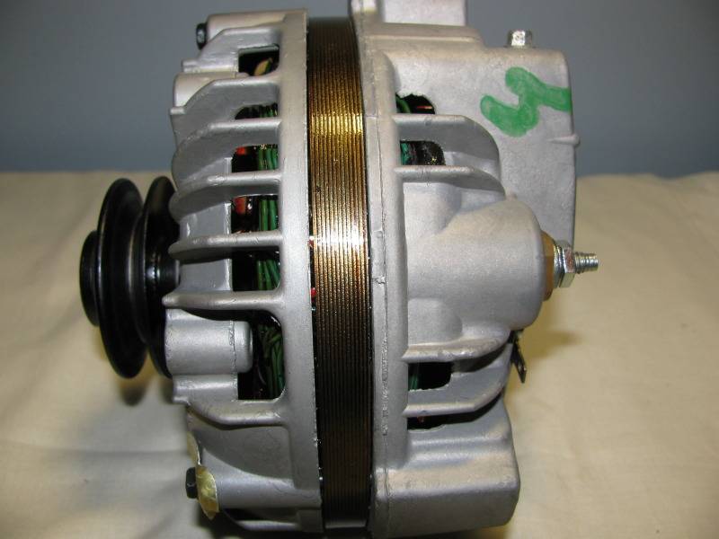

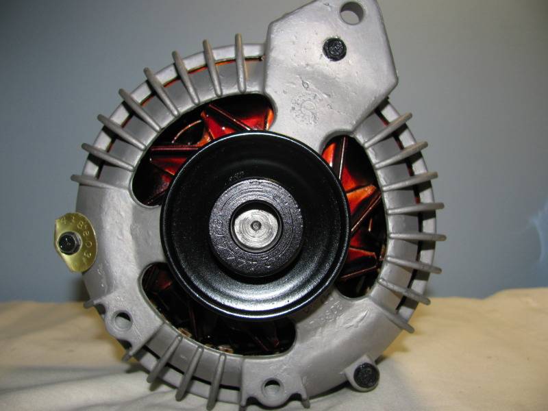

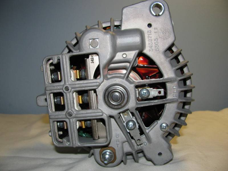

I got the alternator back from Jim Ridge on Wednesday. It looks great. The original alternator was long gone. I had a 1976 casting that I tried to refinish but it didn't turn out looking very good. I was at my father-in-laws house a few years ago when he mensioned he had a couple Chrysler alternators buried on a shelf somewhere. After digging them out, I realised that one of them was a square back and had a casting date of Sept 72. How did I get that lucky? Anyway, here are some before and after pics of it.
