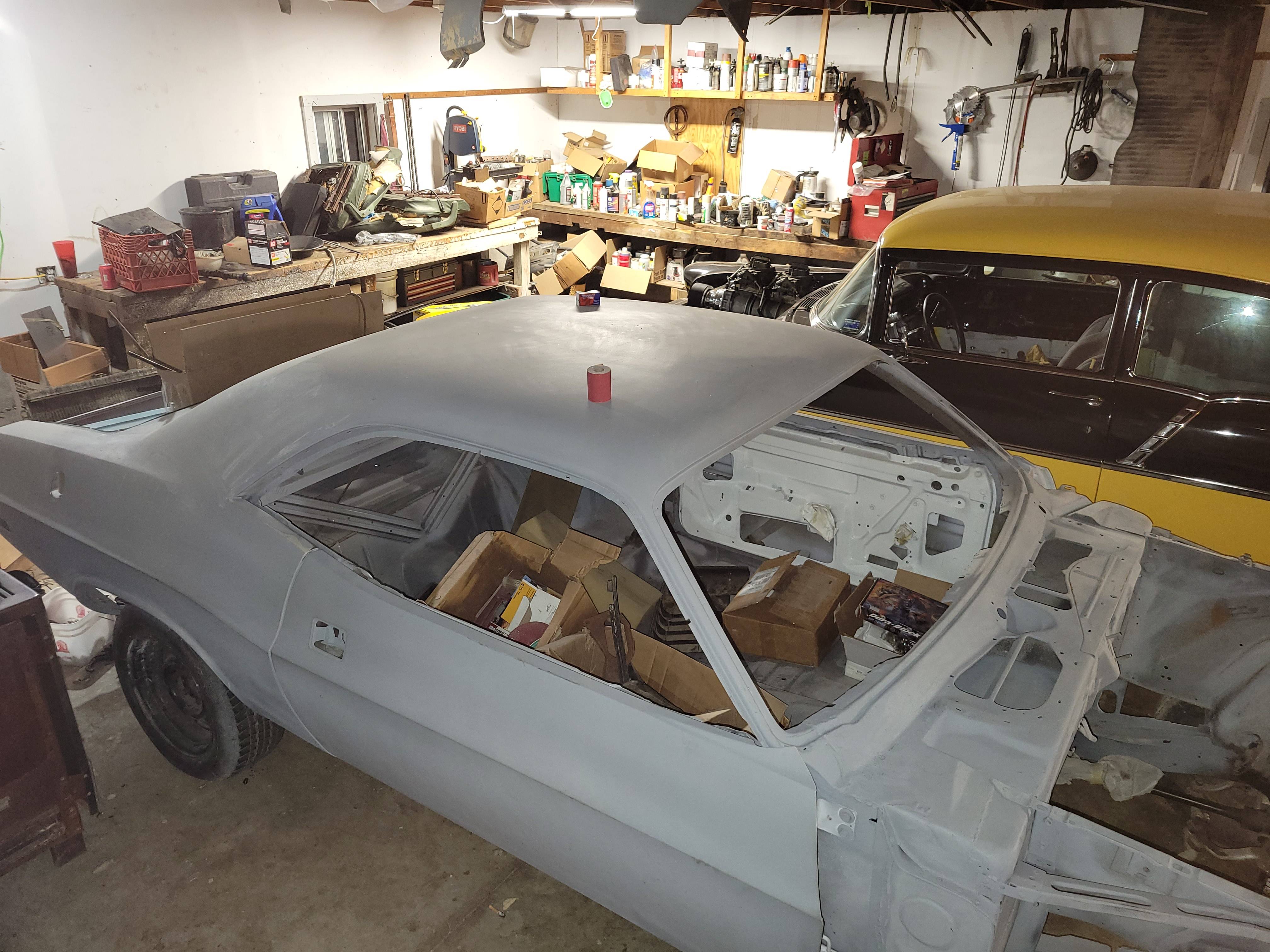

Car is overall primed, I am ready to start painting the inside and cutting in everything else. Wondering about the inner fender wells front and back ...what coating from the factory, and when was it applied in the painting process order? One other question: Were the cars of all colors primed with the same shade of primer?

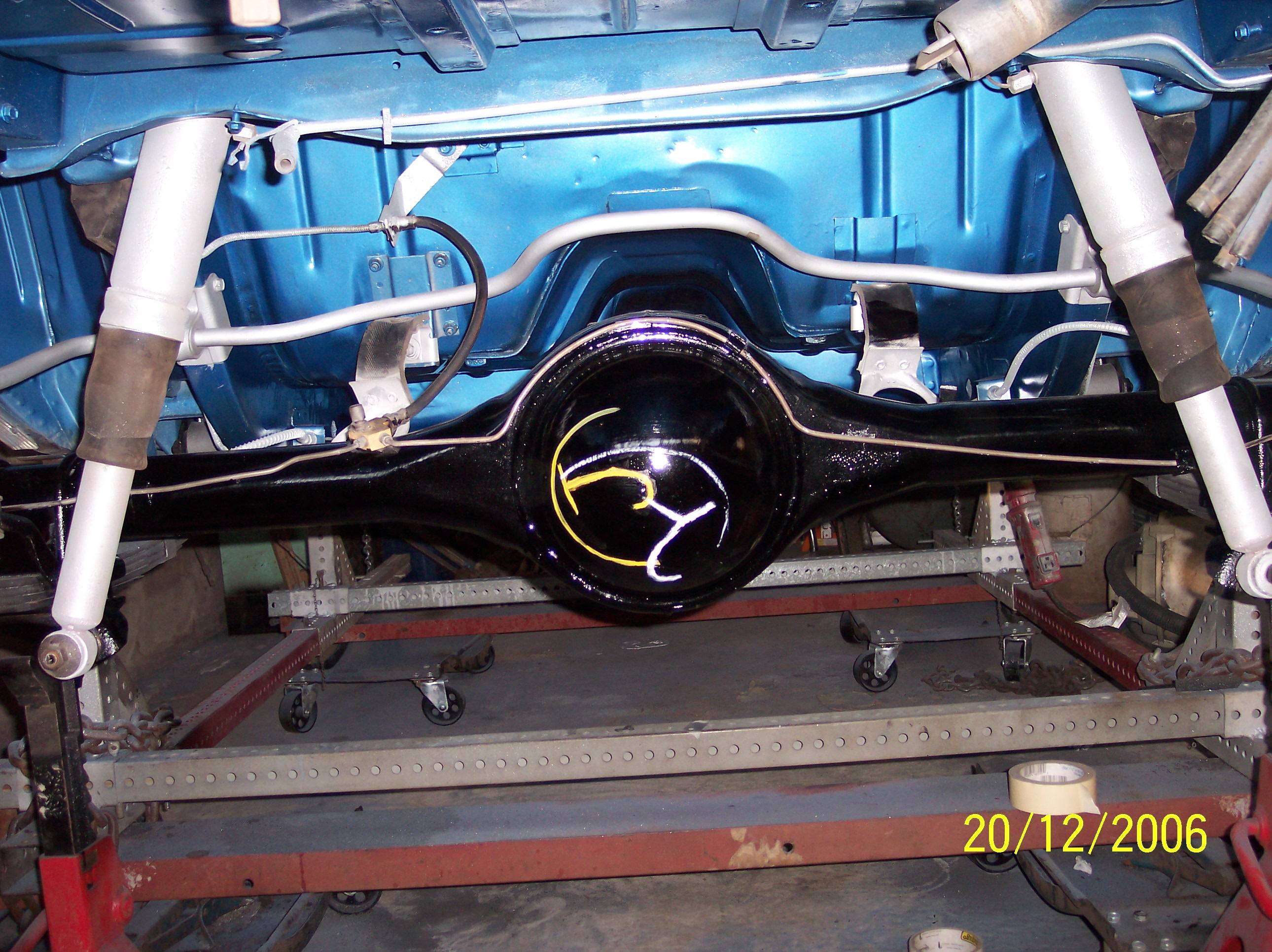

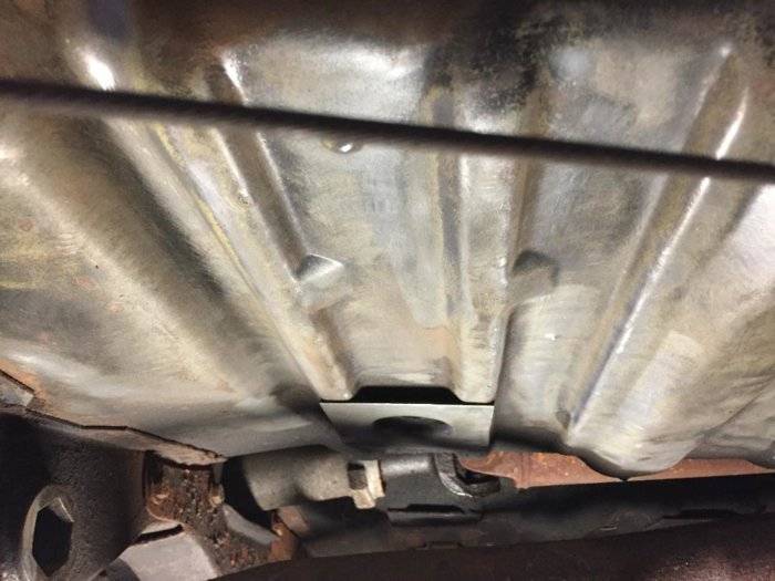

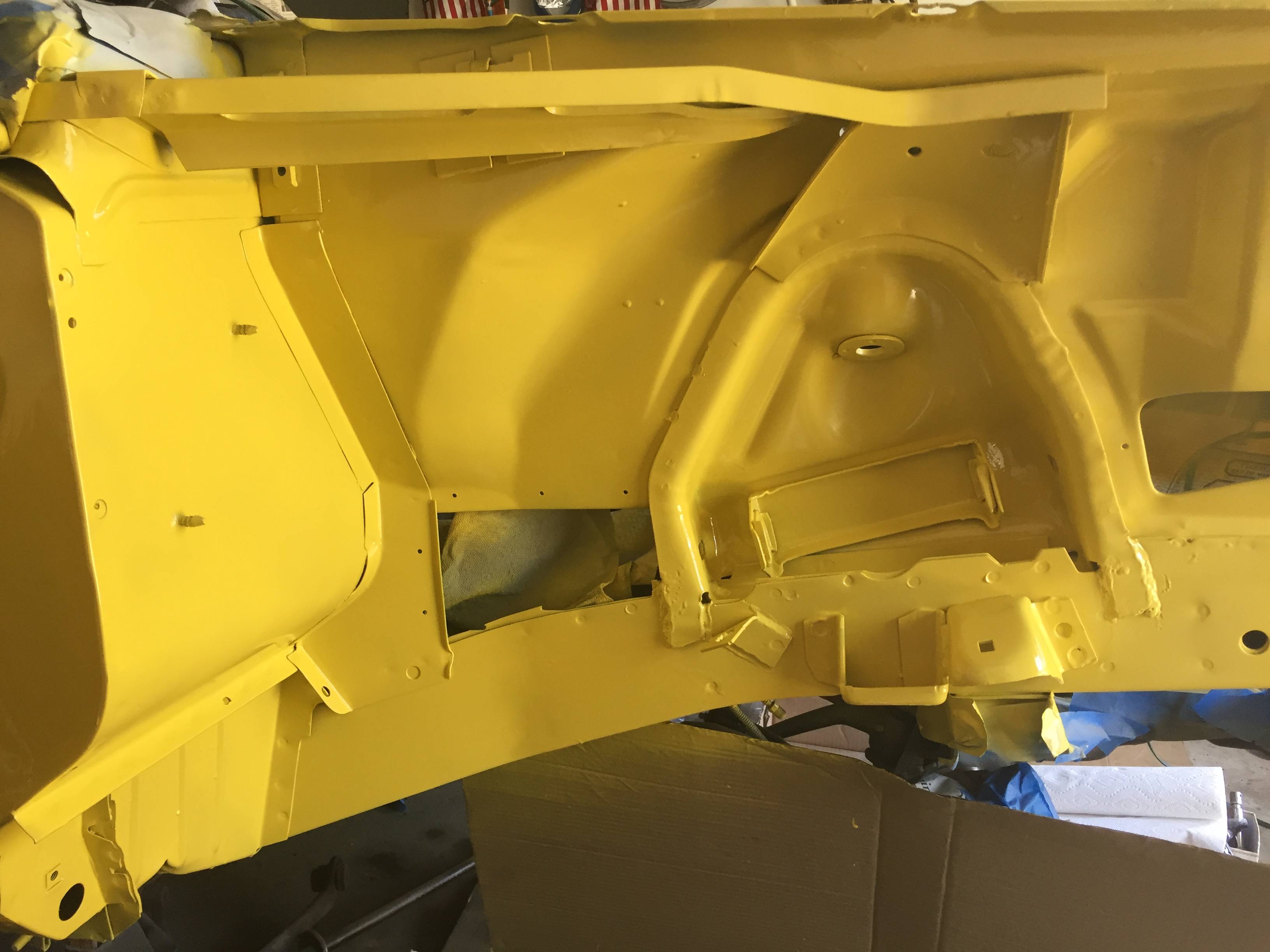

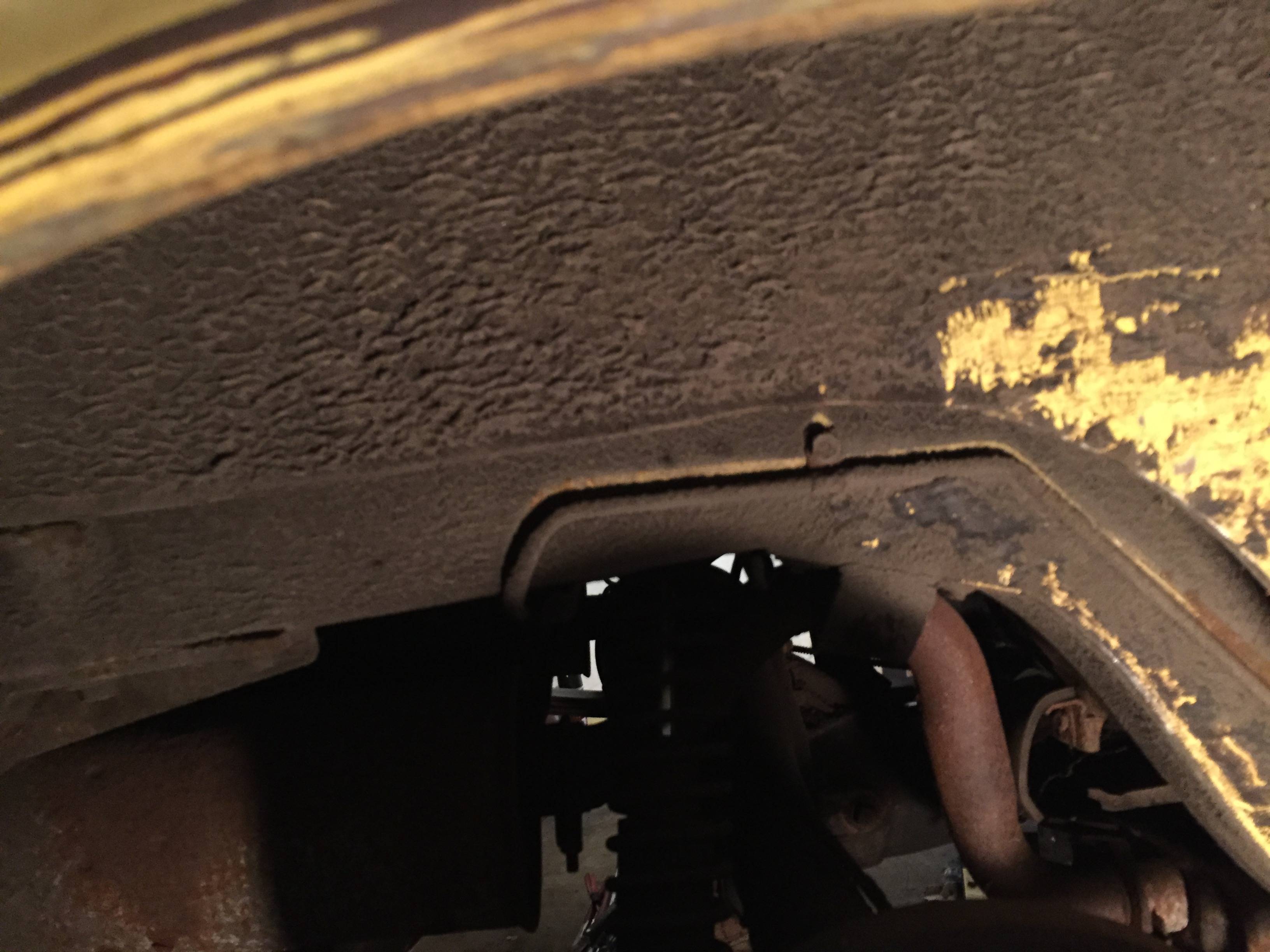

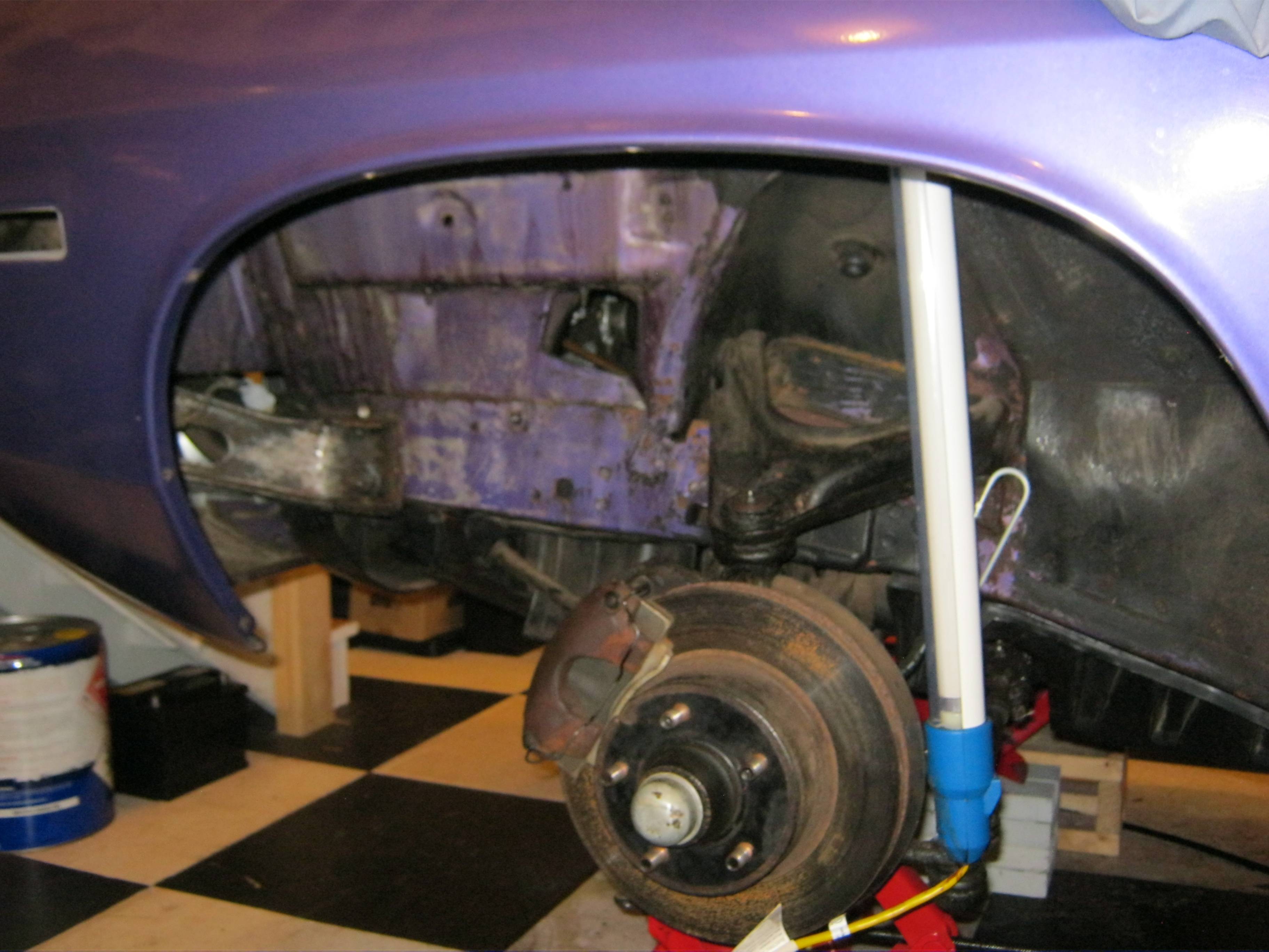

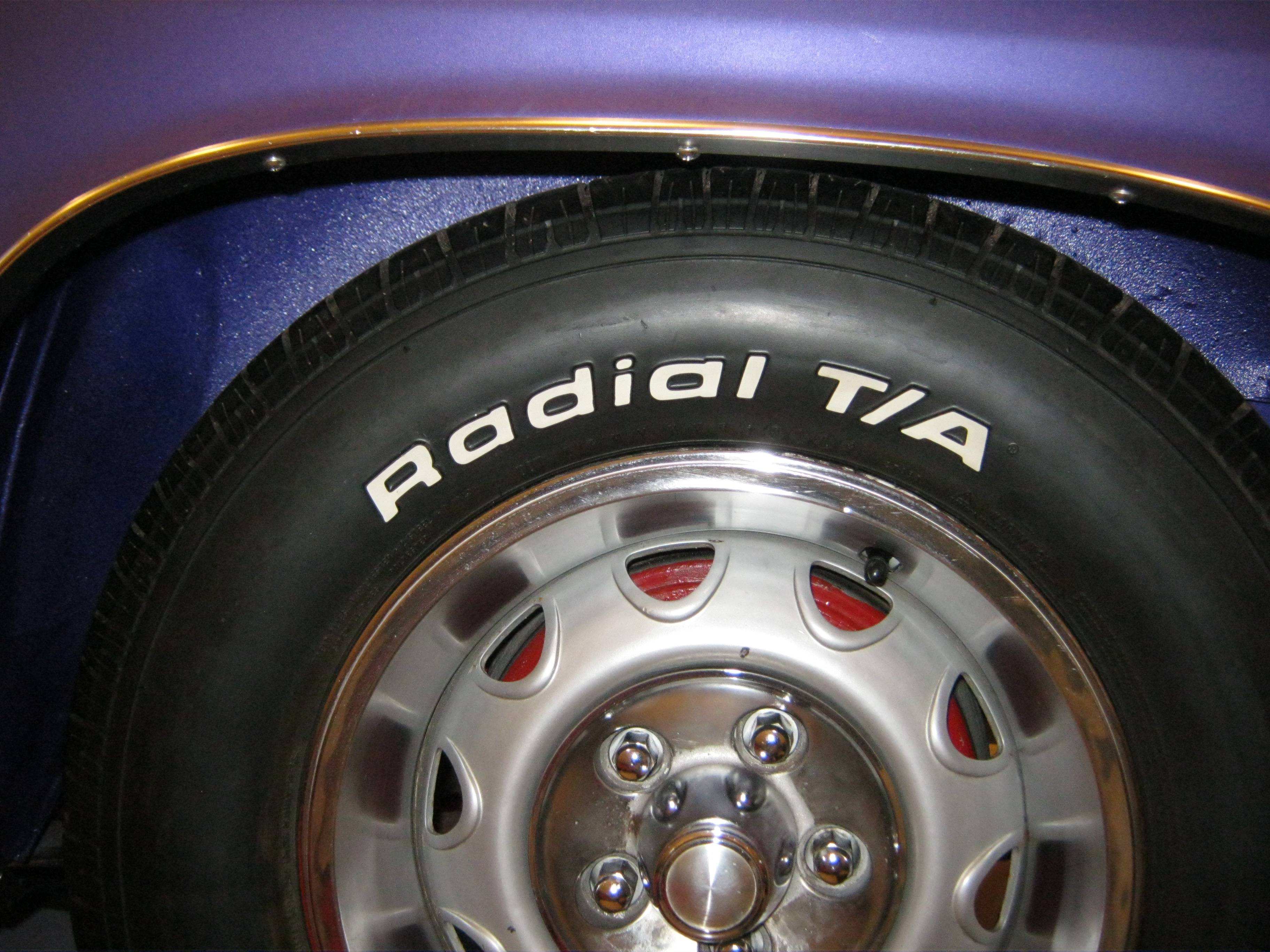

It's called VLP. very little paint. undercoating was on the under side of floor boards if it was ordered,fr usually the front frame rail area and apron. they applied it as if they didn't care. When I used a torpedo heater to remove the the factory undercoating sound deaden-er. There was no primer of any kind or paint.There was only bright metal. 1st 2 pictures show what I have seen for undercoating.3rd is what I decide what to do and top coat with KBS. It's you preference.

True, and I have to remember all these have EDP coating under my primer. I think I will just spray them with the yellow and then undercoat.

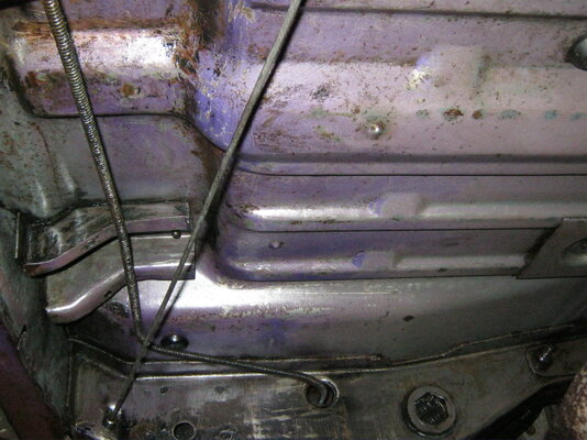

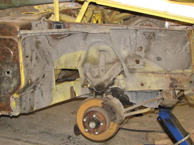

I bought our '70 Cuda new in Sept. 1970 when I had just turned 21. During the last 4 or 5 years I have begun removing the Ziebart undercoat a section at a time each winter and repainting the factory colour. The car was never winter driven, so the Ziebart was a huge mistake. I am sending these photos to show you the original paint under the coating. Sorry I don't remember what factory coating might have been under the Ziebart, but it wasn't much.

Very Little Paint is right. As in they missed huge areas. Under the rear shelf. Inner quarters, often in the cowl and inner (medial) areas of the rockers etc etc. When you restore a MoPar, you are almost always upgrading the paint and corrosion resistance. There is a reason these things went to the junkyard when they were so young, and it wasn't the seats.

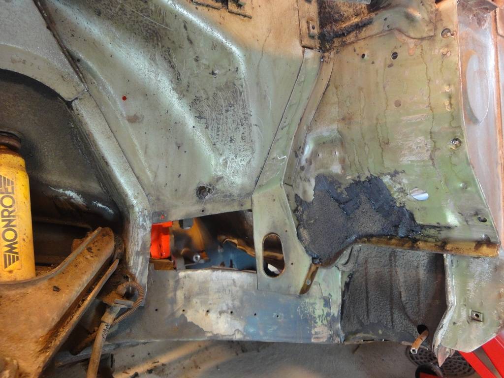

I documented areas that were undercoated on my A66 as I disassembled it.
(non factory undercoated car)
Front wheel well area
Rear wheel well undercoated to frame rail (it was sprayed over the Y1 paint
And floor underside; just some overspray from the car being painted; A Ele115 notes. "very little paint"
I will undercoat the wheel well over the paint in the factory pattern. The wheel well was stripped to bare metal, rust encapsulater used, then epoxy primed (multiple coats), sealer, then sprayed in Y1
